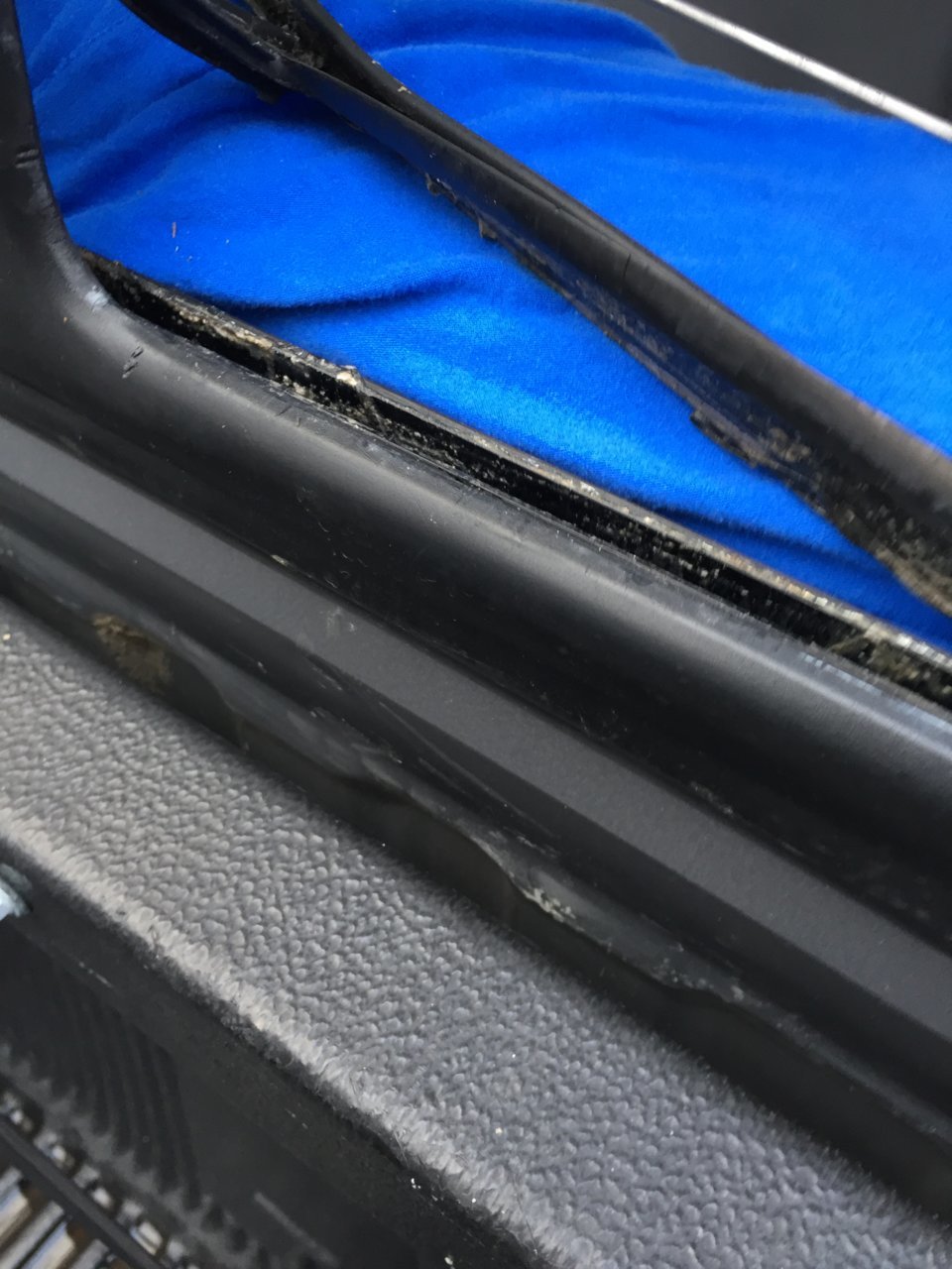

    Sludge build up at the weep holes in the body channel create the leaking that runs down into the corners. Slide your window over and pull up on the rubber to partially remove. Clean it. Pour some hot water in the channel and poke the body holes. Water should exit out of the outside lower window trim frame as that is where the weep holes divert the water.
    Dry everything out as best possible and spray some silicone spray to help keep things clean. Reinsert rubber and you are good to go.

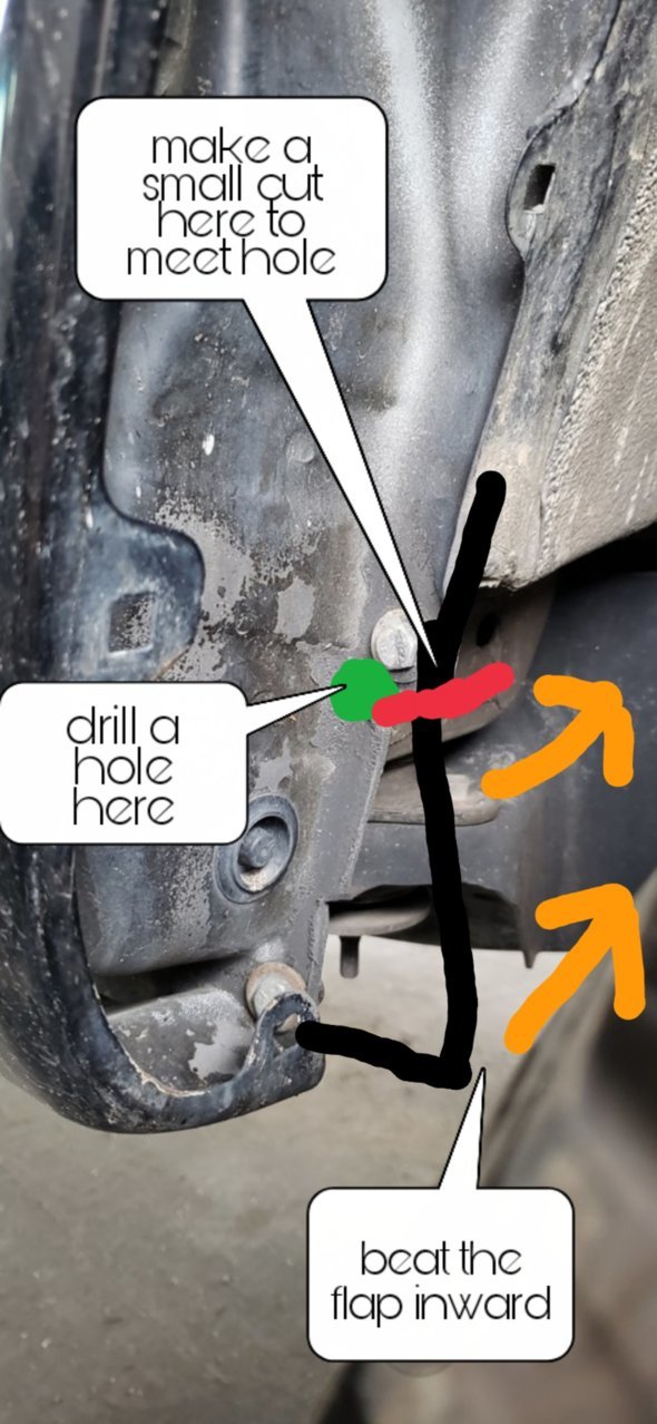

    @FirstGenVol the alignment shop won't do any trimming. An off road shop might, but don't count on it.
    You'll find that aside from a few shops, mostly the vendors here, nobody is familiar enough with our trucks to provide any helpful insight unless its general info.
    Go with what you want. Ad far as trimming goes it isn't as crazy as you think. You have the early front bumper, it doesn't hang as low as to 03^ models so you might not need to trim it at all. The inner fender you pop out at the bottom where your fender meets the door. You'll see the pinch weld there, you have options. Either get a big hammer and beat each side inward towards the frame, or do some cutting, or do both. I would get the tires first and see how it drives before worrying, it won't stop you from driving. You'll only rub when turning and compressing hard, and even then it's no biggie.
    Here is what I would do if I could start over. The black line is where the pinch weld flap would be if I had not cut it out. I added a bolt or two for reinforcement.
    Step one: pull the inner fender away so you have room. Examine the area.
    Step two: drill a hole where the green dot is. I'll explain why later.
    Step three: cut a small incision where the red line is to meet the hole.
    Step four: beat the flap inward, a little tap at a time. Don't go hulkster.
    Step five: button the inner fender back up, use zip ties if you have to. I threw mine away.
    The hole will prevent the sheet metal from tearing further. The circular opening doesn't have a sharp separation point which would be a weak spot. This is a better move than just cutting out, the fold made will retain a grip and save some structural strength. Cutting out like I did doesn't retain anything.

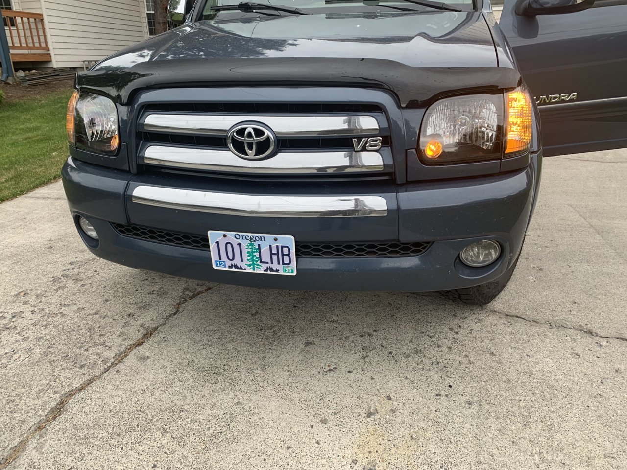

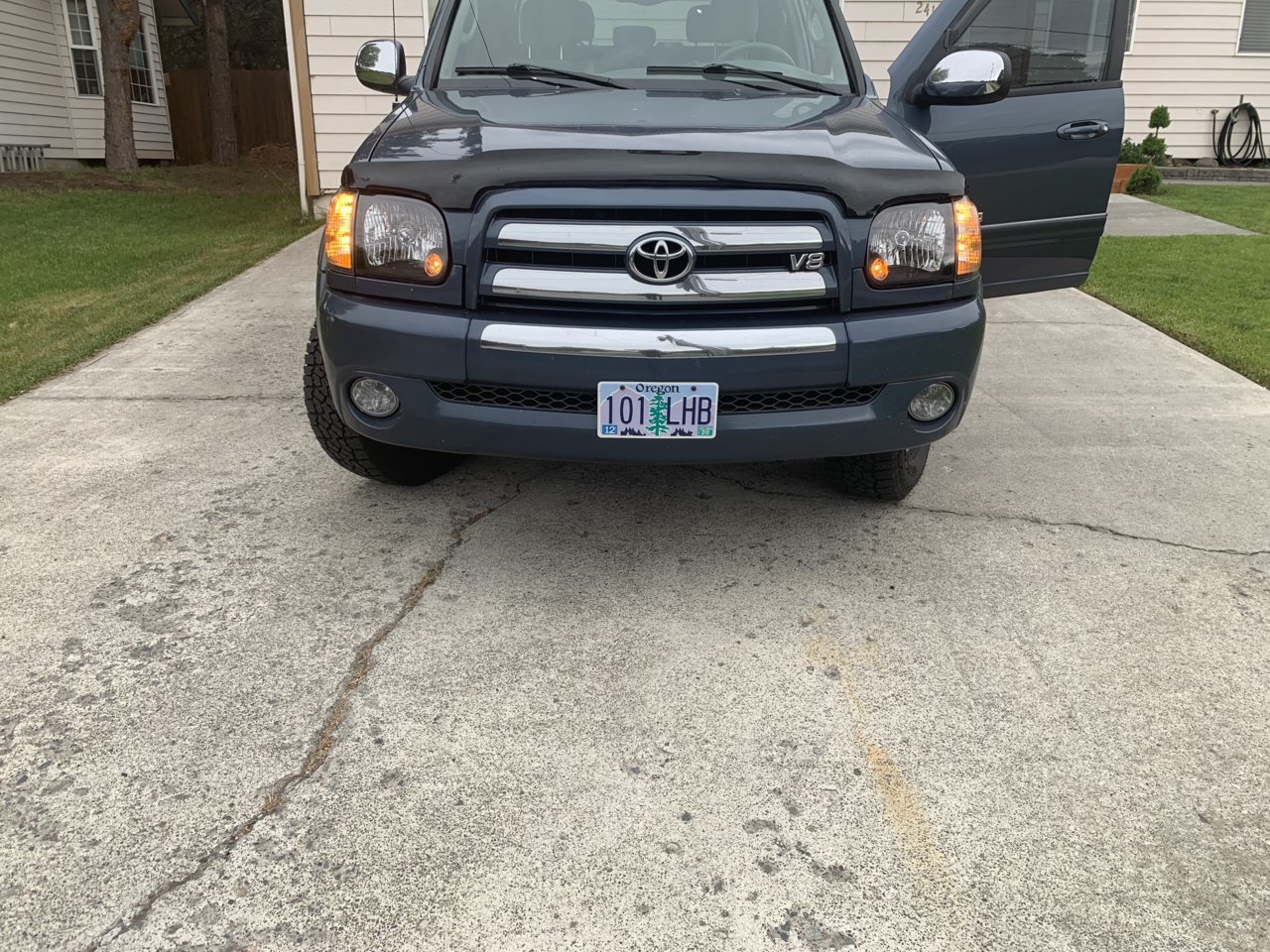

    Got my LED amber DRLs and turn signals in.
    abcinv, georgiey22, Swalters and 5 others like this.

    I had a local TW members trim mine. Do you know anyone that can help or show you how to do it?

    i need to find headlights like that for my reg cab... no one seems to make them with the blackout

    I like the voice box action going on there. Sweet.

    It was actually a 4x4 shop. I picked it because I thought they might be more knowledgeable about aligning a vehicle that's had suspension work done. They charge $90 so I'm not sure how that compares price wise.
    I know some people but they all live in CA. :D I'm gonna drive out and visit Darkness.
    But no, I really don't have anyone here that's into this sort of thing. I'll use his advice on the last page when I go at it.
