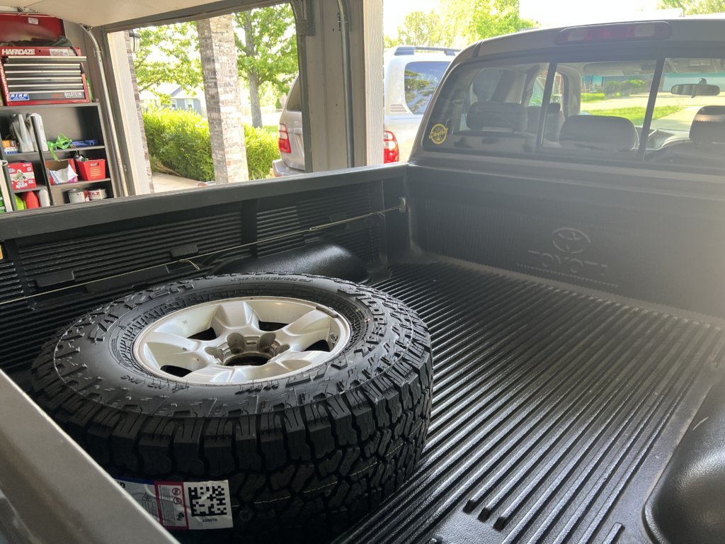

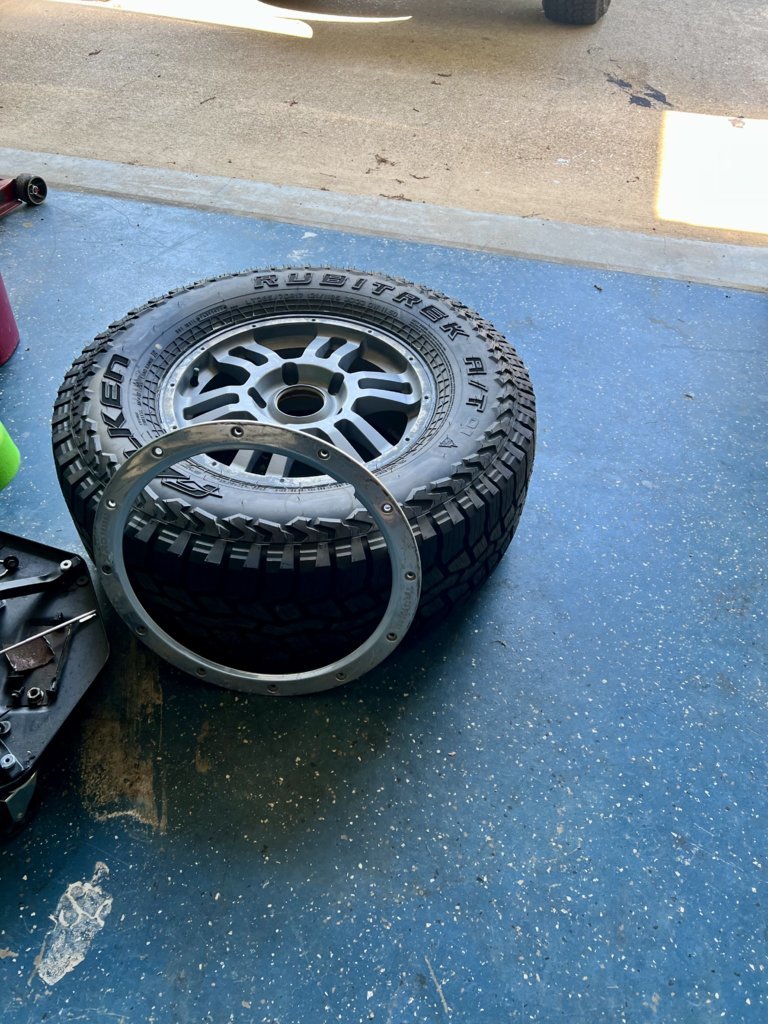

    Still slow going on the Truck. Got some new tires finally, was also able to find a matching wheel for a spare as well. I’ve had good luck with Falken Tires, so decided to try out these AT4s in 265/75/16.
    [​IMG][​IMG]
    While I was going hard at buying tires, I got a spare for our 100 series as well in 285/70/17 Falken Rubitrek. Still need to get some hardware for the Rock Warrior Ring.

    it’s been sitting like that for a year?

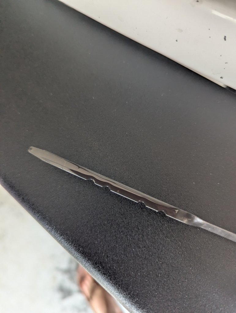

    I just had something odd happen. Put my truck in reverse and let of the brake. It doesn't move. Drop it down to neutral and then back into reverse. Same thing. I then give it a little gas and it slams into reverse at that point. Not good. Got to my destination and it goes into reverse fine.
    Hopefully a freak thing?

    Trans fluid level?

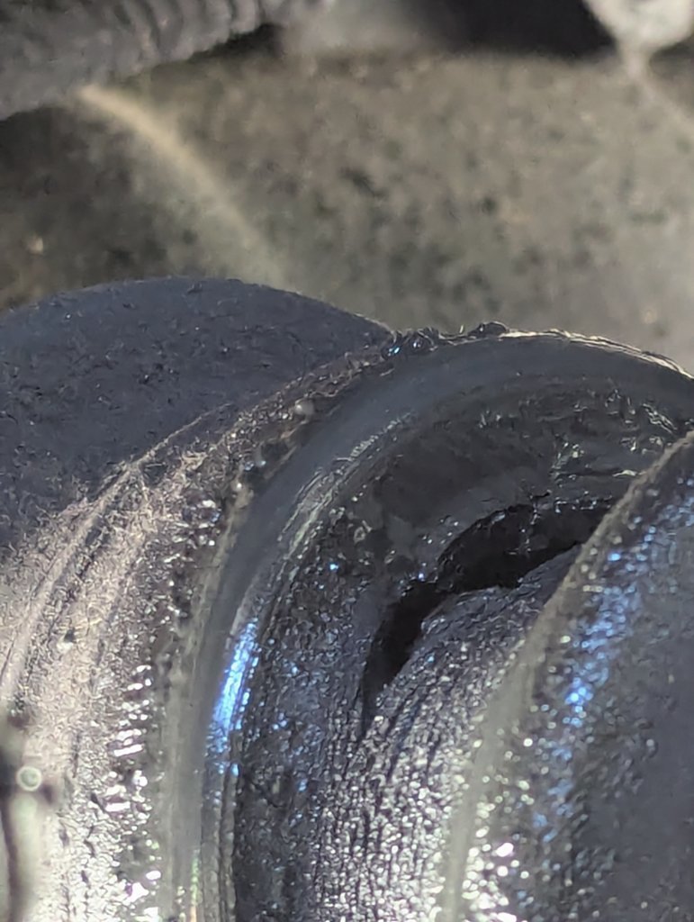

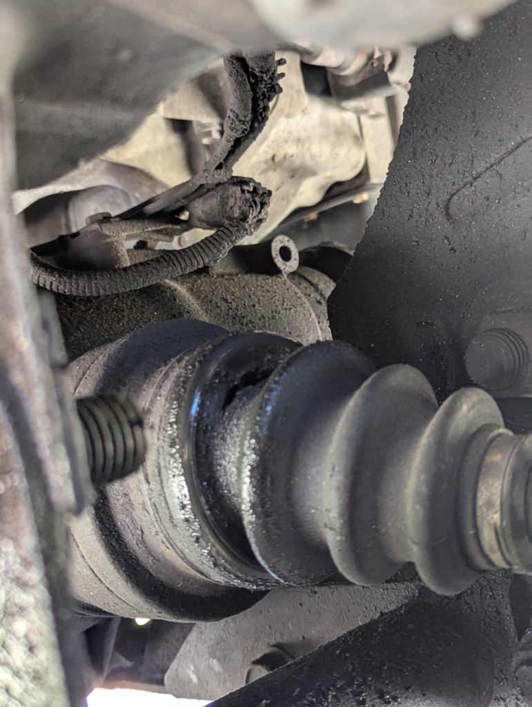

    Is there a what will I be doing to my 1st gen tundra soon thread?
    Found this big ass hole the other day. Thankfully I have a new OEM in a box waiting instead of rebooting again. Guess it's time to order the ECGS bushing too. I don't have severe axle angles but is there a way to slightly stretch the OEM boots without destroying the clamps? Seems they.aleays rub a little on at least 1 rib though I don't think that is the cause.

    Good tip. Looks like fluid levels are good.

    Is that overfilled? Fluid looks a little burnt. Could just be background. I can't remember cuz I don't have a dipstick anymore, but bottom notches cold and top notches are hot?

    Top notches: off, bottom notches:running? Im not a tranny guy, but its bound to drain if the pump isnt running, right?

    Top notches hot bottom notches cold. Always check while running.

    Why is there more fluid in the pan while hot? Expansion? An inch or so of difference is alot.

    Fluid is definitely not burnt. Nice and pink against the napkin when I checked. As for the level, I agree it looks slightly high but this is where it's been for almost 5 years. I did my last transmission service in 2020. 20-25k miles since then. PHM once explained that a dip stick isn't an exact measurement, especially with ATF.
    So I think the level is ok..? If the issue happens again I'll report back.

    Okay. Ya I figured it might have been the background making it look dark. It's certainly not high enough to where it should be causing an issue. Just my initial thought. Hopefully it's a fluke.

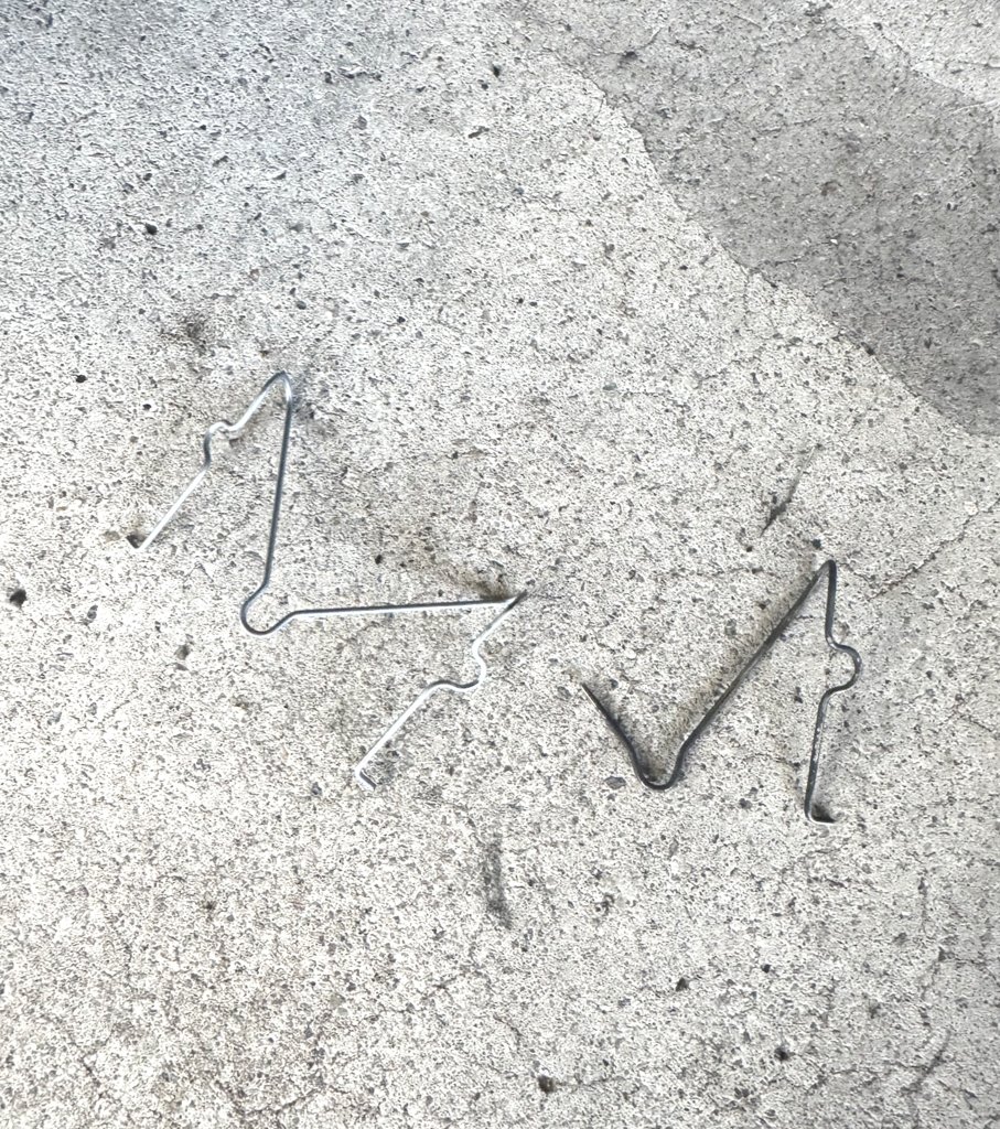

    Still riding that high from the differential fluid fixing the shudder (it feels like new it was so bad!) today I figured out what the front end rattle was. The driver said anti-rattle spring was broken! Local parts shop had a new set for $3, rattle is gone. Took the passenger side off and cleaned/greased it hoping it'd get rid of a slight squeal but it's still there damn.

    Check to see if the dust shields on both front wheels is touching the rotor.

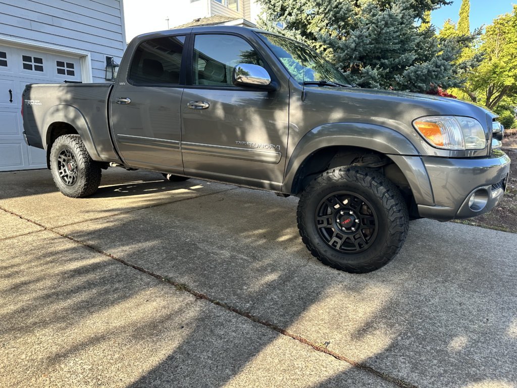

    New wheels and tires! Got a smoking deal on these off a 22 4Runner. Would personally rather have white letters out but next set I guess!

    https://www.tacomaworld.com/threads/boot-slide-mod-no-more-blowing-cv-boots.146070/
    I remember this was popular on first gen tacos, back when I had my prerunners. I've never done it myself though.

    No CEL or pending codes?
    Fluid doesn't look terrible, but definitely could stand a drain n fill soonish.

    And in neutral with parking brake set
