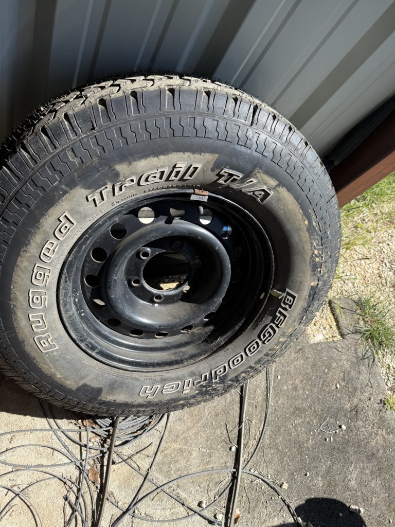

    For my first t2s i got a spare starfish & the cheapest 265/70-16.
    mine still has the tire alignment sticker & nipples.

    I've got that same tire in 1999 vintage. And it still works. So calm down.

    Now that i have a set of 5 spoke steelies, i oughtta line it to be a water tank than mounts in the bed. Put one of those live laugh love vinyl covers on it.
    The hoard says i can bolt it to a titan front wheel bearing & make it a hose reel. Or i get an AI doodad that runs a stepper motor hung weight… kinda reminds me of whatever sorta suspension lexus & bose worked on. Or those gyro’s on boats or buildings.
    i think its gonna be my front bumper. Imagine the fun of a ‘bumper’ on a spindle. Lol.

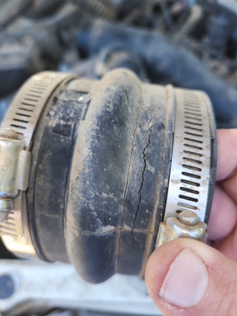

    Replaced MAF and noticed coupler cracks. They don't appear to be all the thru.
    But I guess I need to find another in case. Local auto parts stores didn't have any on thos size.
    Reset CEL, we'll see it it comes back on as rich

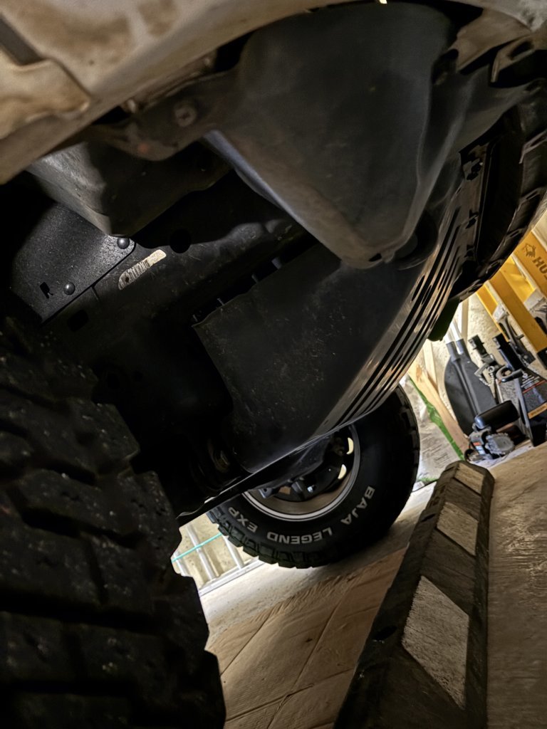

    Reinstalled skid plate for 4hr round trip to north GA and back this week. I’m highly skeptical this will help improve my MPG in the slightest, but it can’t hurt to test. Meanwhile, front/center hole for skid has threads mangled. Tighten it down, it gets snug, then bumps back a thread. Not sure if a simple thread clean out may help, will hafta try next time I pop it off.

    Vato Zone had one, but you had to buy a damn intake tube kit for $22 to get it. But it had the clamps and jump hoses.

    I didn't want to buy the tube.
    They had one the right diameter but about half the length

    Yeah, I was looking for a bit. I'm grateful @PNW15 was willing to share some goods.
    I found what I needed at Summit Racing, but after tax and shipping it was only $2.50 less than the whole shebang at Vato Zone, and once I added in the clips, even if I picked up, it was more.

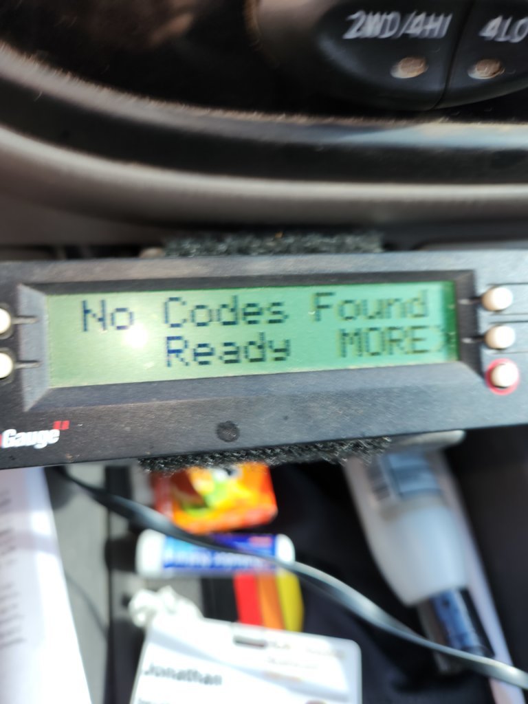

    I'll have to check Advance and Napa next time I have it apart. So far no codes, none pending either. I think the new MAF is doing the trick :fingerscrossed:
    Pretty sure the old one was original at 260k miles. Plus the throttle plate was pretty nasty. Cleaned it with a paper towel and MAF cleaner. Will do the seafoam spray tomorrow when I have a helper to hold throttle at 2k rpm. Might drive the 06 to work tonight just to see if the CEL comes back. I just let her warm up in the driveway for about five mins then drove her to the gym and back earlier.

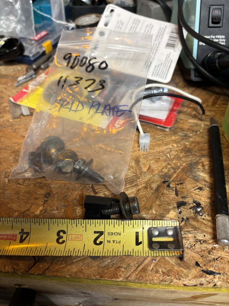

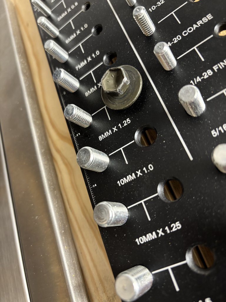

    Whats the bolt size for the skidplate? I tossed mine in a place I couldnt possibly forget...but theres just one problem..

    90080-11373 is the part. It has a self-centering tip.
    You want me to go throw a spare on a thread gauge to get the actual threading?

    Here you go. M8 x 1.25 and approximately 250mm long, with capture washer.

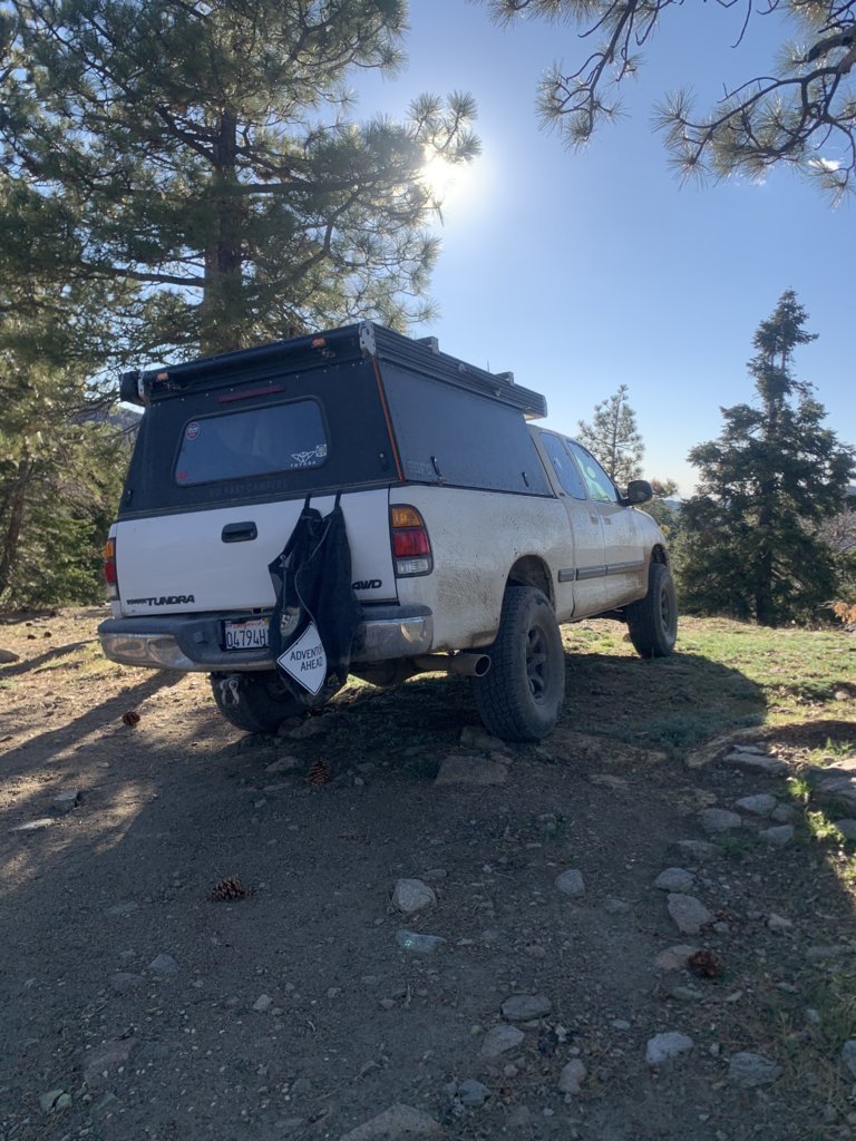

    Took the Tunda out camping in big bear over the weekend for a boys trip. Got a nice mud bath while searching for yellow posts

    Above and beyond! Thank you. I will probably buy new ones but now I know what to look for in my mess of hardware.

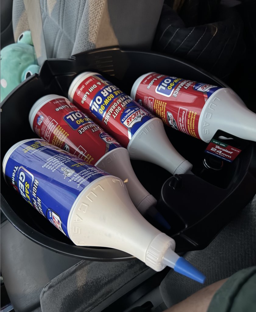

    When I first got the truck I noticed a shudder when turning and accelerating. Took it to a mechanic telling them I thought maybe it was the rear differential. They check it out and say it was bad steering rack bushings and the lower control arms. Someone else said the tires were rubbing. New upper/lower control arms, ball joints, outer tie rods, bushings, and shocks and it was still there.
    Found a thread saying to change the diff fluid and wtf that was it :bananadance: so that's what I did tonight and it's better! In all fairness the front end stuff was worn but not the culprit.

    Yep, sounds like classic diff chatter. You probably have LSD rear, and someone probably installed synthetic fluid.
    People just don't know, or think they know better.

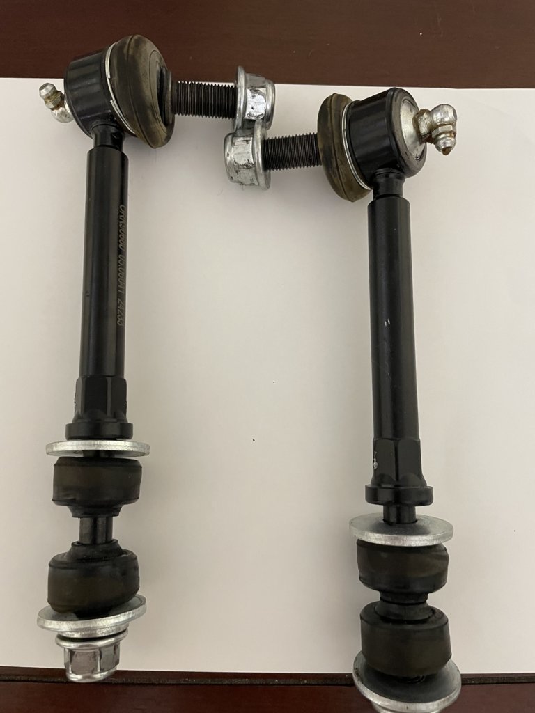

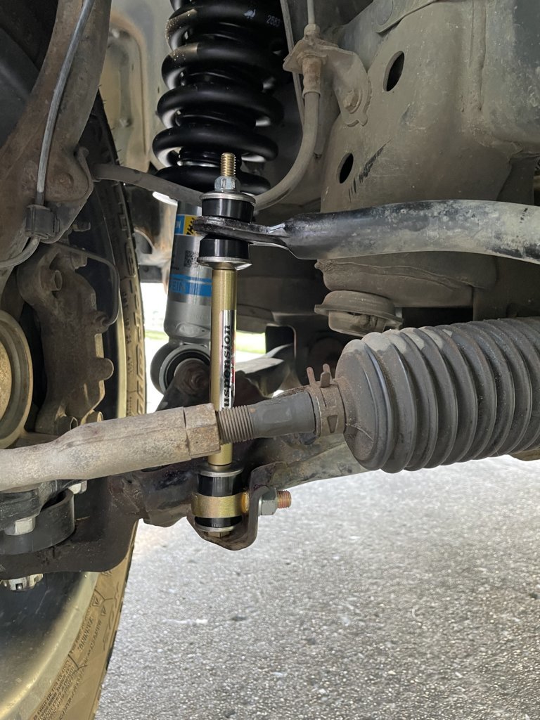

    Sway bar links installed…. I’ll hang on to these old ones just in case.IMG_2182.jpg IMG_2183.jpg

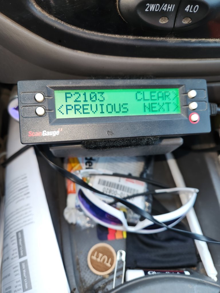

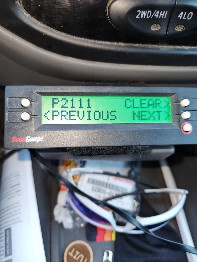

    Omw to work, sitting at a light, the CEL comes back on. Ok! no big deal... I'll address it tomorrow morning or maybe this weekend.
    NOPE!
    Bitch went into limp mode and I was first in line at the light, from one highway to another highway. So I limped her under the overpass, made my turn and pulled into the nearest parking lot. I'm sure the line of cars behind me was pissed I was going 5mph in a 45mph zone.
    I turned her off and on again. She ran fine for 10 seconds then back to limp mode. Tried it again, same thing. Called my supervisor and said I was going to be 20-30 mins late, because I was going to limp her home across town and grab my other Tundra. (I work in the next town over). I deleted the codes and the CEL stayed on, the p2103 didn't want to delete.
    Limped to the same light, on the opposite side of the overpass, turned her off and waited til the light turned green to turn her back on. Bitch wanted to live, now. So I hauled ass to work and was only 5 mins late. I deleted the remaining code and this time the CEL stayed off. At least for now.
    She was running soo good thos morning too. Hell she was running good until that stop light, and seemed to be running fine omw to work, once she got over the limp mode.
    The codes pertained to the throttle control system, so all I can guess is the seafoam treatment made her a little moody. But it's weird it happened when it did and not much sooner.
