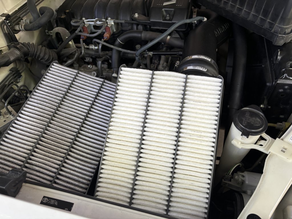

    It's much more of a pain in the ass to change the filter with this new intake tube. But I think the filter was due. New OEM.

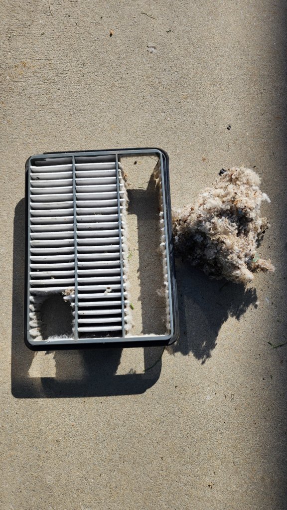

    Just checked mine (thought it had already been changed out during all of this) found another mouse nest. Luckily they didn't touch the filter in the top of the air box.

    Weren't you have some really weird codes recently dealing with air/fuel ratio, like 'too lean' or something?
    You may want to clean your MAF in case some of that got jammed on the sensor.
    If they're in your airbox, they're probably coming in up thru the fender. If I were you I'd put some hardware cloth over the cold air intake hole (google Hardware Cloth if needed), 14 gauge and no larger than ½" opening, any hardware store may have it.
    You'll find that hole they're getting in thru right here: Actually, you may want to pop off the (three?) bolts holding the bottom half of that clamshell on, and install it on the opening that's inside the fender, so they don't have a ledge to stand on and chew thru the hardware cloth. Mice supposedly hate mint also, wonder if lacing that area with mint oil would be a deterrent?

    All good ideas. But these are all old mouse nests from sitting at my dad's house. Not new ones luckily. Like I said, I thought the filter got changed during the oil change but the record does not show it. The element that sits in the top cover above the air filter was completely intact, so I don't think anything made it to the fuel system.
    The only codes I showing are for the passenger side O2 sensors/catalytic converter.

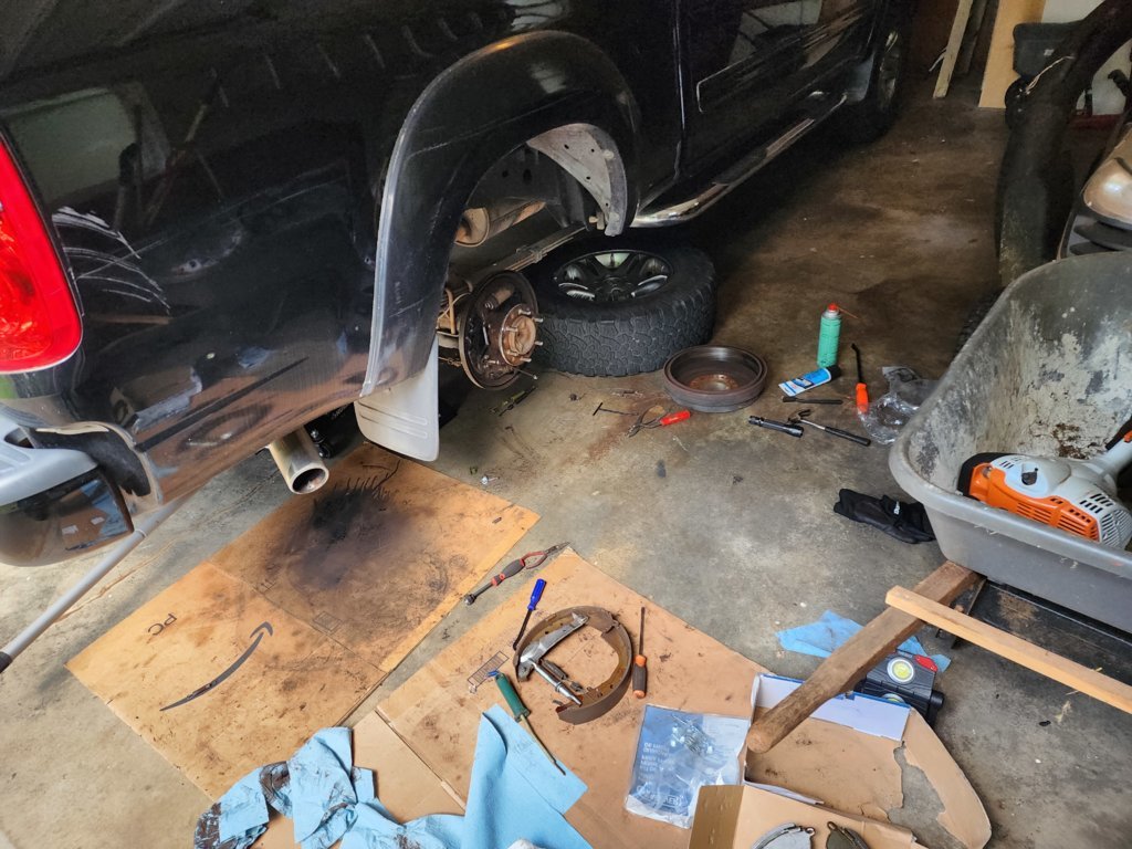

    Stranded until tomorrow when Toyota gets my new brake shoes in.
    I ordered a set of AC Delco's off of rock auto. The driver side fit perfectly. No issues whatsoever. The passenger side shoe was too small for the adjustment cylinder and locking bracket to work properly. I tried readjusting, reinstalling the old springs, taking it apart and doing it again for a few hours with the same results. Did some troubleshooting with Shifty and then reinstalled the hardware on to the old pair and the locking mechanism worked as designed.
    Now I have to finish the passenger side and then redo the driver side tomorrow. The good news is that I'll be able to do this job in my sleep with all of this experience.
    I need a joint lmao.
  28. May 9, 2025 at 12:57 PM
    shifty`
    Jun 20, 2020
    #48239
    31,478
    ATL
    '06 AC Limited V8/4WD
    Got an AC Delco part number on those shoes? I'd like to add that to the Non-OEM Corner of Shame thread. I generally trust Delco for parts quality too, in a pinch. It's almost all I used on my GM vehicles.
    Sorry you reinstalled that side 3x! Should've mentioned to try reinstalling OEM first. I know you said you reinstalled the OEM springs and such, I guess I just assumed...
    Meanwhile, you did grease all (6?) points on the dust shield during install, right? Since you gotta swap new shoes in again anyway, it's worth bringing up. I see the lube in your pic.

    Part number is ACDELCO 17764B
    I did go ahead and grease up the contact points.
    I thought it was user error for the first few times. Thinking that I did something wrong on the reinstall. Reinstalling the original was the last stand lol.
