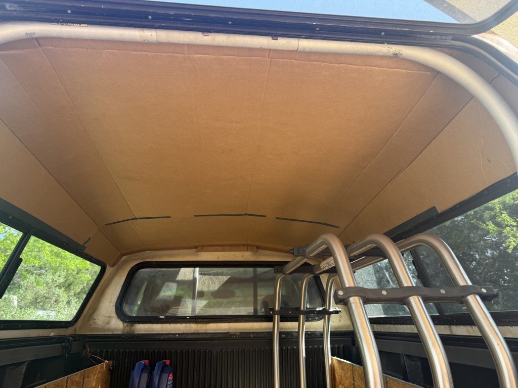

    Couldnt fit my ceiling with the foam, so just bubblewrap & cardboard for now.
    Now to figure out curtains.

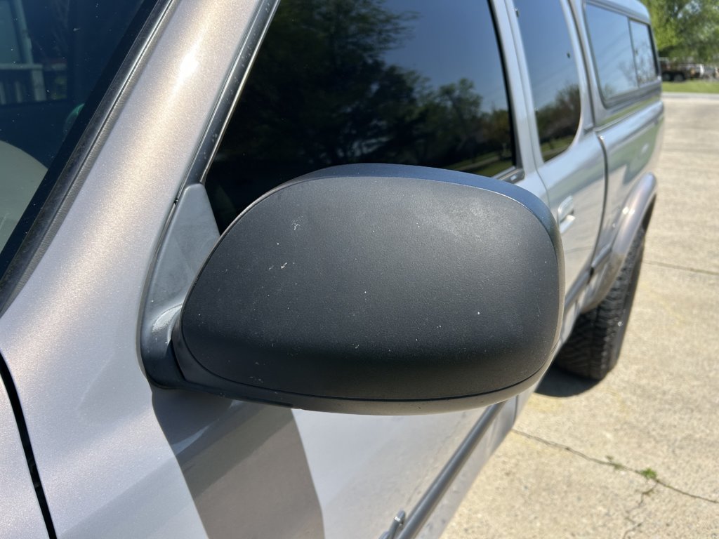

    front bumper is a replacement that was finished in black, but I need to refinish it. Back bumper was chrome, got scuffed, etching primed and bedlinered. Mirror caps were factory body color painted (limited) but faded and got wrapped, that faded, then wrap removed, scuffed, primed and bedlinered. Same for side trim. All the badging got plastidipped.

    @des2mtn has some tricks for curtains

    Wrap is a temporary fix with future pain. Just gonna get it painted.

    Nice, I'm definitely planning on bedlining mirror caps and side trim at the least

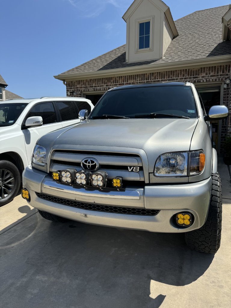

    Washed it. Tried the H4 headlight harness with the colight projectors. Not a huge difference if I’m going to be honest. New CAPA cert headlight housings went in. Just waiting on the clear corner lights. I’ll probably hang onto the black housings and colight just in case I don’t love this rabbit hole I’m going down. lol.

    Paint > wrap every single time.

    I did these in 2019. So 6 years later they look like this. A little fade, but not much chipping really.

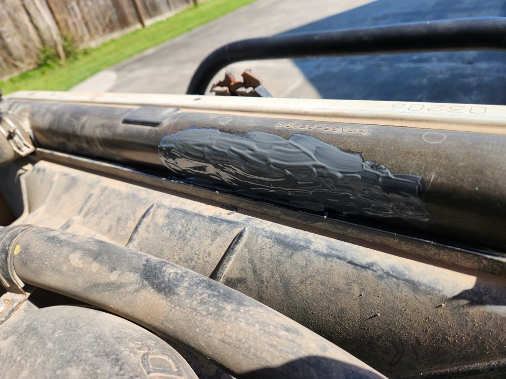

    My new Denso radiator is supposed to arrive sometime tomorrow.

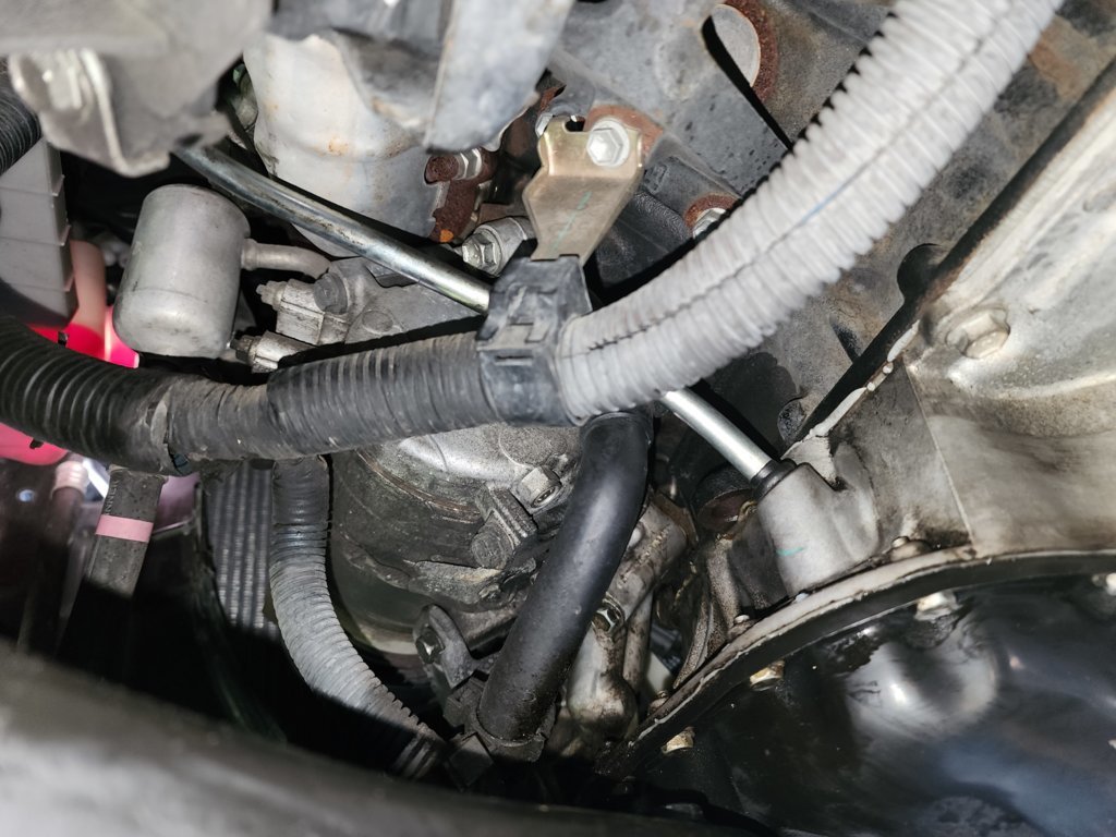

    Finished the airbags.
    I didn't think about the plastic over the bumper...but this'll work.

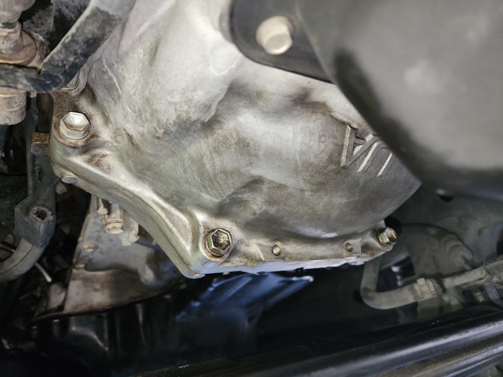

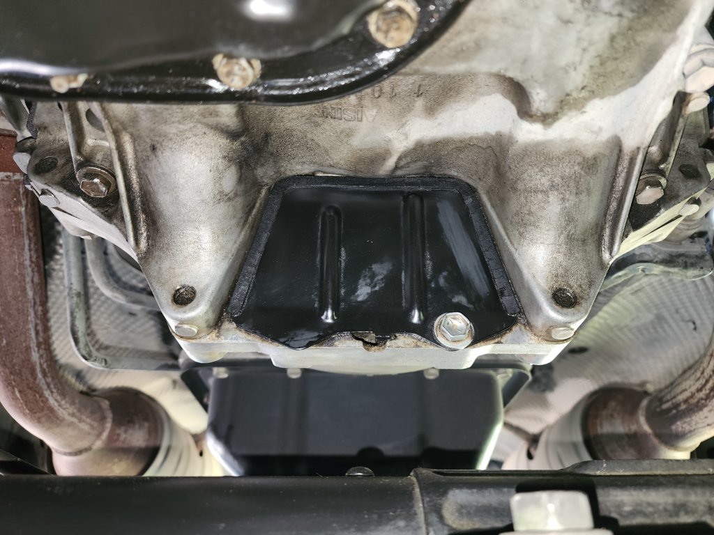

    And I almost forgot I had done this while I was in temporary self-exile. I could not get the damn front diff drain plug out. Took it to a friend's who welds, figuring we'd weld a nut onto it. But this tool was all it took.
    Installed this while I was there. I love the concept, but I don't love how far it hangs down. Hopefully it's never an issue.

    Interesting. Funny how it’s usual the first year of a new model that has a problem, not this where it’s better than the rest… at least for the LBJs haha
    Used JB weld on a radiator leak before and never thought about it again… works well sometimes :anonymous:
    Oooo nice. I was just over at a Joann’s looking at fabric options. Thinking I might use a little wood rod and some Velcro for curtains

    I JB Welded it before lunch today.
    The new unit comes in sometime tomorrow, so we postponed our wrenching plans til next week. Apart from putting off crucial mods for T2S, it's actually going to be better for both us of to wait.

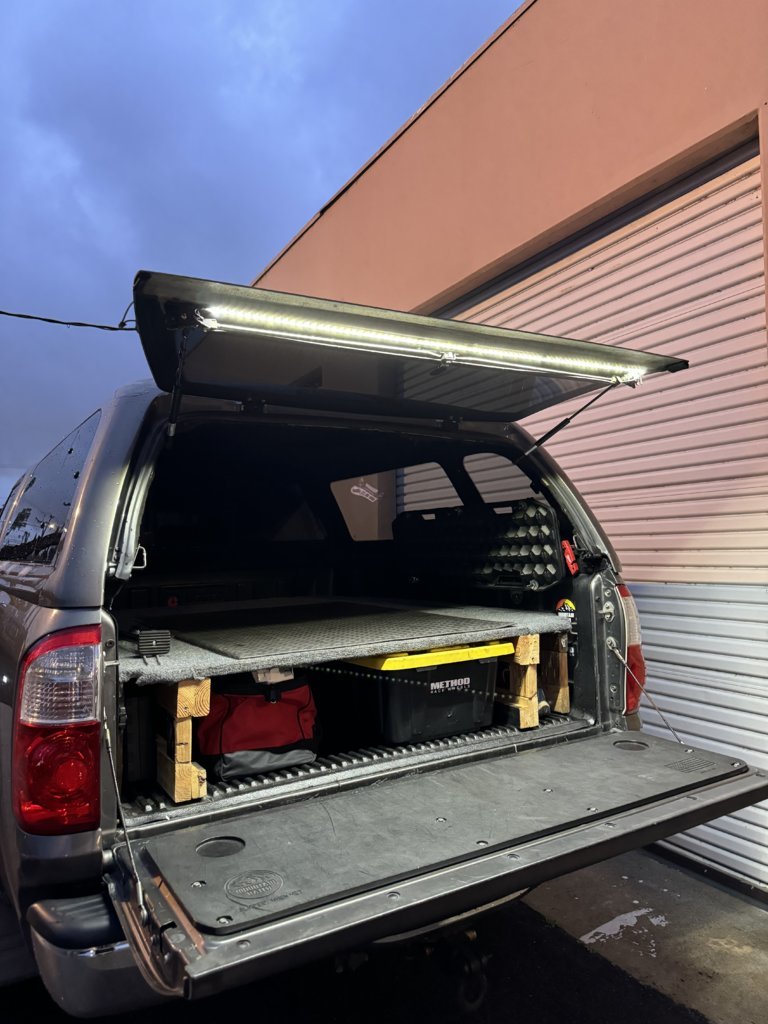

    I bought the same lights, cut them to size and glued them to the lip on my back window using E6000.IMG_5778.jpg

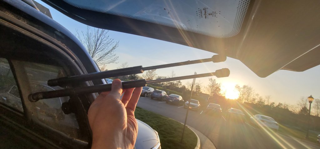

    Replaced the struts on the shell. Is it ok that the news ones are a couple inches shorter?

    If you're happy with how it works, then it's fine.

    As long as you’re happy with how high your backglass extends then you’ll be good.

    I'm kinda pissed I went with heavier-duty ones. I've banged up my back window's lower aluminum panel because I failed to catch it a couple of times now, and it smacked into the garage door. It opens pretty violently. I think I'd prefer going several pounds less force, and about an inch shorter.

    Have you tried only using one strut?
    I got too heavy duty of struts too, so I kept one worn out one and replaced the other. It still has plenty of power.
    Iirc I got 38lbs and I should've gotten 30lbs. I definitely feel like mine should've been an inch shorter as well.

    I dunno if my OCD would allow me to do that.
    But yeah, similar story. I got the 35lb and I think I should've gotten the 28.
