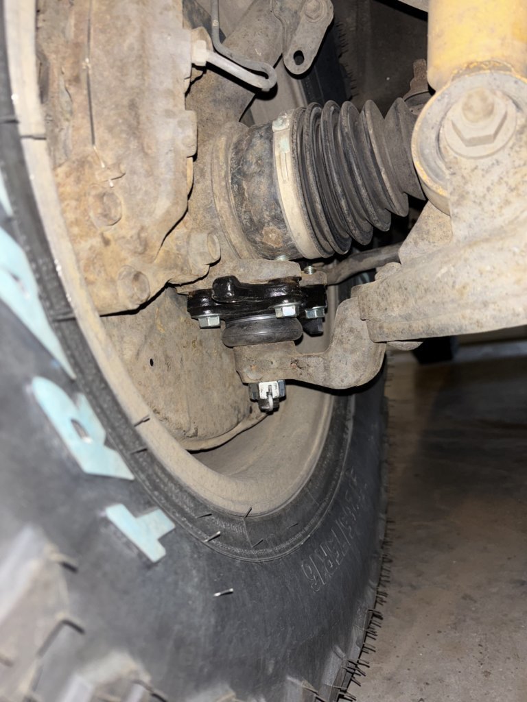

    Well I would say 25 years of service for original ball joints is pretty solid. Took a sharp corner at 60 with a quad in the back a few weeks ago and got a bad feeling so figured it was time.

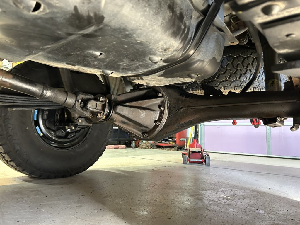

    Could it be the pinion angle? As in, proper alignment of all the various u joints? Tons of talk of this on Tacoma world, and seems to rarely be carrier drop that helps.

    I've posted this before and I'll post it again. Just like mine, it's because it's a 2000 and had the one off good ball joints. The 2000 was never affected by the recall. That's why mine went 23 years and 205k before I decided to change them.

    I check them every year for play with a pry bar and never had any play whatsoever but at this point it’s cheap insurance with the roads I’ve been on this spring.

    By no means was I implying that the 2000 LBJs are good for that long, but you and I are proof that the 2000s went longer than any other.

    Could be. Carrier drop addresses transmission out put, carrier bearing and pinion all at the same time. But if it’s dramatically off at the pinion, then I should address it there. Doesn’t look bad though.

    Just curious how many miles did you put on yours? I had no awareness of this issue until I joined the forum a year and a half ago so I didn't change my 06 until 18 years and 302,000 plus.

    305k

    Addressing all the angles at once might miss the mark. You might not need to change anything from the carrier bearing forward, since your transmission output and carrier bearing height are already and still coordinated. If you just focus on things related to what you have recently changed you might find that your pinion angle is not ideal (parallel) to your... Middle working angle? My two piece driveshaft geometry is definitely rusty... Not sure my eyecrometer is calibrated enough to tell from da photo but we may be talking about just a few degrees?
