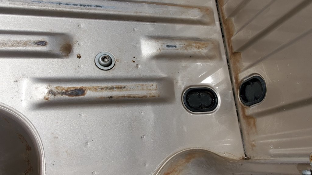

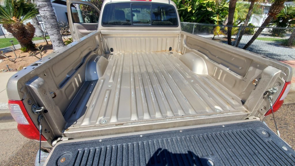

    @whodatschrome, per your info, I popped the bedliner out today and backed the 6 bed bolts out as prep for bed removal of re-paint.
    Heres before/after pics of liner removal. [from previous 18 yrs in someones Modesto, Ca driveway].

    VERY VERY nice! Those bolts should come out lickety split. I’d definitely use a 1/2” impact wrench to zip them out. If you use a wench or breaker bar, i could see the torx head easily deforming and stripping out (just saying from prior experiences).

    U are f'n A-right about an impact tool!
    I stepped up thru tools after pbblaster bath from top & bottom.
    1. old Dewalt cordless 18v impact [bolts laffed at it], then
    2. an IngersollRand 3/8 drive air-rachet [no go], then
    3. a couple square hits w/framing hammer followed by 1/2" drive IngersollRand impact. It took all that 1/2"drive had; theoretically 600-1200 ft lbs of torque. Never even considered wrenching them tho.
    I guess using anti-seize isnt a manufacturer convention.

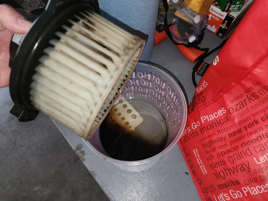

    I took the blower motor out again and hosed the cage in degreaser to sit overnight.
    It's amazing just how much filth was on this thing.

    The before and after. What a difference.

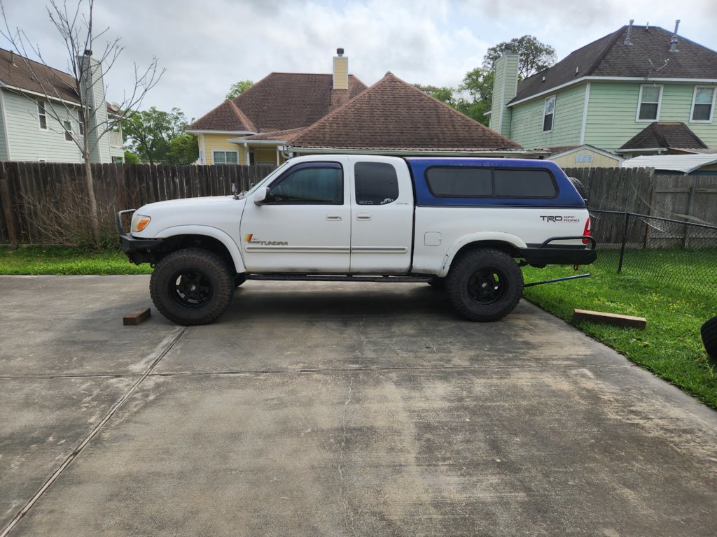

    Test fit Kenda Klever RT 35x10.5R17

    Why is she squatting?

    Looks like she’s shitting a floor jack. Them 35s look good tho! How’s the clearance on the front when steering? I’m guessing the rear just needs some catch up after your latest front end work.

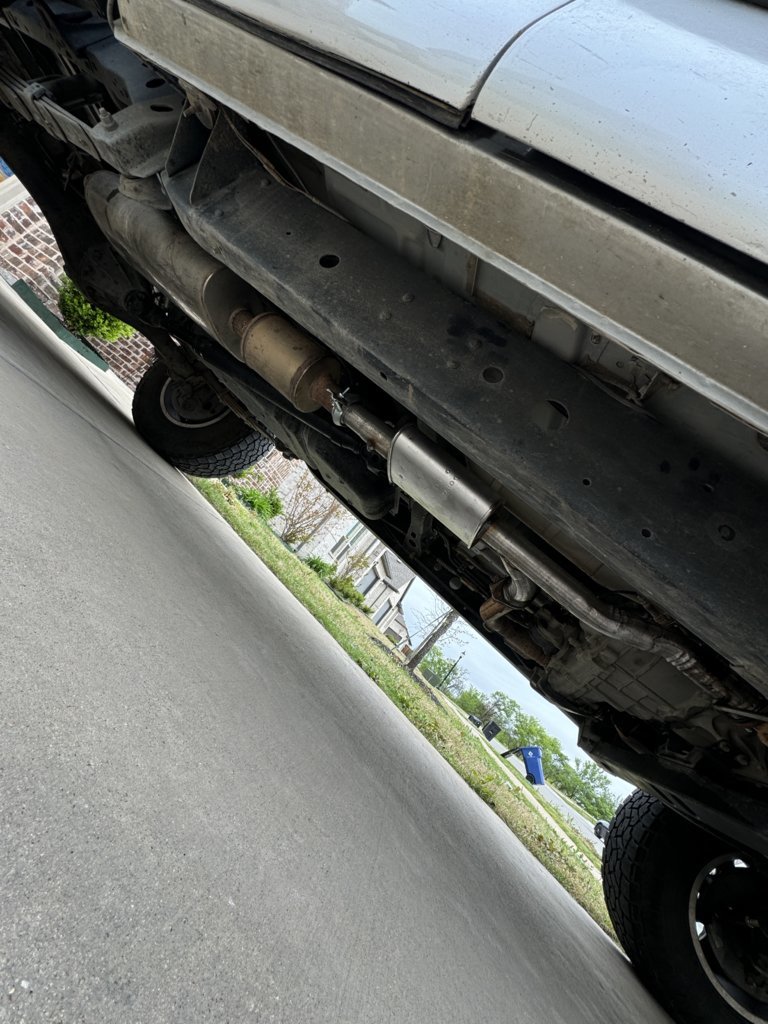

    Need to bring it to an exhaust shop to get some tips welded on it so I don’t cook the rear shock. New mid pipe (mine didn’t have the resonator and was welded) and TRD muffler section. Still debating on using the TRD tips or just letting them go to someone who would want them.
    I’m still getting some drone, but chalking that to the deeper and more refined tone and the fact that it’s just echoing under the bed. Very pleased!

    I feel like I get a lot of resonance and bounce back with the exhaust dumped after the axle, I’d like to get some removable pipes/tips to dump at the bumper

    Mine has always been dumped before the axle except when I bought it. Straight fence post out the back. God awful drive home haha

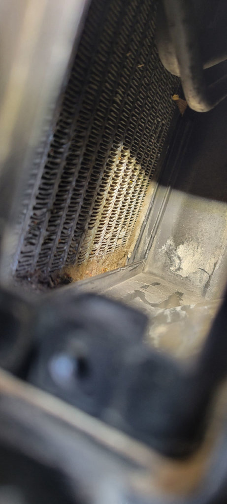

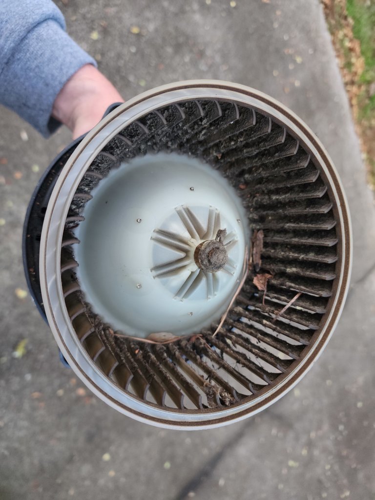

    Iron oxide weight reduction
    X3
    Perfectly clean blower
    Some corrosion on resistor, wire brushed and treated
    Very minimal debris, didn't go hard on it, no sense in breaking it.
    Hose reducer perfect size got it good enough.
