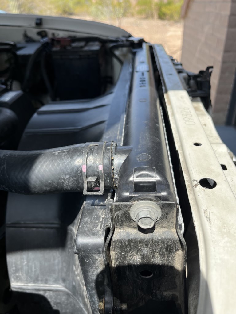

    Removed the old cracked radiator and replaced with new denso unit. FYI y’all, seems that all fgt denso radiators are equipped for at, if manual transmission just don’t hook up trans lines. Tried everything to get v6 manual radiator, but they come with the fittings installed, I just left the end covers on. I bought a coolant system tool to vac fill the system, works so much better than a funnel, plus if system holds vacuum then unlikely to leak. Happy Sunday everyone

    Also reuse the radiator brackets that come from factory, connect radiator to vehicle. Super easy

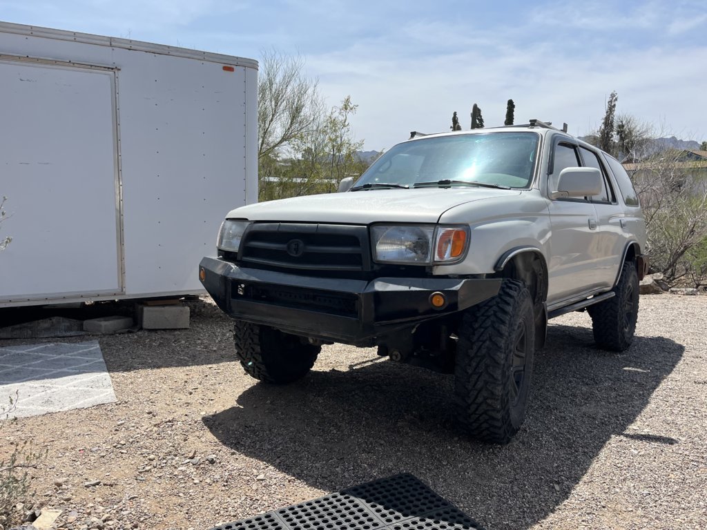

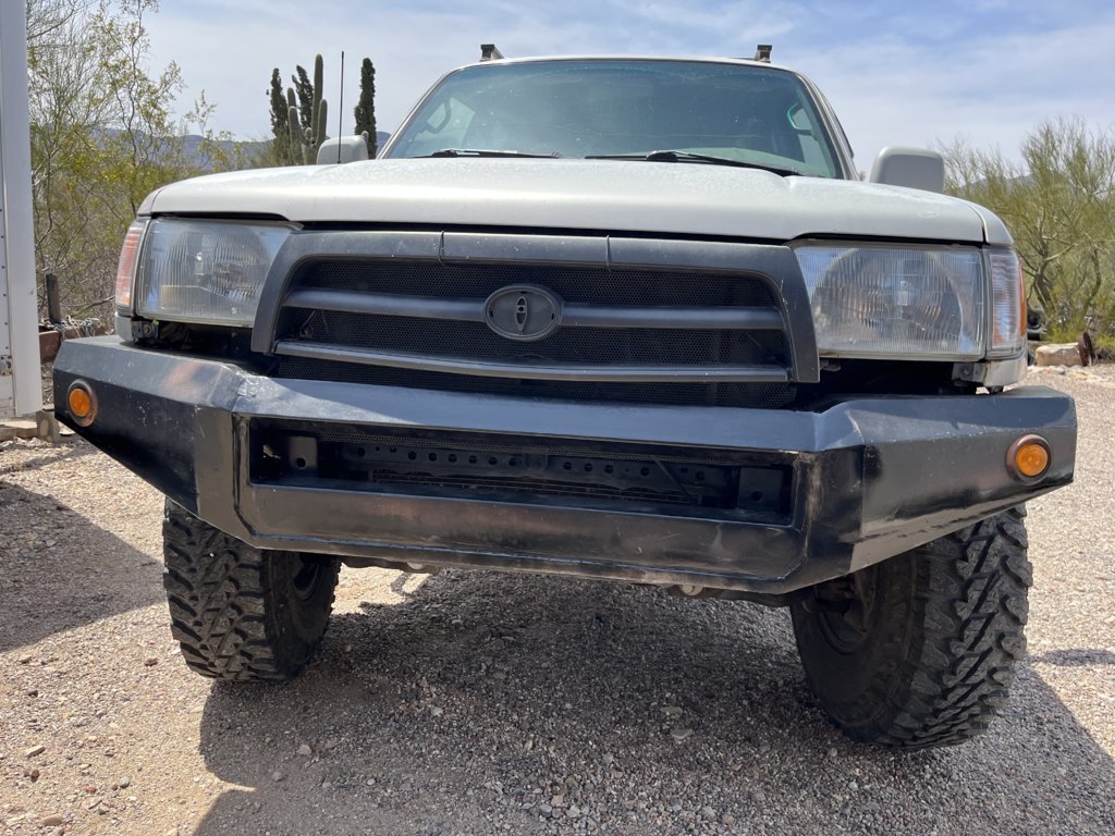

    After the radiator, got the bumper I built mounted to the 4runner. It’ll come off many times still before powder coating. The camera makes it look goofier than it may be.

    Awesome dude, I love it. Super resourceful. That right there is a repair I'd honestly pay for.

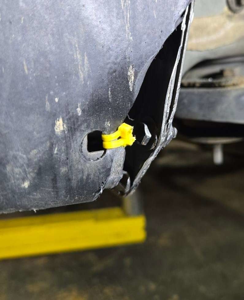

    1. Fedex update: Coastal bumpers at the local FedEx center.
    2. All 4 of my transmission to cross member bolts were not tight. Snugged them up...most remaining vibrations went away. Who knew???
    3. Chop chop no rub....yellow for flair.

    Like you, found swapping on the original mounting brackets to the new radiator aligns the bolt holes on the front apron. Have done this with Denso and other. Didn't you have to mod the rad mount to connect the bracket though?

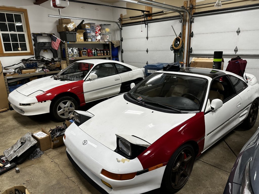

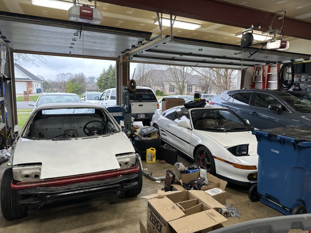

    Made it home. Trucks zero issues… and now the mr2 has been partially assembled up front… I have twins now IMG_6209.jpg IMG_6219.jpg

    I remember the shock towers were a little rough on the other; how are they on the new TX MR?
    Given the lacking interior, I'd be really tempted to roll cage the new roller.

    No, the brackets that came on the denso didn’t allow the fasteners to line up for mounting. Removed the denso brackets and installed the factory brackets, then all the holes for fasteners aligned and everything worked perfectly from there. Just 4 bolts, no mods.

    I work on it when I have parts. That one’s just constantly a waiting game because everything’s custom

    The roller is getting a full interior and done up pretty when the other parts car is here
