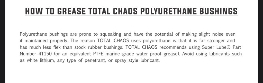

    Looks like im getting a second grease gun and a tube of that grease. Couldnt hurt to have 2 types of grease on hand though

    Yep. Problem I've found (and maybe others have a solution for this?) is you can't go back & forth. Can't remove one grease tube, half-full, and put in the other just for the poly-bushing lube. So it's two grease guns for 2 types of grease.

    I have 2 cause it’s way easier than changing out the grease tubes

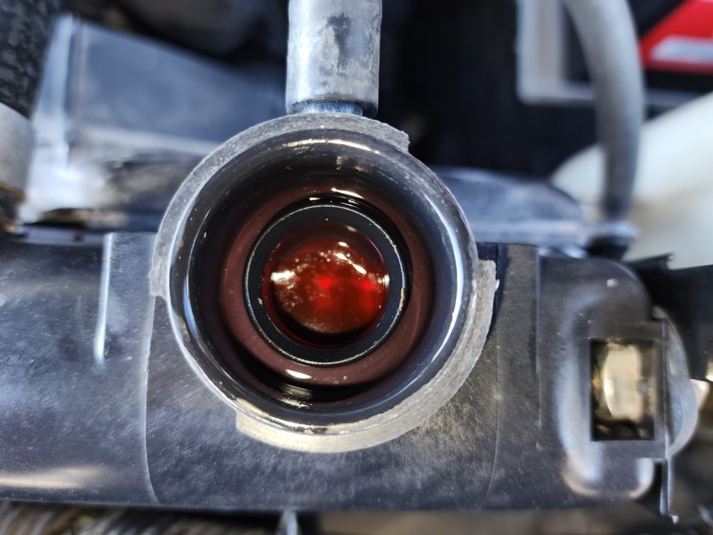

    Guys, my radiator fluid isn’t supposed to look like this right? Should be clean, see through no? Looks rusty and murky IMG_0609.jpg

    What does the fluid in the overflow look like?

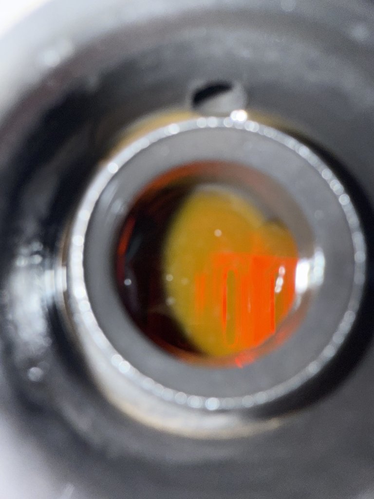

    Here's mine for reference.
    It was just filled yesterday.

    Thats a bit murky, but i wouldnt call it milky. Using a knockoff fluid?
    i’ve been using peak asian red & it’s got a yellow tinge, but its clear. Been sitting for 3-4 days by now.

    I haven’t changed it since the days a mechanic worked on my truck which was years ago. Not sure what fluid he used.
    How often should it be replaced?

    Timewise, I'm not sure. But the coolant does become acidic / corrosive over time. If it's been a while then I'd probably suggest going ahead and doing a coolant flush.

    Every 4 years? 5 years? I’m honestly not sure.
    As far as I’m aware, having the correct coolant type, which you likely do, is probably more important.

    IIRC Toyota makes red (long life) and pink (super long life) that can both be used, with red as OEM per the manual.
