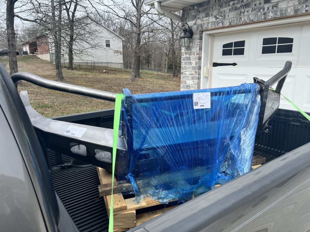

    Saw a post earlier in the month that Billy at Brute Force Fab had some bumpers in the shelf ready to ship. Definitely not a need, but went ahead a scored one. Full hoop option is what I settled on, I kinda dig it! Bumper made it from NorCal all the way to the Middle of Nowhere Missouri. Picked it up today from the freight house. Don’t know how long it’s gonna sit, but looking forward to getting on the truck whenever that is. Hopefully I can find a powder coat color match to mate up nice with the Phantom Gray Pearl, if not good old matte black is always on standby. Hope everyone is doing well, have an awesome weekend.

    Sweet bumper. Looks heavy AF! Go satin, not matte.

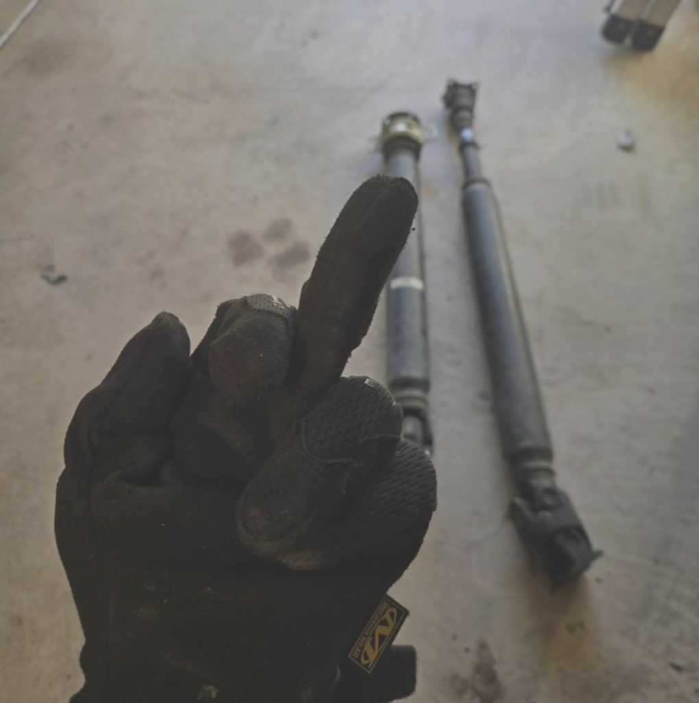

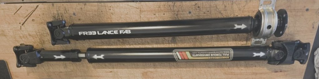

    Also installed the Fr33lance door stop reinforcements and a new door check in the back drivers door.
    Driveshaft in. Not eto self, next time, if solo again, do it in 2 pieces, vs all in one long ass unit.

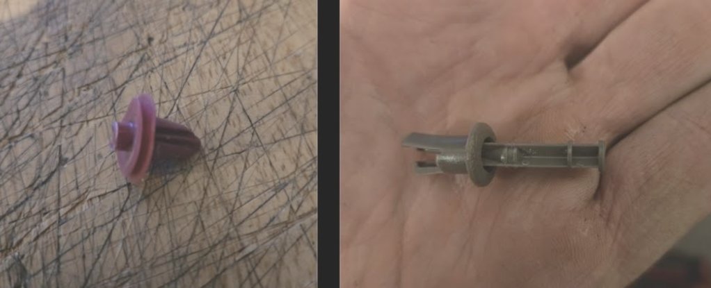

    Fine....found em: 67603A on the left and 07066 on the right....although there are a few numbers for the ones on the left and I otrdered a 50 pack from Amazon...should work.

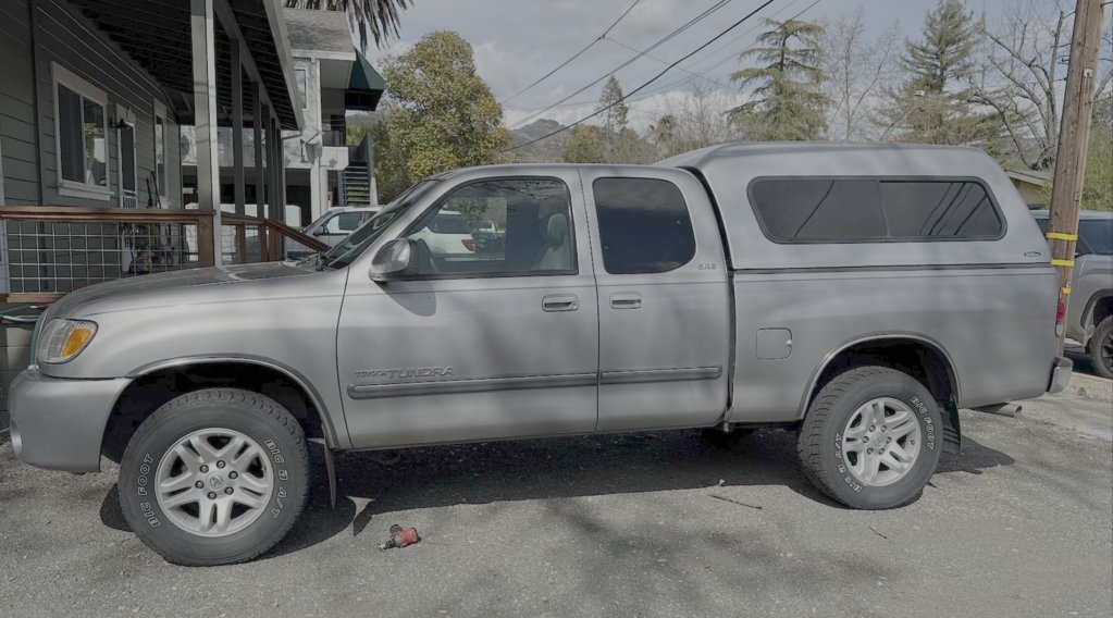

    I removed the Summit Racing step bars that came on the truck. Looks so much better already..
    Before
    After
    Edit: why do my pics look so blown out after I copy and paste them?

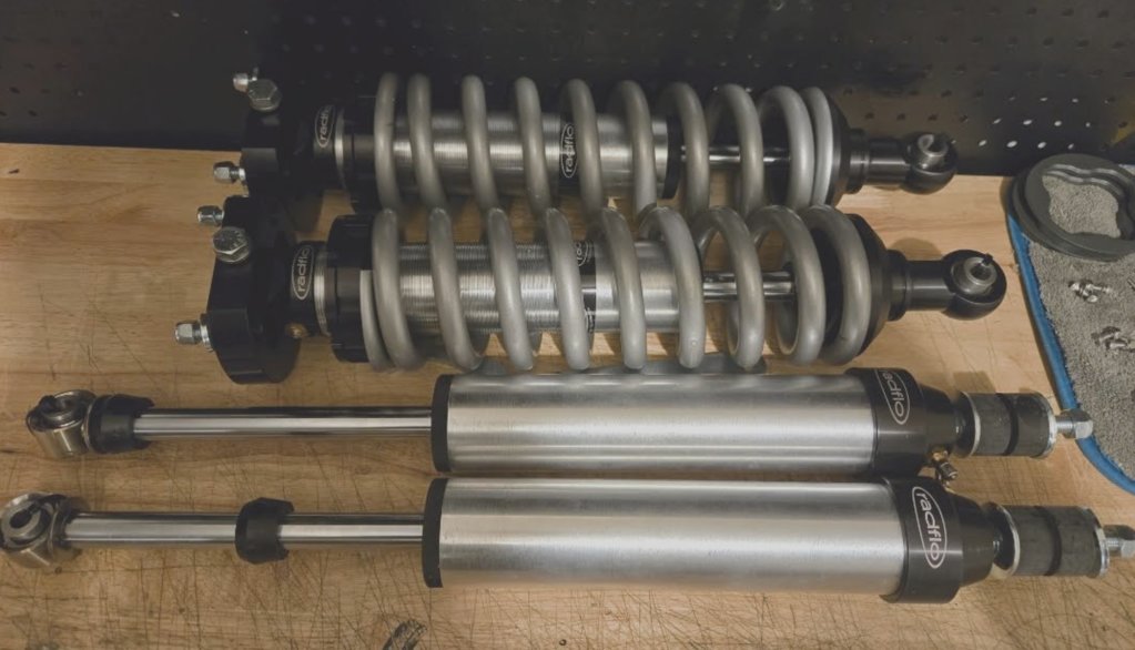

    Driver Front: Pulled needle bearing and installed ECGS bushing. Installed new axle seal and fresh reman OEM axle. Installed Radflo 2.5 coilover and broke bumpstop bolt. Will drill and tap next week - 45 min
    Passenger Front: Installed axle seal and fresh reman OEM axle. Installed Radflo 2.5 coilover and Durobump - 30 min
    Drivers Rear: Installed Archive MD leaf pack, u-bolt flip kit with #3 bumpstops and Radflo 2.5 shock - 30 min
    Passenger Rear: Installed Archive MD leaf pack, u-bolt flip kit with #3 bumpstops and Radflo 2.5 shock - 2.5hrs
    Front bushing and sleeve seized. Ended up having to chop the leaf pack and work on it for a while, trying to not break the hanger. Finally got it out. Nice big burr had the sleeve hanging up. What a pain in the ass.....but...it is what it is. Took a few breaks here and there to cerakote and reassemble some tools. Lighting sucks, one set is grey and the other set dark green.
    I still need to add some preload to the front tomorrow. Wanted to get a few miles on her. will also re-torque all the bolts. I have to say, with the new coilovers, new Fulltorque driveshaft, needle bearing swap out and AT drain/fill......she drives and shift so smooth. I did pull the front mud flaps because...rub a dub dub. I'll do a bit of trimming tomorrow. I'm at 21" front and 23" rear. Eric said the rears should settle just a bit. I don't mind a little rake, as I tow as well.
    If anyone is in the VA area, the Icons are free. Fronts will need a rebuild. Rear shocks are fine and I have a spare as well. The aftermarket CVs are trash. Old wheels and tires will be cleaned up and put for sale soon.

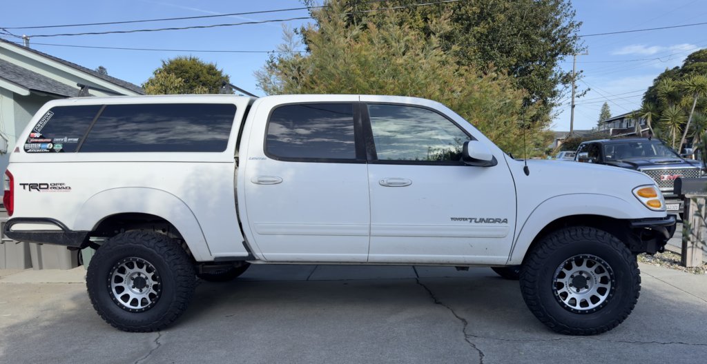

    Side profile with the 285/75s. I am really liking this tire size, lost a little pep in its step but that’s ok it was never a race car. Time to get the the big hammer out

    Those springs are pretty stout, I think mine only settled maybe a 1/4” to 1/2” max. I was at 24” after install, will measure tomorrow out of curiosity. You’re going to love them. Had about 250lbs in the bed the other day plus me and my buddy were sitting on the tailgate and it barely budged.
    Update: 23.5” hub to fender. 11.25” axle to frame
