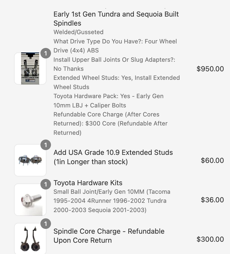

    Oh...and I received the gusseted spindles that I can't use....ugh.

    They are for the early, small LBJ year Tundras....2000 - 2003 I think. I just had a brain fart when I ordered them. Already placed the order for the correct ones. Gonna bathe in the dollars spent on shipping ....FML. Lesson learned.

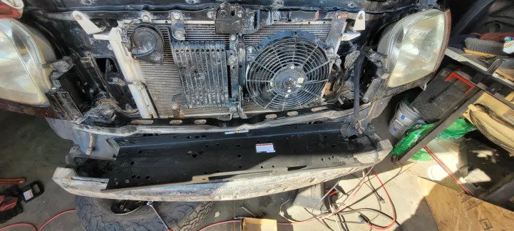

    Pretending to make progress... Still not sold on whether it's going to work or not since my truck is a little different than Mamba's, but going to trim the ears on the frame horns this weekend. Should know then.

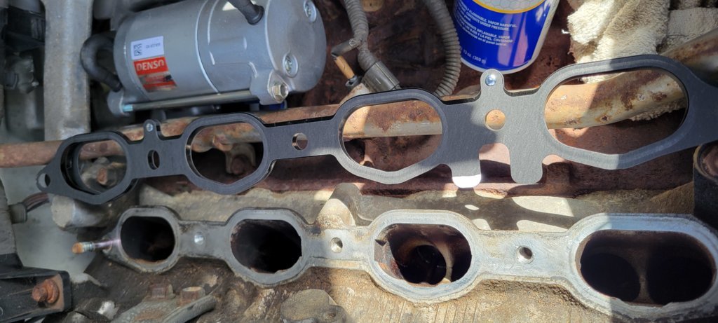

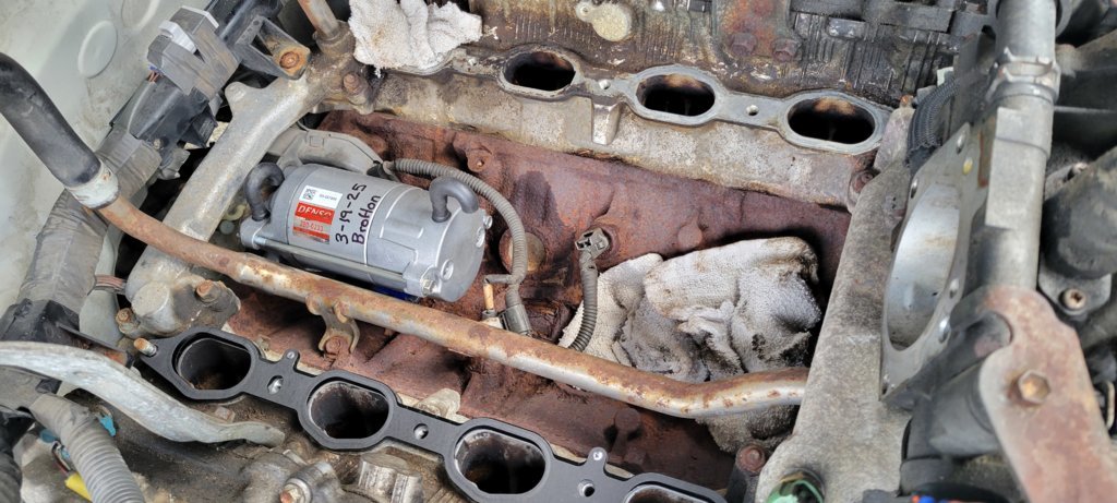

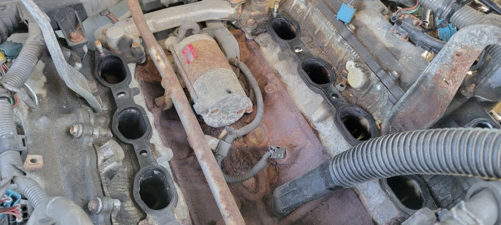

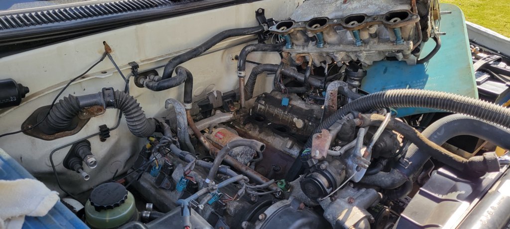

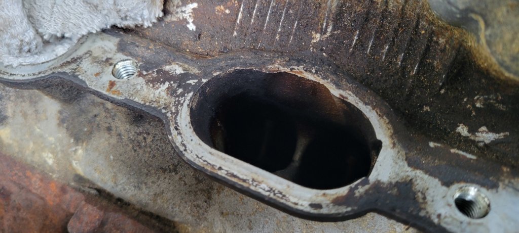

    Update: Idle relearned, still sitting around 900 o_O, but she starts like buttah compared to before. I could smell those new OEM gaskets burning in, prob should revisit the 13ftlb torque setting soon.
    I have yet to clamp off the brake booster line, or the PS booster line to see if either of those are a vac leak.

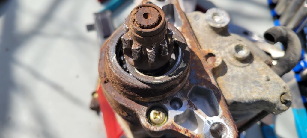

    I forgot to mention what the flywheel looked like considering the condition of the starter... I looked as soon as it sunk in and there was minimal damage, dodged a serious bullet there :rolleyes:
    Best trick I learned during this was to use a 3/16 wide piece of gorilla tape over the lip of my socket to hold the 12mm bolts/nuts for the manifold in the socket while fishing them down in.
    Wobble extension helped for the rear nuts as well.

    Your little edit is funny to me because some of the differences 100% have to do with cooling... No trans cooler, no A/C fan, no power steering "cooler", AC drier separate from condenser...

    I used my needle nose to hold them from the top and drop them in, then to hold them from the side. Those rear nuts suck, especially when you're lifted. I just knelt on the rad support and one hand on the firewall.

    Yes, which is why (for science) you’ll have to document everything. Your fan, I believe, will be the biggest hurdle. I know that the winch mount must sit flush against the rad support for it to clear the bumper.

    Yeah, It took a bunch of strange unnatural positions to hover over the area for me. Glad there are no photos of it.

    Fired up the BlueDriver, went live data (RPM) and proceeded to clamp off the brake booster, then PS vac lines. No change, still 900-890 Idle.
    I'm not trippin on it, just curious if it was something simple. Retorqued/checked all the manifold nuts and bolts.
    My honeymoon with this truck still isn't over. Standing there listening to her 297k engine just purrrrrr so nicely made me smile. ;)
