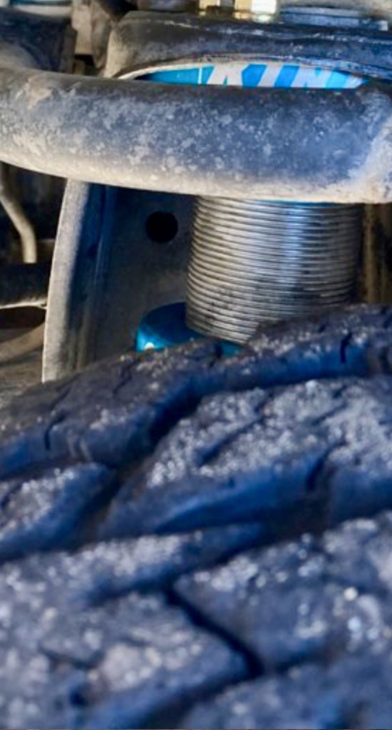

    The SoAz….. big surprise
    Bone stock
    I counted close to 18 and 16 exposed threads

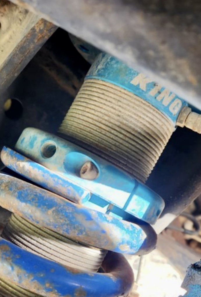

    Could be also because mines AC and Mo's is Ridgeline.

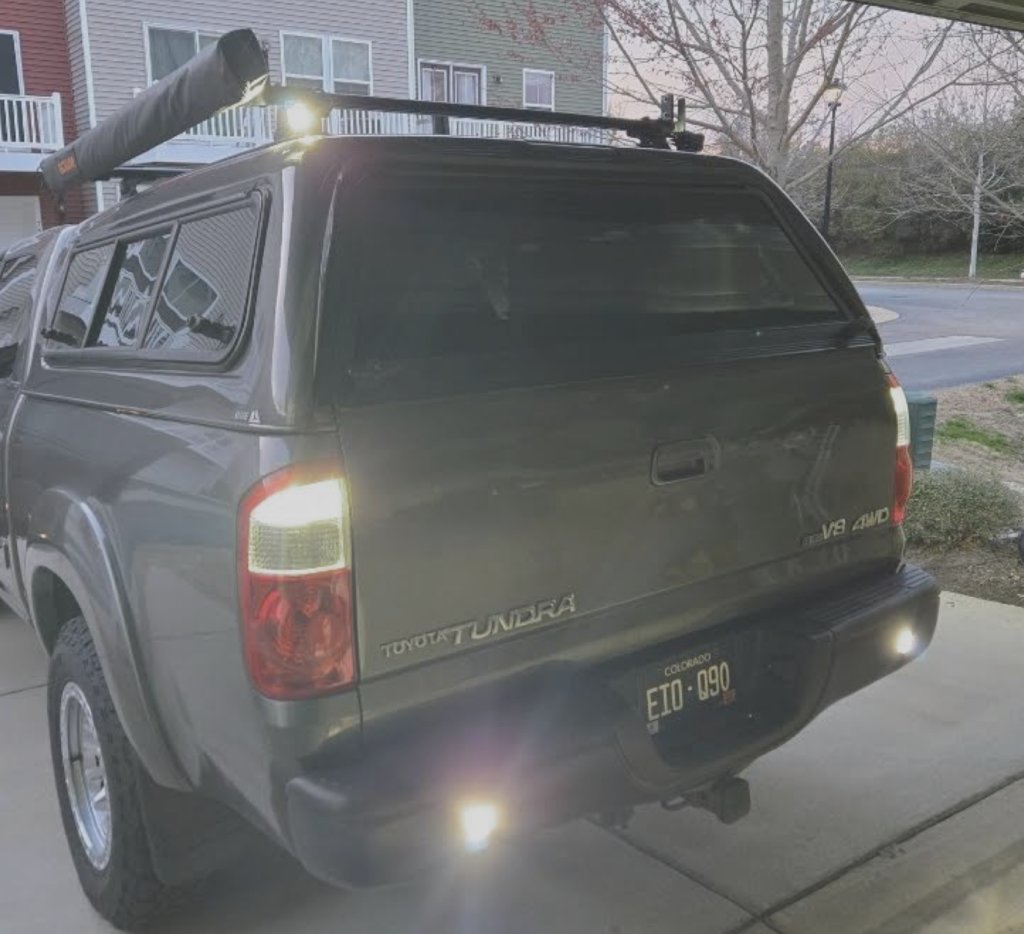

    No...more....12v...please.....ugh. Hooked up my left and right side camp lights, the Diode Dynamic SS2s. The rear bumper lights are SS2 Flush Mounts. They turn on when in reverse and on a separate circuit through the Auxbeam switches (reverse lights turn on as well). When my running lights are on, they have a red backlight. I'll have to cut holes in my Coastal rear bumper, once that comes. The front Coastal (full headlight hoop) will get 2 amber pods, 2 white pods and the big ass ARB Solis 21s (1 spot 1 fog combo). Hopefully they'll both ship soon. I hate 12v.

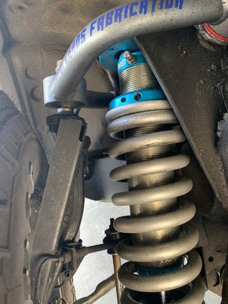

    im still wigging out though. Here’s another members DC with kings
    Don’t know what is what anymore

    Are my eyes deceiving me or are your springs not king blue…

    You’ve been deceived…..

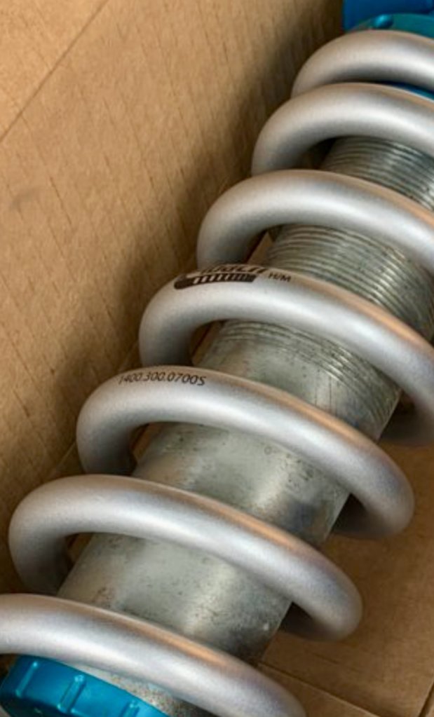

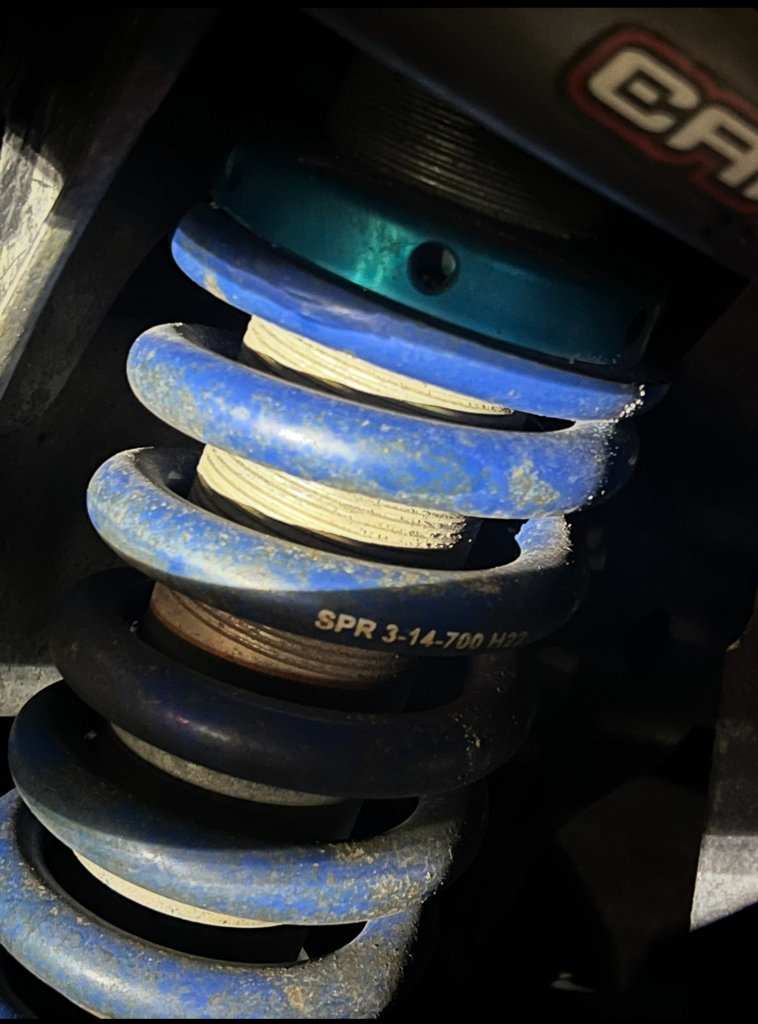

    I think it's interesting seeing all the people with Eibach springs on their Kings. I just have whatever length the extended travel Kings with 700lb coils came with. Seems to work fine enough. Plus I like blue.

    I think most kings come with a 650# spring

    You get the option but 650 is what was recommended when I got mine. Had to upgrade when I knew better

    That makes sense, I see a majority running the 650# and those that have upgraded usually have the silver eibach springs

    Yeah you pick between OEM or extended travel and 650 or 700 pound coils when you order em.
