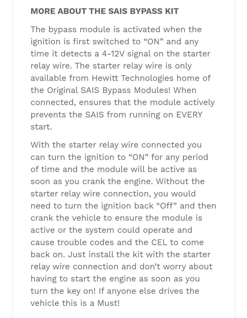

    My understanding is that it powers the bypass so that the the SAIS will never activate even when power is turned to accessory and there is a delayed start to the motor. I thought I could skip it but then I heard the SAIS blower recently. I don't recall if I did anything unusual on that start.
    Here is the explanation from Hewitt Tech:
    https://hewitt-tech.com/product/secondary-air-injection-system-bypass-kit-gen-1-v36h/

    Ahh ok. So this is to bypass having to replace the part. Its to correct the issue easier when there is a loud "whine/whistle" when the vehicle is first started.

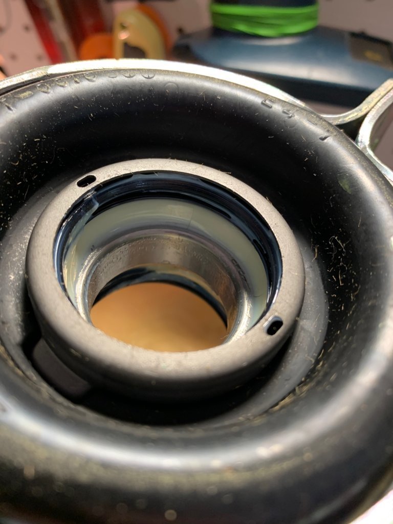

    The difference is whether or not it has the “seal” for the 4wd model or unsealed for 2wd models. Otherwise they seem to be the same bearing.

    That's what I heard too, I couldn't tell you what that seal looks like. I know I ran the 2wd one on my 4x4 before. I don't know which one I have on it now. But I got a spare somewhere.

    This white insert, this is the seal

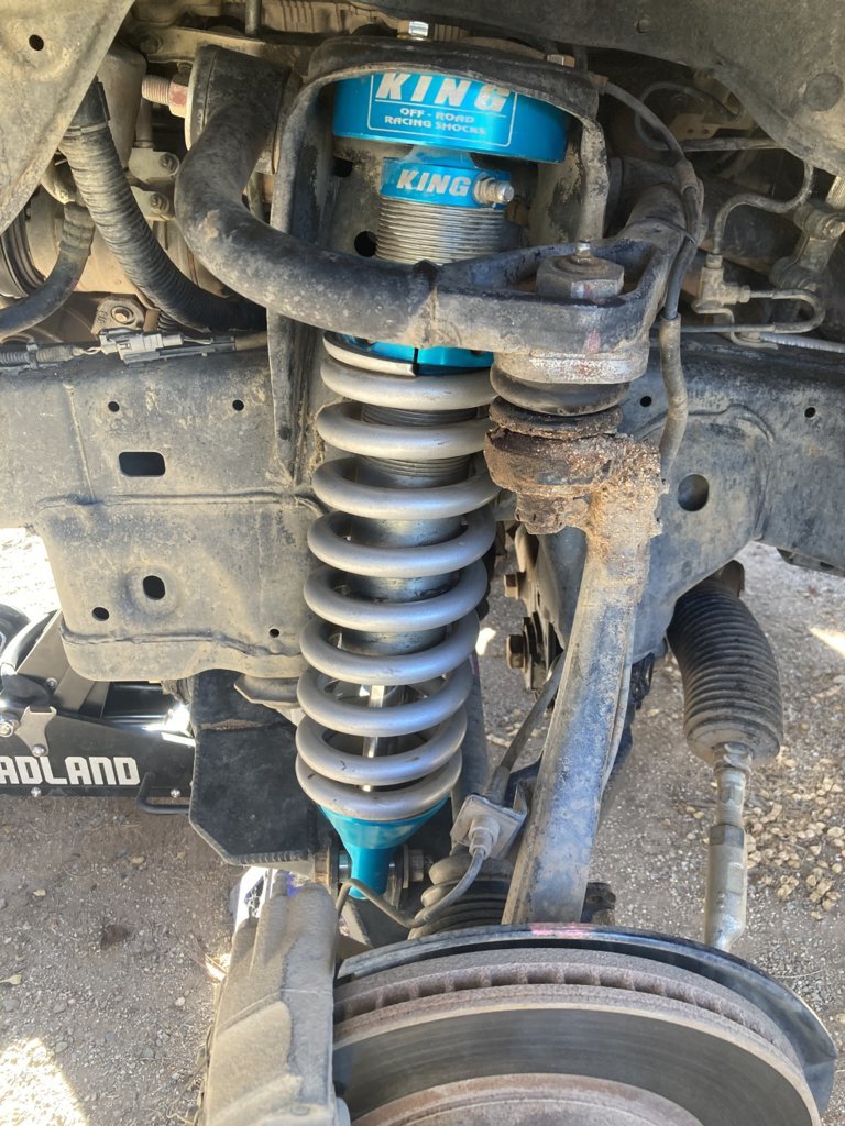

    I finally got a round tuit.
    It was surprisingly easy to swap out shocks, I think having new lower bushings made this job a breeze
    IMG_7368.jpgPrevious UCA angle

    Did you get your Kings rebuilt or go to a heavier spring rate? Both?
    I just noticed the Billies. I guess those were temporary.
    Ooh you welded in the new tabs too. I bought em just in case (because Black Friday), but don't think I'll use em. Once I get it dialed in, I might have Frank tac weld the plates in place.
    I see you have the fronts slightly out. How's the rears look?
    I plan to leave my fronts down (neutral) and set the rears all the way out this weekend. Right now my fronts and rears are all neutral, because I didn't know what to set em at. We just followed Timmy the tool man. But I don't think he always knows what's best. KPO told me to do neutral front, all the way out rear, for max caster.
    Edit I just realized you also have the SPC UCAs... We're gonna be twinsies. :D
    Do you recall what setting you have your SPC caster to? Looks like G maybe? Mine are at F now and I was considering going to G.

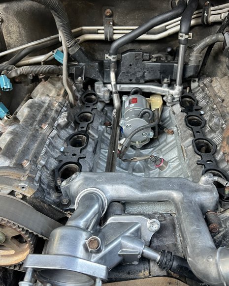

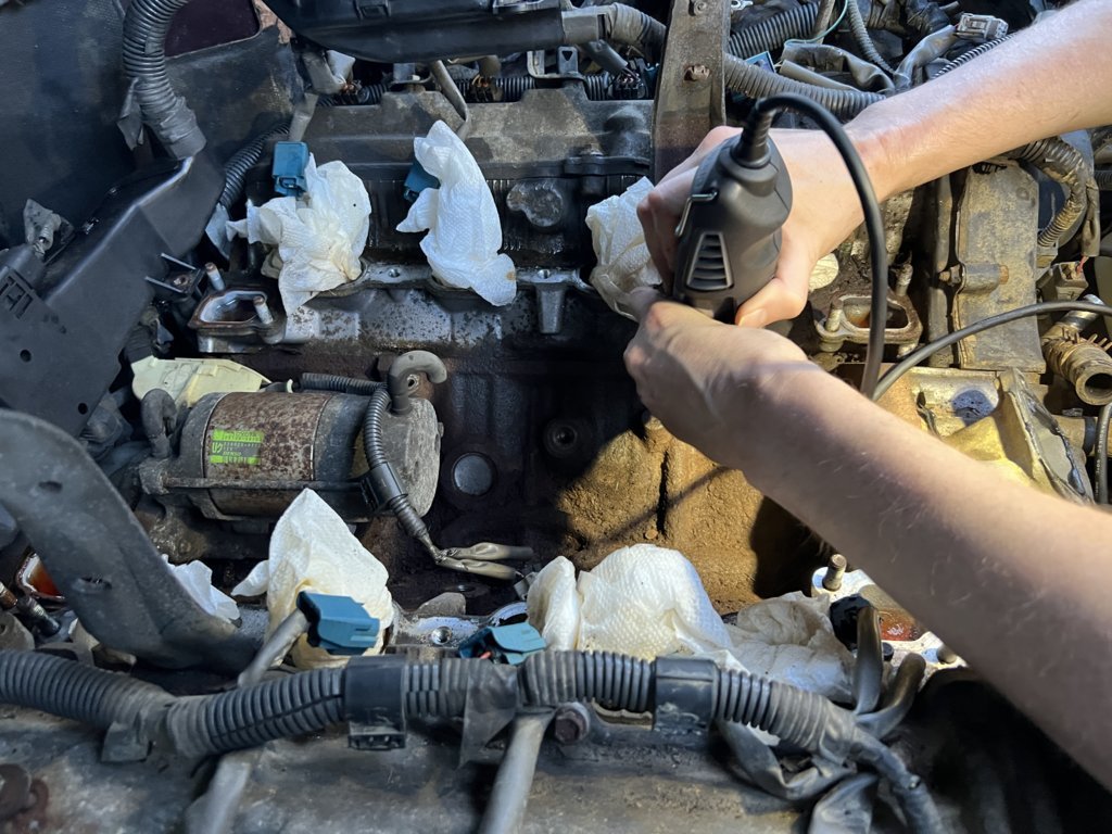

    Just starting.
    Look at the bright side. It could have been a lot worse. The rodent family moved out of this 100 before I bought it. The starter never completely stopped working.
    Ground all of the rust out with a Dremel tool.
    Dissolved all of the rust with phosphoric acid. Then painted the valley with Rust Bullet.
    Cleaned it all up and refreshed the fuel system.
