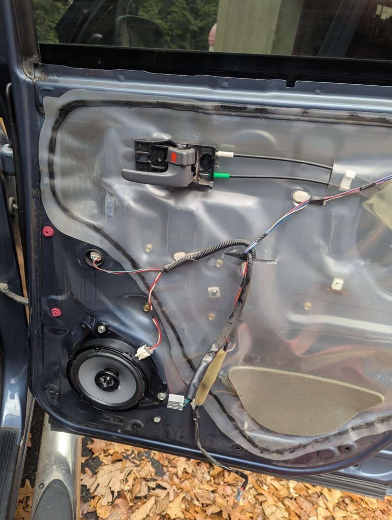

    Why does your picture show three separate pieces? I get the one long one for the rear wheels and the shorter one for front wheel, what's the 3rd one for?

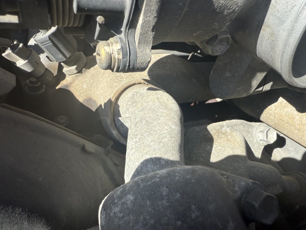

    My truck has been sitting for 2 days ‘nose up’ i dont see how the coolant crossover could get the front of the valley juicy. Kinda suspecting the throttle body coolant line. Truck was a gallon low after 2500 miles.
    how is this pipe attached at the front?
    might also be the front crossover.

    See 2nd link in my post above: https://www.tundras.com/threads/leaking-coolant.54959/
    That's my #1 culprit. Am I right? Only feet-on-the-ground can say for sure.

    front joint to the tstat is dry. Looks like my puddle starts under that heater pipe. Lemme get the intake tube off.

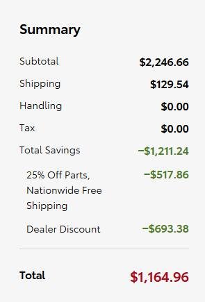

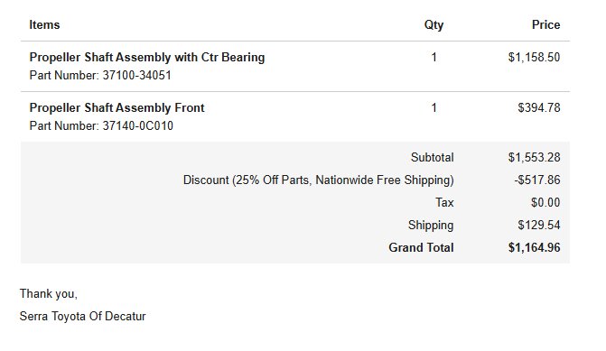

    Nice! How were you able to get them for $800?

    Soab. I’m betting thats the problem.
    time to fire up the ‘while im in there’ parts cannon.
    i’m less than 30k from the timing belt, i mean, i might as well if i’m digging in. do the crossovers, valvecovers, injectors, starter, sensors. Gimme a 90k ‘guarantee’. Sensors?
    i was hoping it’d die, but running it out of coolant seems like hunting a feeder. Like not replacing the lbj’s so i could justify a SAS.

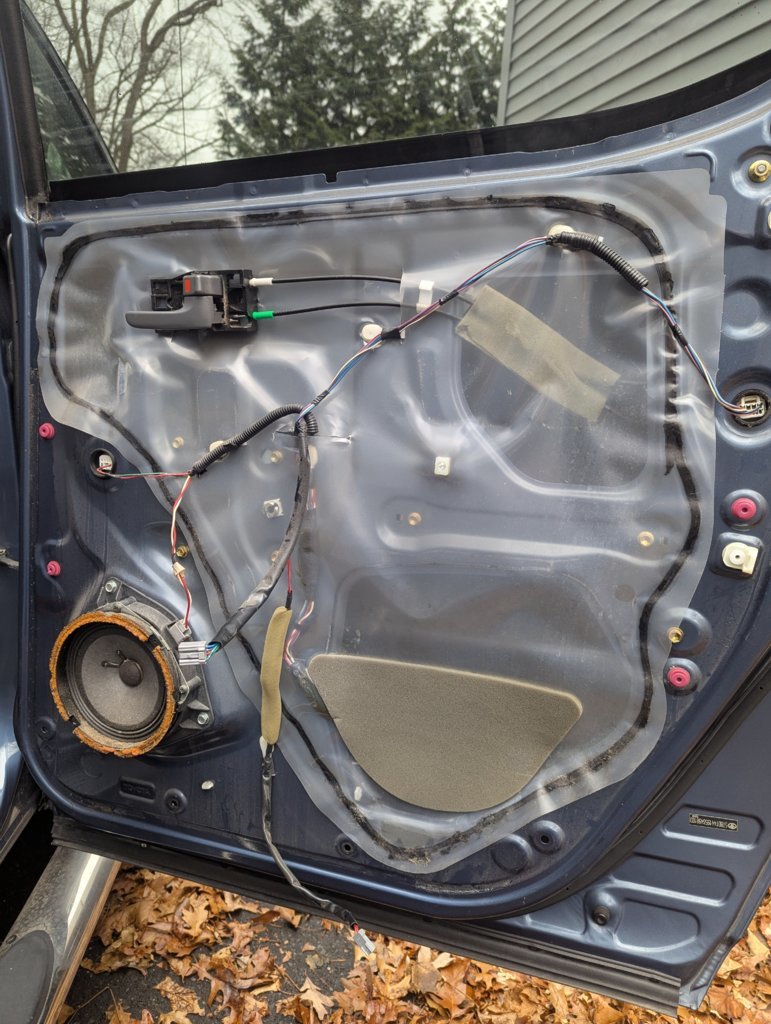

    Finally wired the SAIS bypass to the starter relay. I had to buy plastic split loom to cover the wire and also extend the wire (this was annoying). This also requires drilling a small hole in the rear of the relay/fuse box by the firewall.
    I also swapped rear speakers with Kenwood bargain barrel speakers from Crutchfield. I was surprised that the foam surround that usually disintegrates on the old speakers appeared intact but they definitely both sounded blown.
    Front speakers are next.

    It's not the reinforced mesh/paper (whatever) surrounds on the that eat shit. It's the JBL that use (IIRC) a foam surround that die? But I thought you had JBL speakers? Is there a JBL stamp on the butt of the magnets? How many Ω does it say it is on the back of the speaker?

    Yea, there are JBL stickers on the back of those speakers. And I believe that 2 ohm is on that label too. I'll double check when I get home. I've seen photos of crumbling foam around the paper cone and that's what I expected to see. I'm glad that I just got new speakers which sound excellent to my untrained nonaudiophile ears. Appreciate all of your help to this point. I'll also be using your rear camera posts to plan that install.

    That makes sense. I was wondering how the heck you got them for $800 and was kinda thinking it had to be juggling the numbers between tires like you did. BTW…. I think: Toyo Open Country , Wild Peak, and KO2-3s are all good tires and you can’t really go wrong with any of them. Each have Pros and Cons but they are all really good tires.
