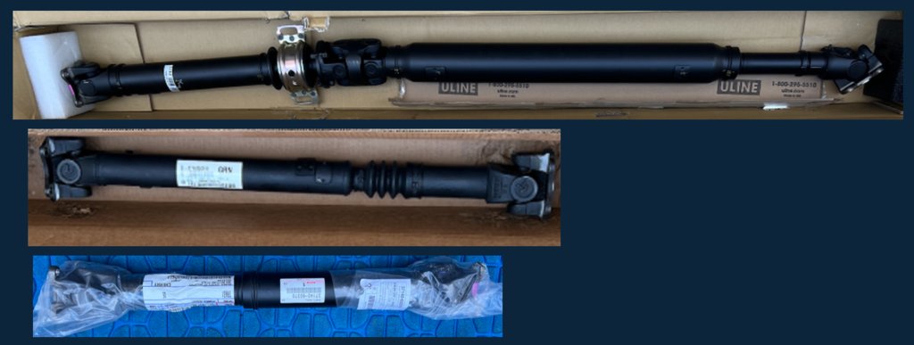

    Unboxed some new drive shafts picked up at Serra Toyota Decatur during the big 25% off sale. I'll keep the old ones as spares and maybe put on some new joints or a center bearing as time permits. Not an urgent project. It's more like preventative maintenance down the line.

    You're the first person I've seen order new drive shafts. Surprised they still sell them. Care to share what they cost?

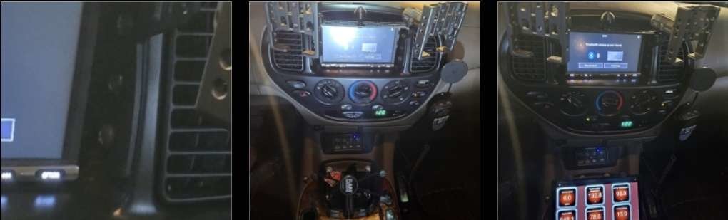

    Pulled the dash bezel and finally swapped the self tapping screws that came with my Teq Offroad MAM mount with some bolts. I drilled the holes a bit and the nuts fit perfectly from the back. That didn't sound right. No more vibration and it's solid now. Moved and mounted a Ram ball to the console for my tablet. Shitty pics, but you get the point. I also bought an OBD LInk MX+. Great little code reader and gauge tool.

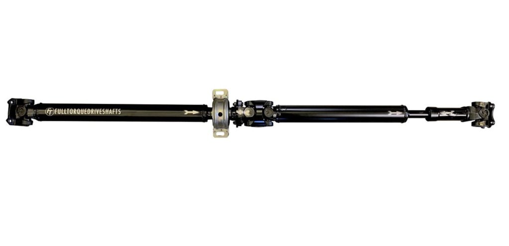

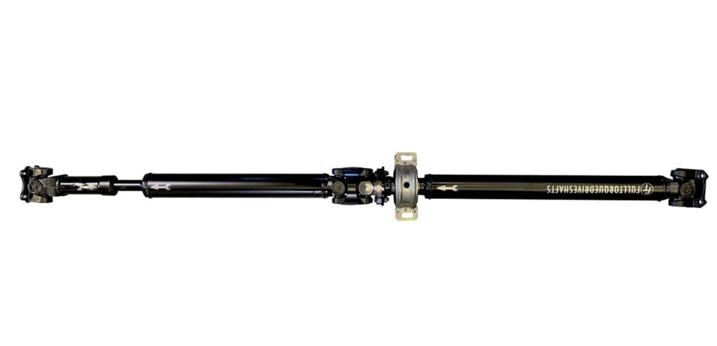

    Mine gets delivered Thursday, along with all of the other inbound crap. Right at $1300 from Fr33lance Fab.
    My Tundra DESERVES it....damnit.
    Here’s why your 4x4 First Gen Tundra deserves this upgrade:
    • Updated 1310 U-Joints – Forged solid-cross NEAPCO u-joints strength and long-lasting performance.
    • Fully Serviceable CV/Double Cordon
    • Spicer Double Sealed Carrier Bearing - (OEM is single seal)
    • Custom Built To Length Your Vehicle - (no vehicle is the same)
      • Reference Photos For How Too Measure
    • Forged Slip Yoke
    • USA Made DOM Tubing
    • Balanced To Perfection - no bad vibes here.

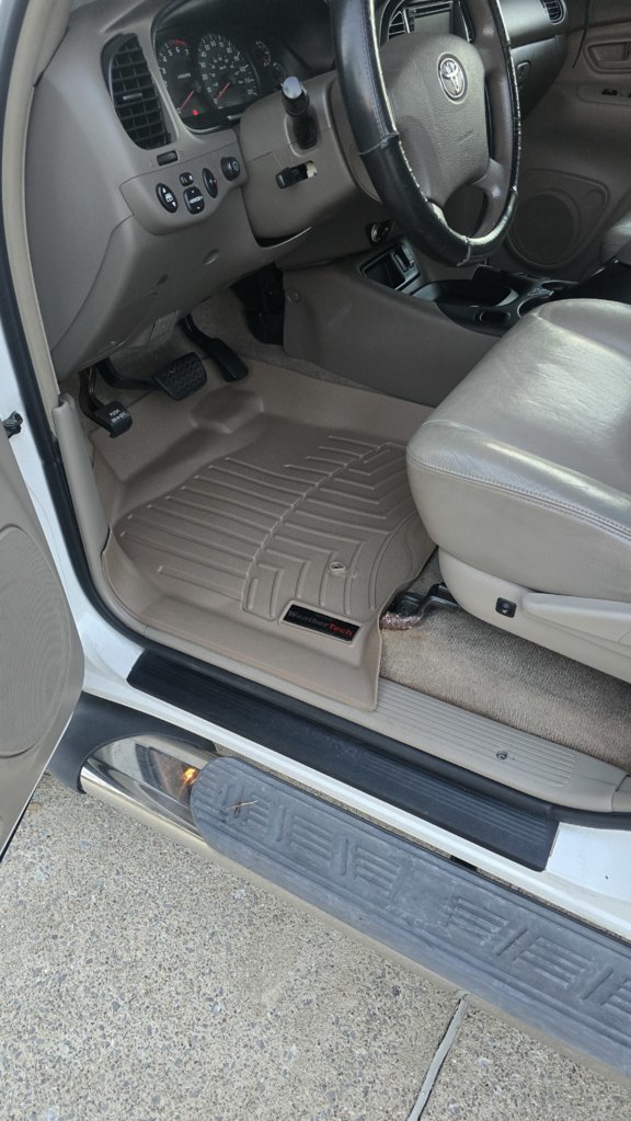

    Vacuumed out the carpet a bit (it didn't need much) and put in the Weathertech floor mats I ordered a few months ago. (Both sides front and rear put in).
    Walked around her a bunch and admired. Made plans for what to fix next. :)

    I had a few that were loose. I also replaced 2 worn ones behind the knows. No more rattling...yet.

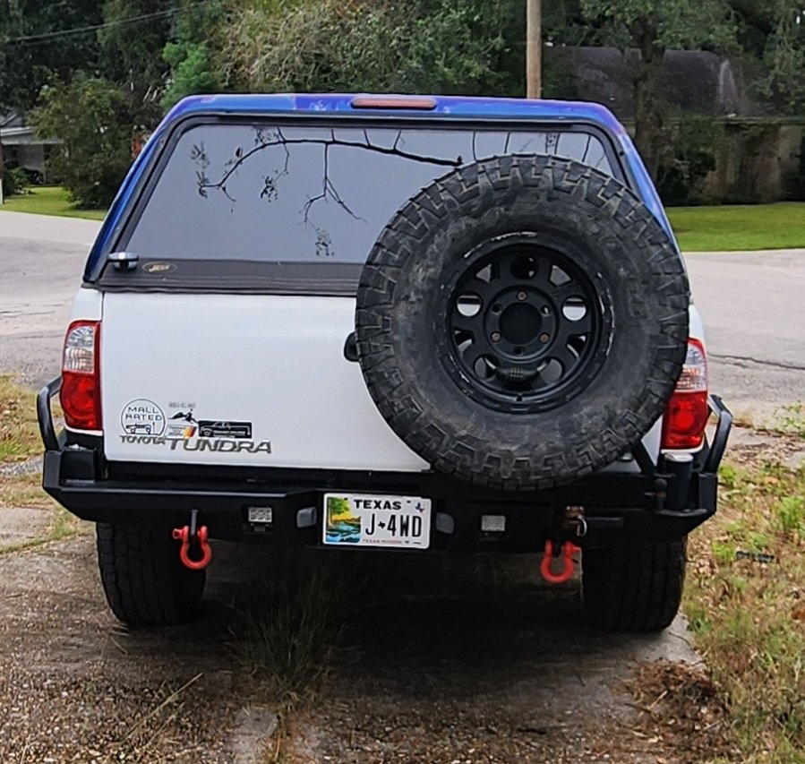

    This reminds me, I still need to remove my spare tire and file down part of the wheel. I've taken some good rock rash on my KMCs over the years. The spare has a chunk of metal sticking up from the rim that sometimes lets out air, by poking the tire just enough to slightly debead, when aired down, off camber. But I'm hoping to have the MSTs and 35's on her sometime soon, after T2S and LST Jamboree.
    Might be visible if you zoom in

    It was during the recent 25% off sale at Serra Toyota of Decatur. With their usual discount +25%, it came out to 48% off.
    These sales come around once or twice a year. I'll buy parts and hold on to them until the time comes when I need to use them. I keep old driveshafts as spares.

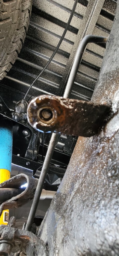

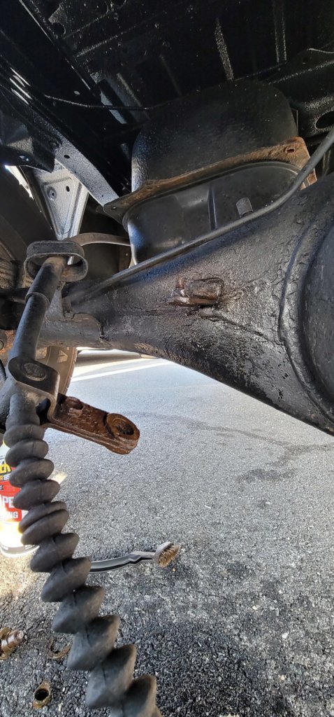

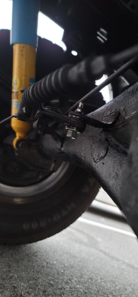

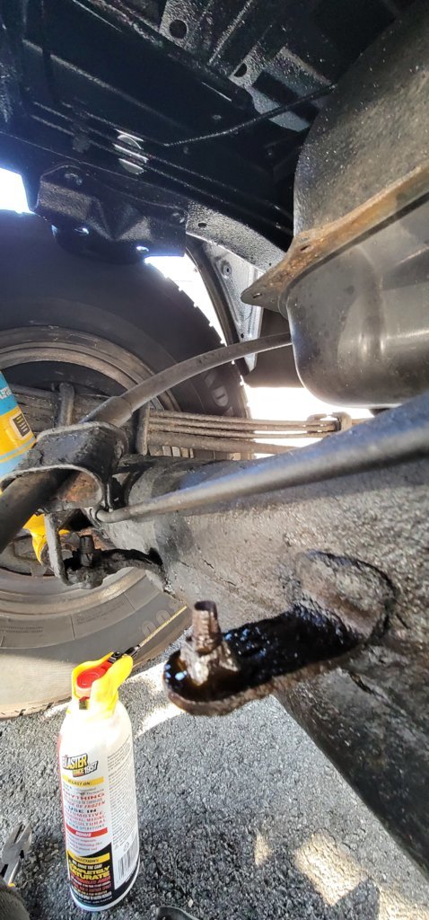

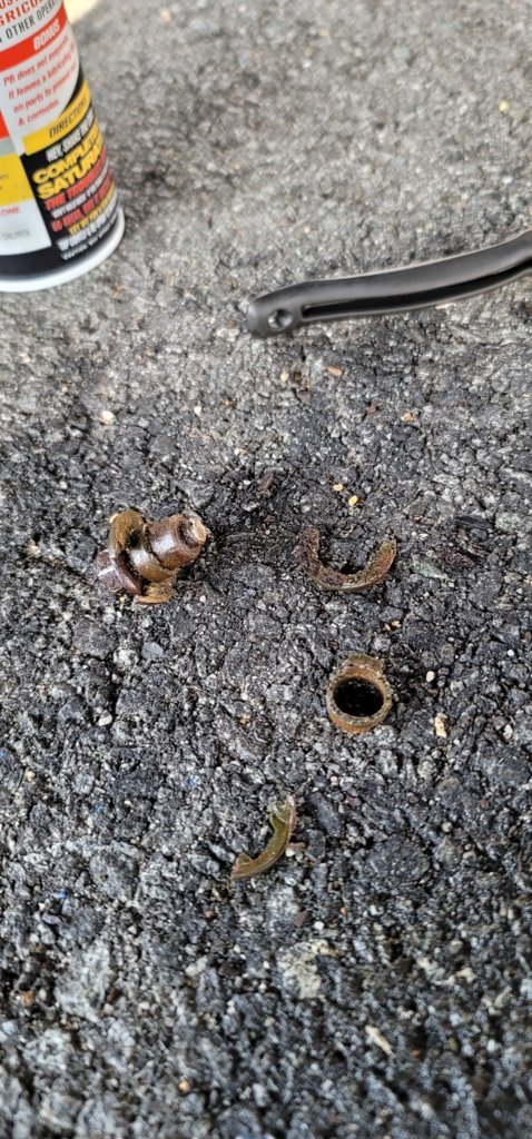

    Replaced bolt and bushings on parking brake equalizer pivot point. Was completely frozen up with zero movement because of how rusted up it was. The bolt snapped clean in half when trying to remove...I thought the nut on the top end was removable and couldn't get it off until i figured out it was molded/welded onto the bracket as one piece. I was able to eventually get the snapped end unthreaded thanks to the help of my neighbor who had death grip pliers to twist it off slowly but surely.
    Now the equalizer can freely move and pivot as it should. Coupled along with brand new bell cranks replaced last week.
