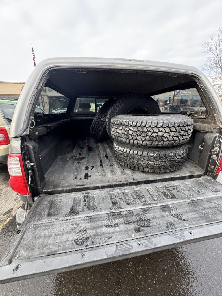

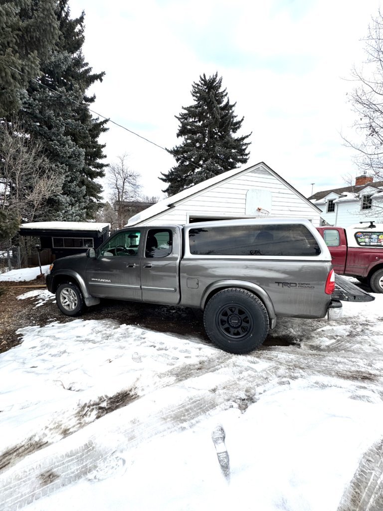

    Got tires mounted on the new rims
    Method 703 17x8.5 0mm offset
    Yokohama Geolander At 4 255/80 R17

    Those will look great installed. What are your suspension plans?

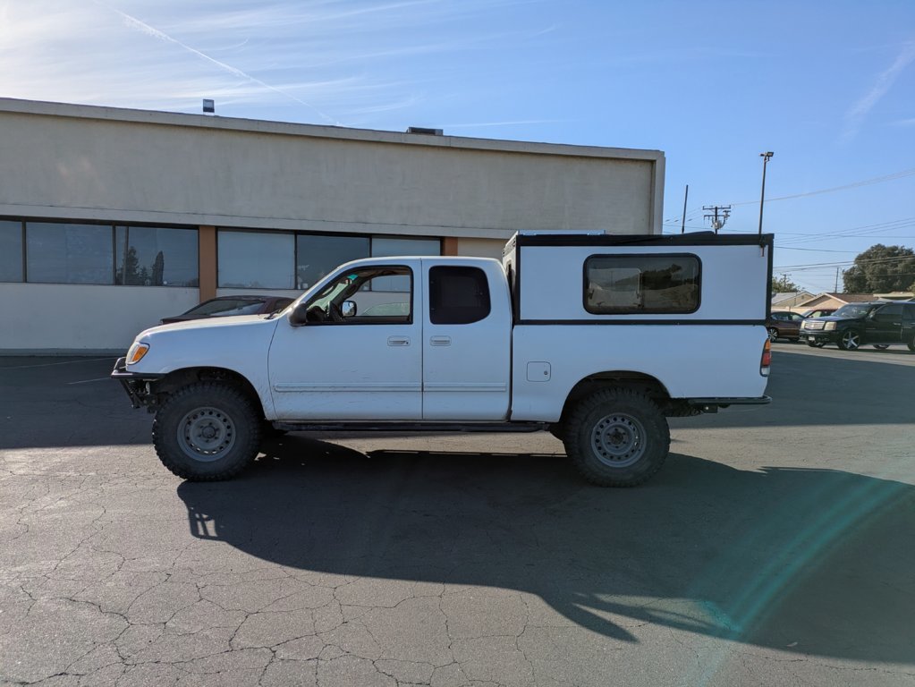

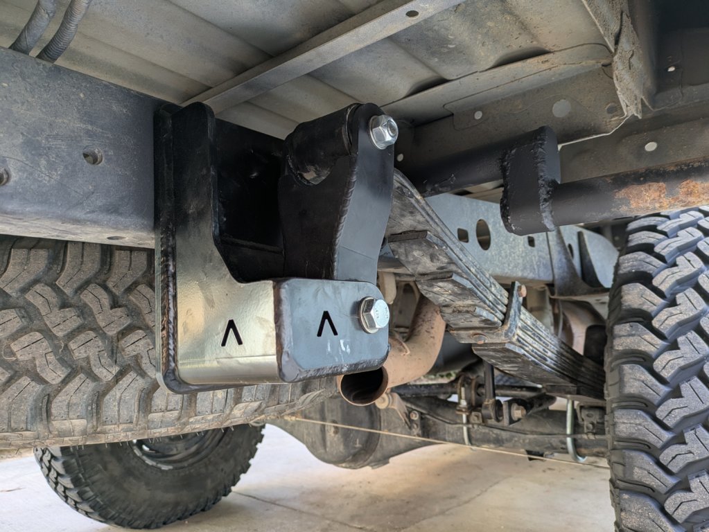

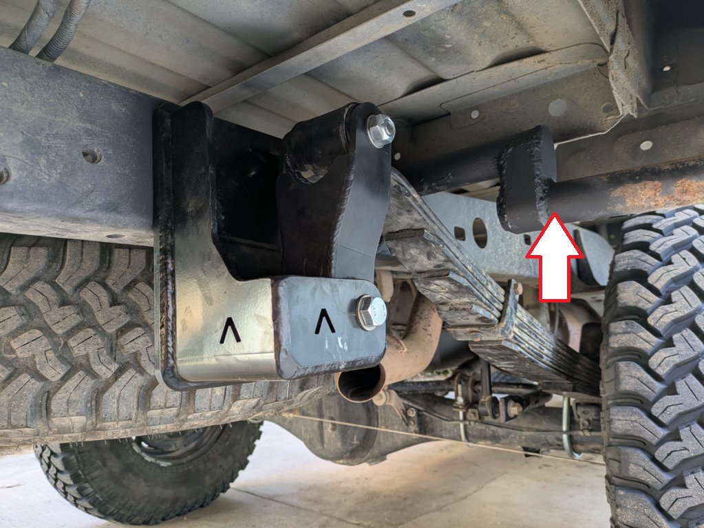

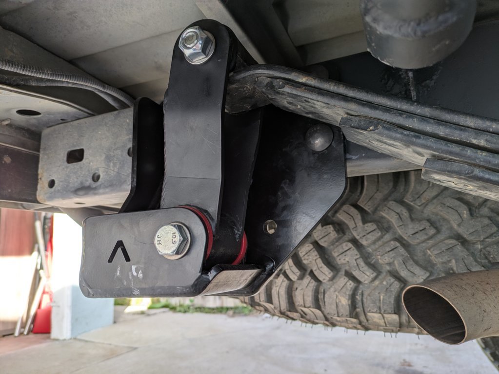

    So I bought some Total Chaos lowering shackles to bring me down a bit because I had too much rake after adjusting my 6112s down to the 3rd notch. While contemplating that project and knowing Id be removing my leaf springs, I decided to splurge and get some Archive Garage Hammer Hangers as well. Truck looks pretty level now. Also took it for a quick test drive yesterday, and this thing has almost no body roll anymore. Probably gonna add some sort of a cross tube from the hangers as well to get even better stability in the rear.
    PXL_20250304_233337520.jpg PXL_20250304_235903849.jpg PXL_20250304_235926271.jpg

    What leafs are those?

    Sick. Are these just bolt on?

    Archive Garage MD leafs

    They do bolt on but the oem has to be ground off

    Yea they bolt on , but you have to drill out or punch out the old riveted in stock hangers. Actually was surprisingly easy. I was watching videos where other guys used air hammers to do it but some grinding and drilling made pretty quick work of it!
    Also helps that I ordered the extra drill bits from Archive Garage that cut through the rivets like nothing.
    Oh and wanted to add, Archive Garage quality is quite impressive. Not only the welds and stuff they build, but the instructions they provide, how everything is organized and packed. Really impressed!

    Was ist das? Stiffener of some sort?

    Oh yea, forgot to mention that funny looking thing. So when I had a bumper built 6 years ago, before I learned to weld, the fabricator welded the forward brace of the tube bumper to my frame. The lower tube used to go straight through to the frame. This was fine until the lowering shackles I installed caused the leaf spring to contact the tube. So I cut out that portion of the tube to the frame, and welded a sleeve to attach to the top tube you see now and thats going to the frame several inches higher, giving me clearance on the leaf spring now.

    Just for a heads up, the Total Chaos lowering shackles lowered me about 1". Hub to fender was 23" and now is about 22". My front is about 21" on both sides. So pretty level now

    @Tlar25 Toytec 650lb coils paired with 5100s in the front and 5100s with a toytec add a leaf in the rear.

    I'm jealous. I really want some hammer hangers and their shock relocation

    The shock relocation would be pretty awesome, but my bed aint coming off any time soon!
    Down the road ive thought of building a flat bed and then a new camper on the flat bed. So at that time id probably do the shock relocation as well. But until then, im pretty happy with my setup

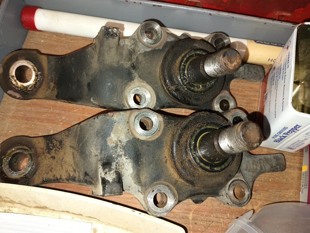

    Yesterday, actually. 107,xxx miles on the originals. Drivers side was good, no movement when I checked them on the truck, but the passenger side had a bit of play in the joint and the grease was leaking on both ball joints, so they were replaced with OEM.

    Do you always add black pepper to your LBJ's? :D

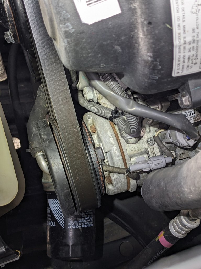

    Noticed that the pesky wiring harness that is always getting chewed on when routed incorrectly during a T-belt change... Is routed incorrectly on my truck, and allegedly has been since 2016 according to the Aisin sticker... Can't believe it's been like that with no visible damage for 70k. Maybe it did get damaged and was replaced? But I have 14 pages of records and no mention of it...
    Not sure what maintenance other that T-belt would cause this routing... Not even A/C replacement? Which I have no record of...
    Access is difficult to get an ideal zip tie, but I secured it the best I could until I get to my belt job this spring.
    Does the bracket have to be removed to route behind or can I unplug and sneak it thru... Hmmmmm. EDIT: Yes it can be fished thru with some grunting, cursing, needle nose pliers, and luck...

    You got it, yeah I had to do the same thing fishing it back through there. It's tight, one plug at a time with long bent needle nose :thumbsup:

    I've seen this mentioned but never knew what people were talking about. I need to check mine.
    What's it look like after you fishes it through?
