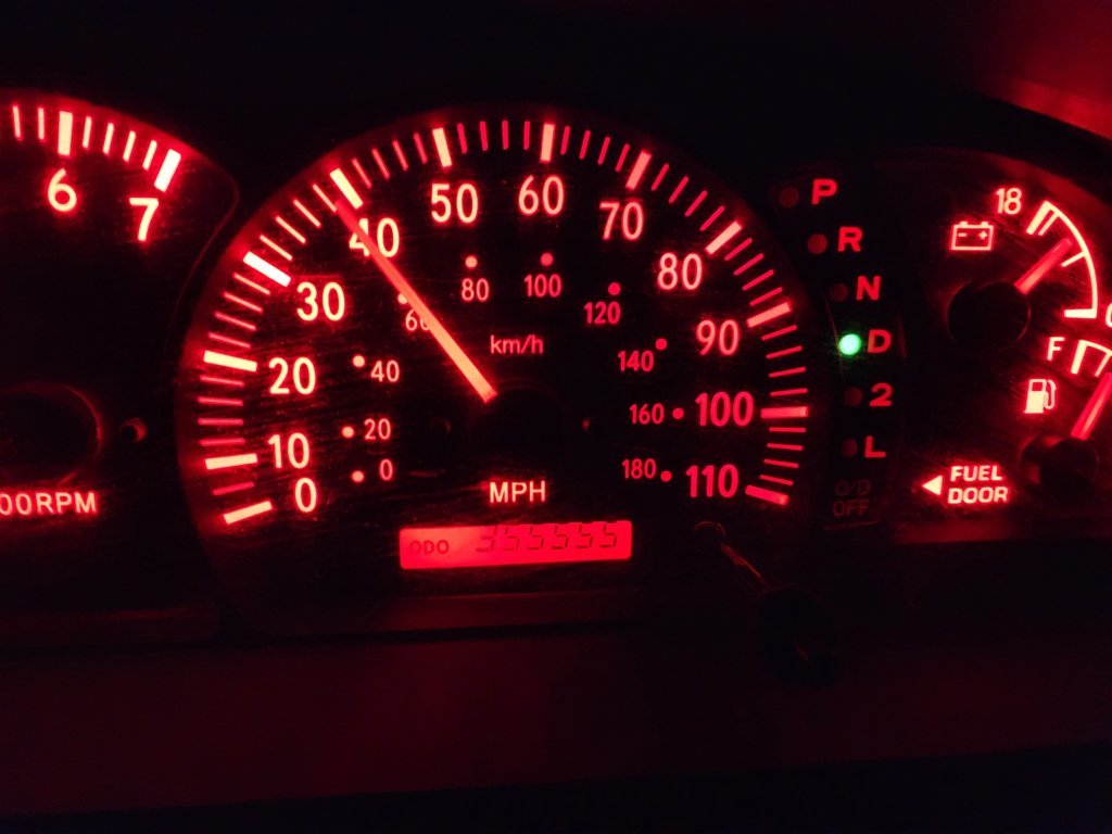

    That red dash looks amazing. Can you dim it and make it brighter? Or is it stuck like that.

    Does that light up the interior? Might be cool to drive around on Halloween dressed up like Satan with the horns, cape and jagged sharp teeth.

    It dims, just in steps, vs smoothly like the incandescent bulbs. Hope that makes sense.
    https://youtu.be/TaCN8M_6aaQ?si=XVi8Vz_3NOQ8HvvG

    I guess if I had red map lights and dome light maybe

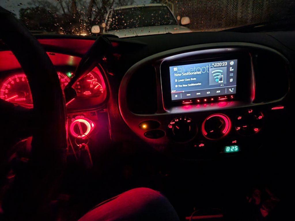

    I've been using the JVC KW-M590BT in the 02 AC for over a month, so I wanted to update on my experience. First, Crutchfield gave me no issues in returning the other head unit to them and processing my refund. The capacitive display on this unit is substantially brighter than the resistive display on the other. Glare is still a problem, but it's bearable. The Apple CarPlay features on this unit rock, especially the ability to read your text messages out loud. Android Auto is included, but we don't have Android phones, so I can't speak to how well that works. The sound output is decent, although response to the EQ settings seems inconsistent across tunes. That may be due to the dynamic range of the source files on my iPhone. My only real gripe has to do with the volume buttons. *sigh* There's a real art to getting your finger in just the right place for them to respond. Oh and the first correct touch merely wakes up the volume control, you have to press it correctly at least once more to get an actual change. Overall, it's a definite improvement. Now I'm just eagerly awaiting the DIR harness with reverse tap from @daveeasa so I can seamlessly add a backup camera to this unit.
    EDIT: Totally forgot to mention that there is a gap around this unit once installed. The Crutchfield site says the trim ring is not recommended. If you try to use the ring, you'll discover a couple of braces at the top of the opening that keep you from fully seating the HVAC/Radio trim piece. I guess I can live with that. Oh, yeah...I could not reuse the harness from the other unit. So, I had to remove all the PosiTwists from the original connections and reuse them on the new unit harness.
    P.S. While writing this post, I noticed that the price of the head unit had dropped $10 on Crutchfield's site. I went to the chat option on their site and told them I wanted to exercise their "Price Drop Guarantee" and they credited my card with the difference plus tax. Not bad!

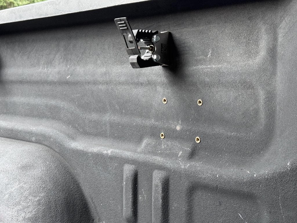

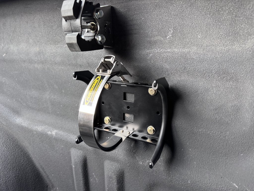

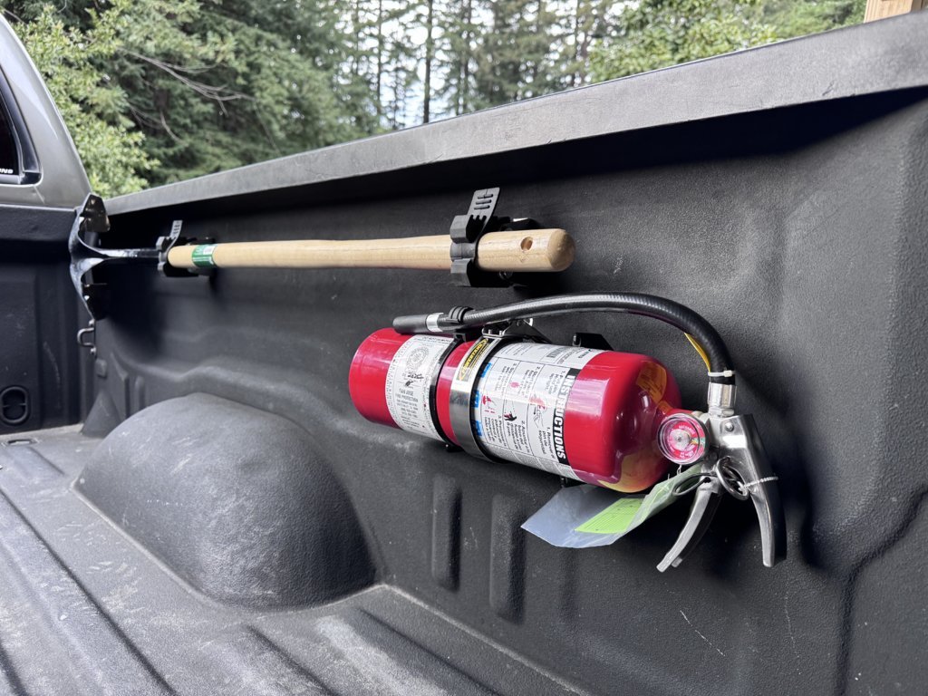

    Second part to my bed mounts (required for wild fire prevention).
    The Powertank mount for a 10lb Extinguisher showed up so I busted out the RivNuts and got it mounted.
    Nice and solid and installed in about 15min.

    That's clean. Might have to steal this one.

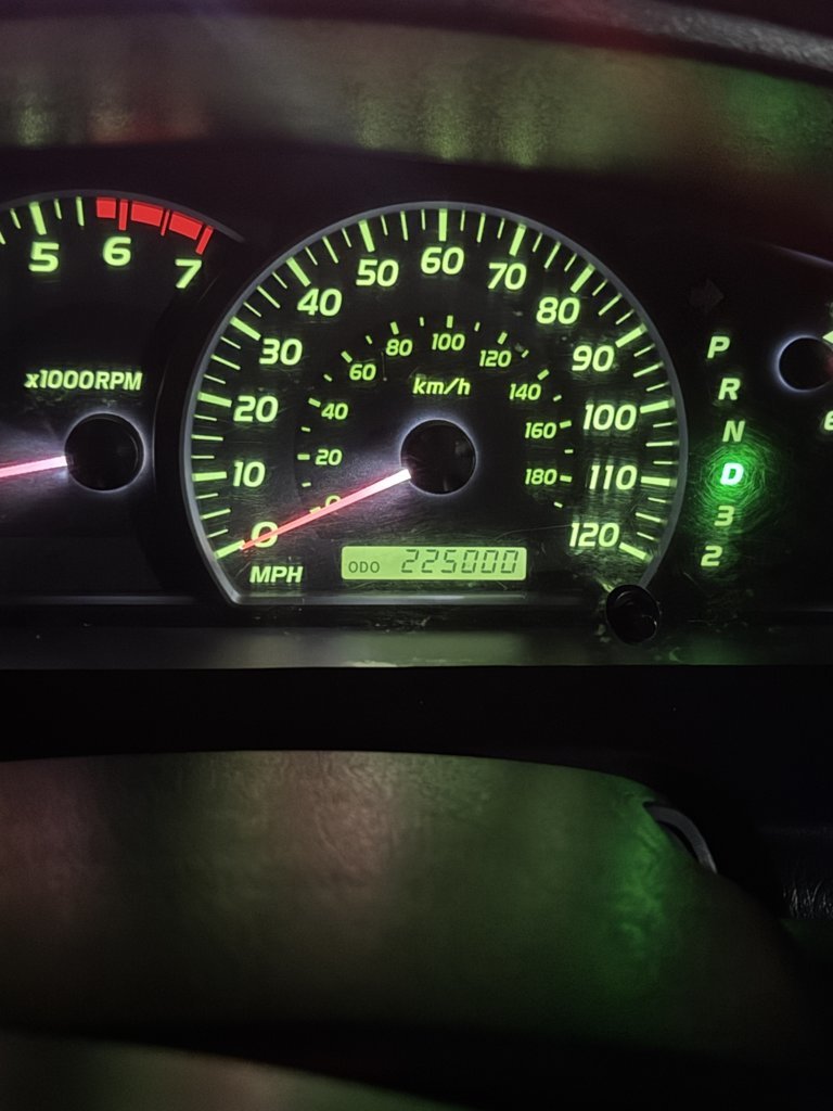

    I'll tell ya, I love the green backlit gauge cluster on our trucks.
