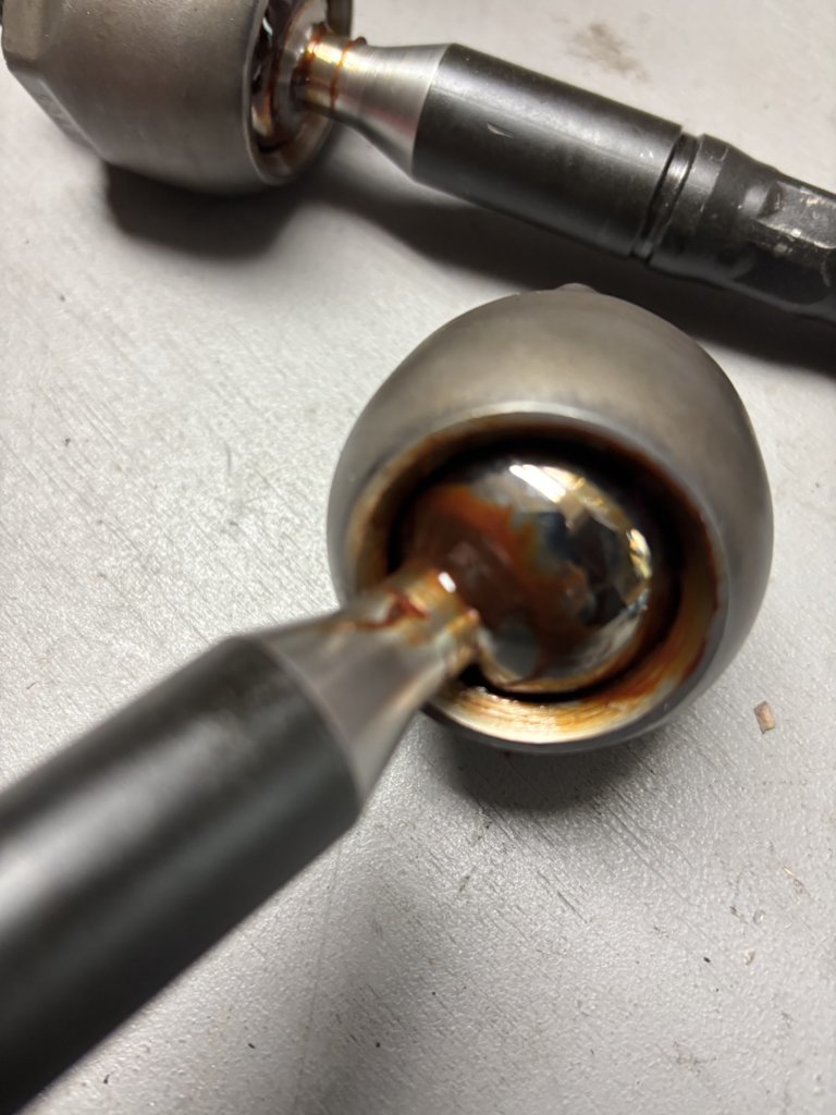

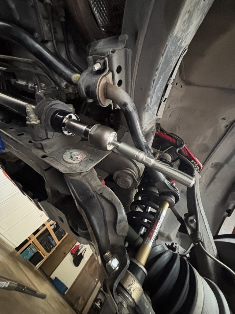

    OEM inner tie rods, super easy with the right tool. Found some fluid in both bellows, but my level is normal. After 20 years i have never had to top it off and just chalking it up as normal. The old tie rods were very loose and the tire side to side play was noticeable.

    Alignment done this morning, steering wheel straightened and front tires rotated. Oh man, it feels tight again!!!

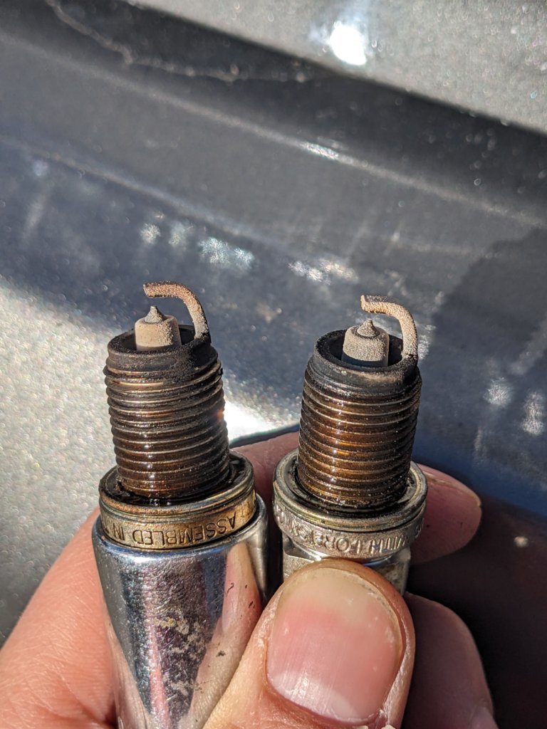

    Having some blue smoke on warm starts... check my pcv, vacuum hoses, and spark plugs.
    Everything seemed in order. I'm not overly worried but will continue to keep an eye on things and troubleshoot.
    Heres some spark plugs.
