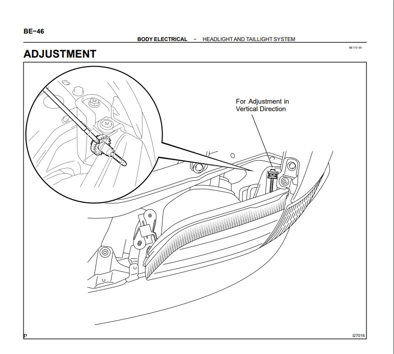

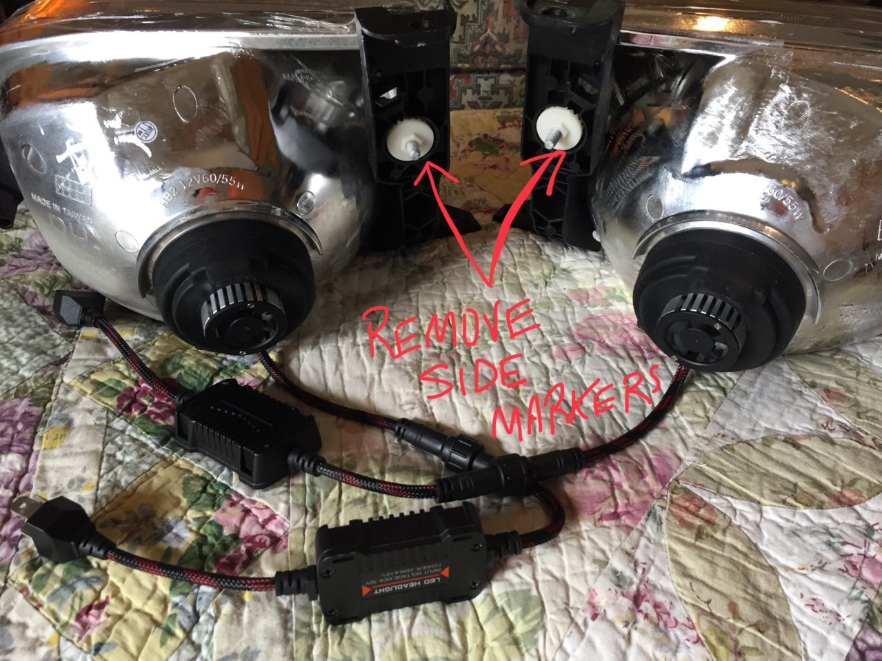

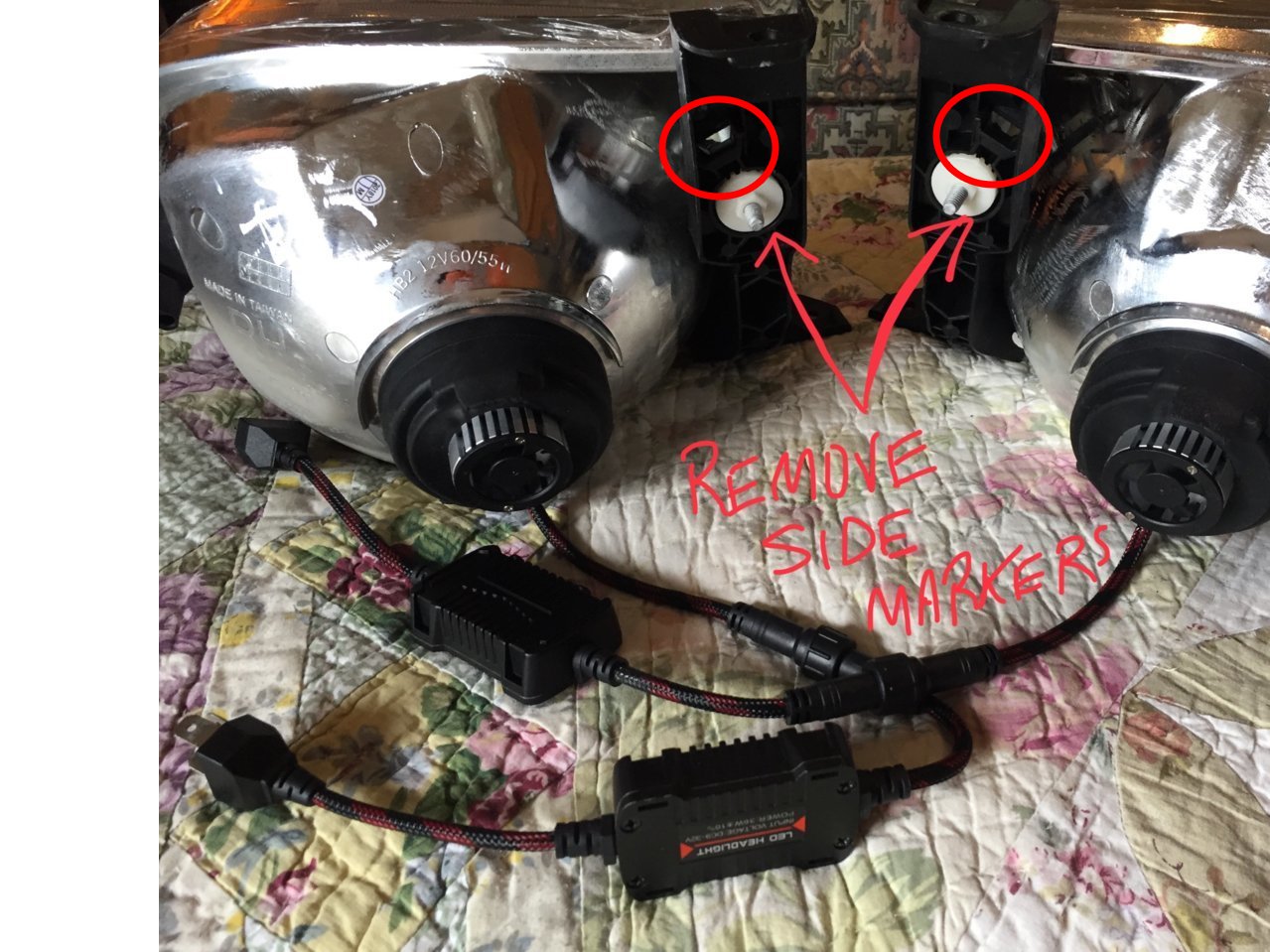

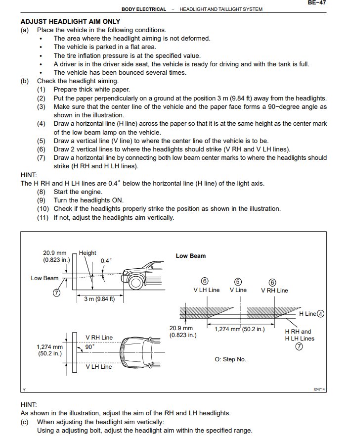

    Anybody know how to adjust our headlights down? After lifting the truck and installing 100w h4 bulbs, I keep getting flashed and I figure I should angle em down a little.

    2- 10mm open wrenches and you adjust the upper bolts/nuts that at are next to the side marker. Side marker needs to be removed. I’ll look for pics.

    Should have bought Katanas LEDs. Its amazing how white bright, but not blinding they are. These pics show aftermarket brand new housings, but the OEM adjustment should be the same.
    Remove side markers and adjust the bolts where the white notched washer is seated. A 10mm wrench on both sides helps.

    Tech tip: You don't need to remove the side markers. The "gears" on the rear of the white adjustments disks are designed to accept a Phillips head or JIS screwdriver.

    I used a long phillips head screwdriver. There is a hole near the back of the housing on the outboard side that it will fit in. turning it will then aim the light up or down.

    Here's what the FSM has to say.

    So the image has em on the wrong sides?

    There is a hole in the crossmember, use a phillips driver and theres a gear you turn to adjust.
