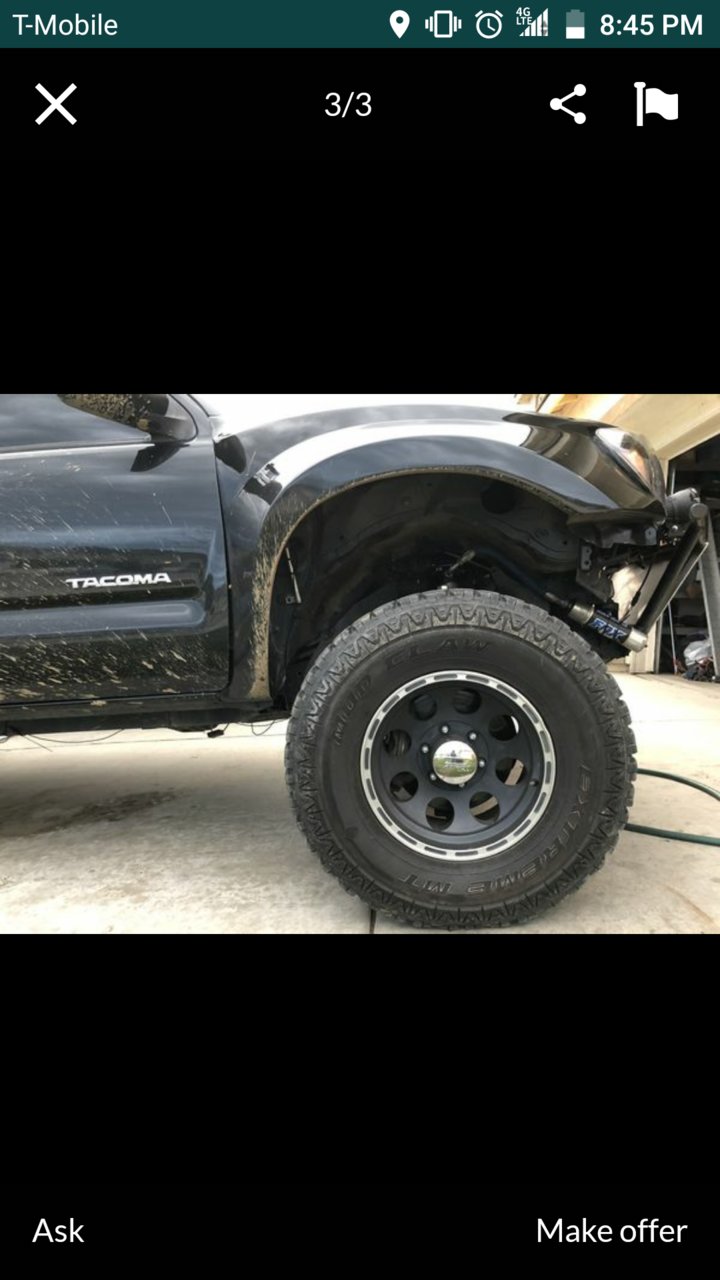

    You would have to ask Icon, but I assume they can't handle the droop. If you lift by block you have the same amount of travel, but slightly more extension (with less compression). If you lift by AAL or full leaf packs you get more travel in addition to the more extension (with about the same compression as stock).
    That's the reason I left 5100s on the back of my truck. My full Alcan pack has the a bit less compression than stock because I retained stock bump stops but have a thicker leaf pack. However my leaf springs can extend 3" further than my 5100s can, and those are meant to handle 1" of lift by block.
    Unless you drive violently enough to jump your truck, this isn't too bad. It just isn't optimal for your shock to be the limiting factor of your suspension.
    Edit: looks like Icon and Wheelers no longer have the disclaimer about blocks only. Maybe the design changed, hopefully.
    Some of the other ones still mention it.

    But it shouldn’t matter if you have bump stops right? Isn’t the bump stop supposed to stop the suspension from overcompressing and ruining the shocks?
    I’d also think that shocks designed to hand stock height to 3” of lift wouldn’t care since the compressed length of the shock is the same as OEM at that point, so the bump stops should do their job and prevent damage.

    On compression it's no problem, on extension is where it could get bad. Looks like they removed the disclaimer so might be fine.

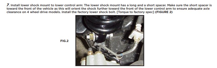

    ICON is saying the short spacer goes towards the back of the truck. Typo?
  25. May 13, 2019 at 11:18 AM
    #6805
    empty_lord
    Feb 1, 2019
    #25441
    10,129
    Dan
    Indiana, Chicagoland
    05 rollover special
    The picture shows the way it’s installed in my Tacoma.. it’s a misalignment spacer..
    Darkness and TX-TRD1stGEN like this.
