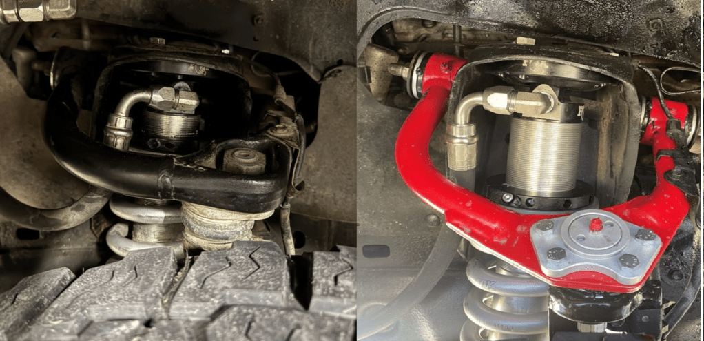

    Hey @bhb983 nice setup and good looking truck. I’d suggest backing off the preload though. I went through that last night with mine (same coilovers). I think I have about 7/8” of preload, or 12 threads in driver side and 10 threads on passenger side, which has my front sitting a hair over 23.5” in front. But I haven’t driven my truck so hopefully I’ll settle closer to 23.25.
    I’d hate for you to have to reboot those CVs again so soon.
    Below is how I’m sitting right now.

    Thanks for the reference @Kimosabe, I was, like, "damn ... I've never seen anyone with Fox 2.5s spun up that tall, not even Erik/abl1k was running that high"
    What's the thread-to-lift ratio on those Fox? Like, my Aluma 2.0s are like - I think - one inch per one full thread. I'm guessing it's not the case with Fox.
    Side-by-side comparison on what looks to be a pretty-normal adjustment vs. the other pretty-outlandish - look at the agle of the UCA, and this is while sitting on the ground - holy shit!!! All the stress that's placing on the knuckle and added torsion on the UBJ is arguably dangerous:

    I think it’s just the perspective of the picture.

    I’ve learned it’s all relative and depends on the coil, etc. But I think the rule of thumb is: a 1/2” of preload equals 1” of lift.

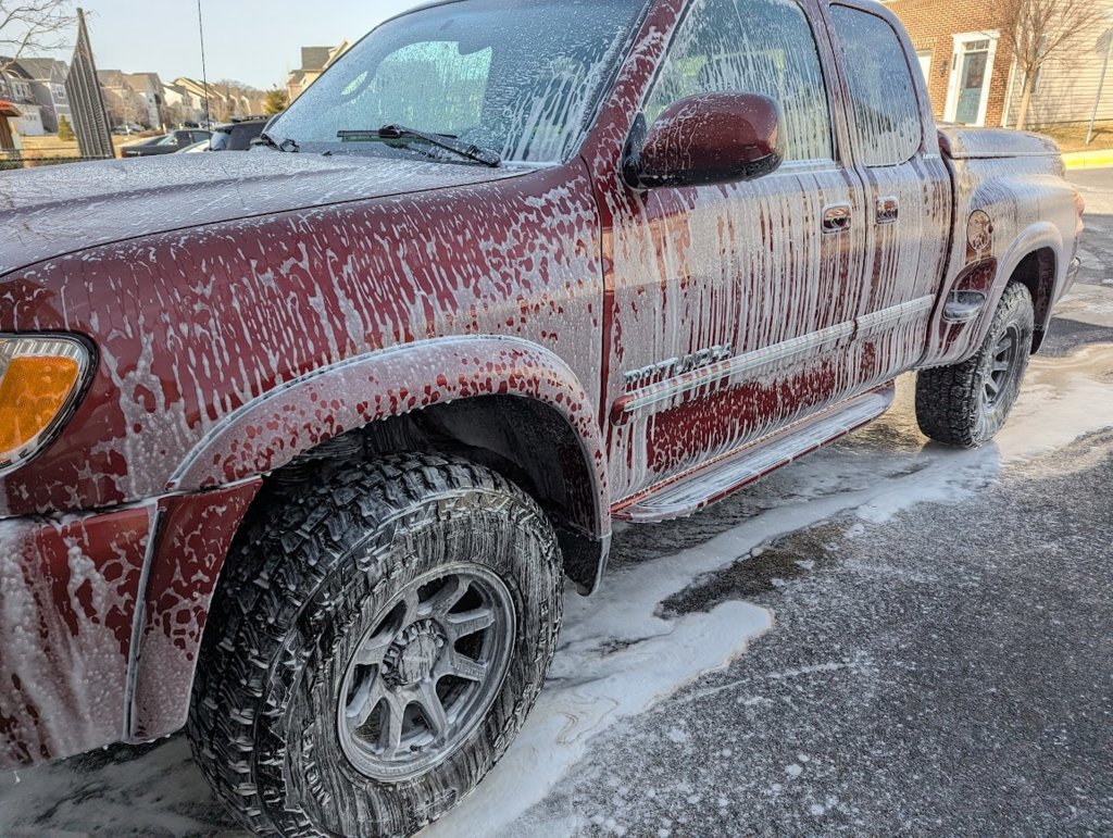

    Used the foam cannon and pressure washer to rid my truck of the salt, hopefully it's done for the rest of the year. I didn't go for a full wash since it's supposed to rain all day tomorrow. I always add AMMO Boost for extra protection against corrosion. PXL_20250130_183616950.MP.jpg PXL_20250130_183638296.jpg
