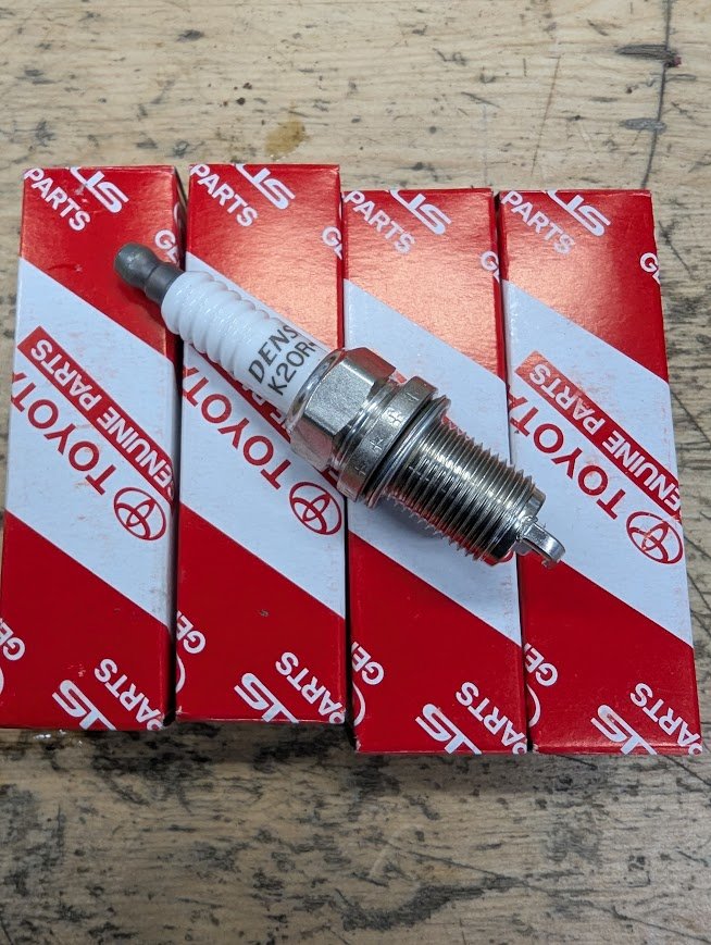

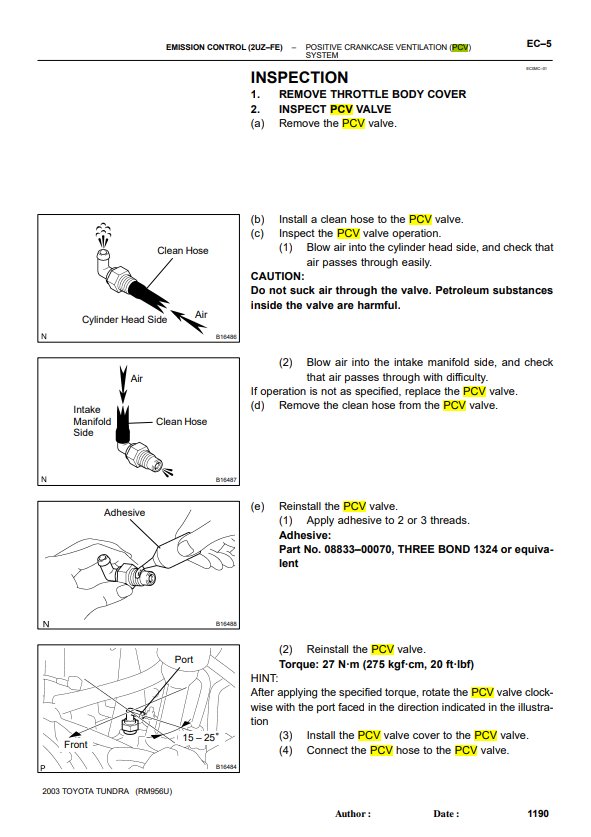

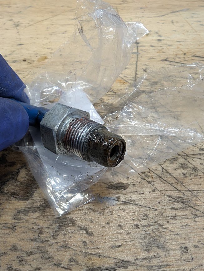

    Swapped out my plugs and PCV valve. The PCV valve wasn't too bad, still giggled but not as good as the new one. The plugs were interesting, ran good, the electrodes still looked fine but they've been in there awhile. Last record I have of them being replaced was at 93K miles, it's now at 215K, so that seems to look about right. Whoever replaced them used was too much anti-seize because they were a little gummed up and sticky coming out, luckily I didn't run into any issues with the threads. They were replaced with Iridiums, not sure what it came with originally but I ordered them from Toyota by VIN so I guess they are supposed to be standard copper. PXL_20250127_165753770.jpg PXL_20250127_165739281.jpg PXL_20250127_165823942.jpg

    Jealous of your screw-in PCV. I get so scared I’m going to drop bits of rubber into the motor every time I remove mine.
    Actually, can 00-02 and 03-06 valve covers be swapped?

    How do you remove it? I just pull and twist at the same time and it pops out. The trick is getting a good angle for the twist. That dried up foam protector disintegrated on me. Tossed it.

    Mine always removes just fine, but I'll never get over the fear of the rubber grommet breaking into a million little pieces.

    Mine isn’t that dried up. I guess I can’t relate. I do remember someone mentioning that if it did fall in, you can still get to it by pulling the valve cover.

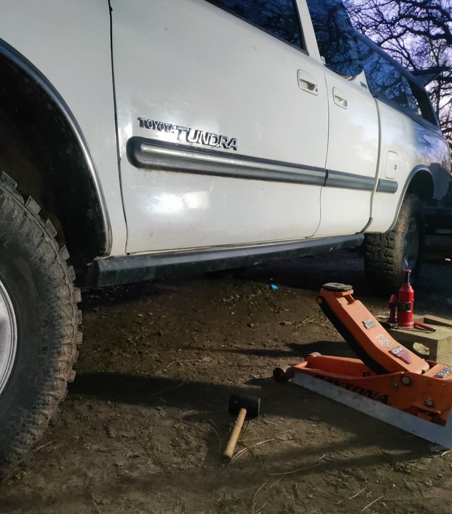

    I swapped out my LCAs with OEM replacements. Whatever was on there definitely wasn’t OEM. Funny thing is the truck seems to be sitting higher with new LCAs. Is that possible? Could worn bushings cause the old LCAs to sag?
    I’ve replaced LCAs on 3 different vehicles and this was the smoothest it has ever gone.

    Yes. Happened to me and was the reason the alignment place couldn’t get my alignment to zero camber. Best was -0.5.

    You drive it yet?
    Mine always has to settle after I jack up the front end. Mine will be like 2" higher at first, before it settles
    Or did you tighten the LCA bolts with wheels on the ground or in the air? Everything I've seen says on the ground is the way to go. I'll be doing my Solo LCAs and cam eliminaters soonish. It'll be my first time messing with LCAs myself.

    That makes me hopeful. Ive had trouble adjusting my coilovers and the front sitting low. Now it’s looking high, but I haven’t let the suspension settle. I’m gonna take it for a spin first and see if it settles.
    And I’ve had a little rubbing cuz I don’t think the alignment is right. Fingers crossed that this fixes those things.

    Only a back and forth in the driveway. Probably not enough to settle it. I tightened the LCA bolts with it off the ground. The FSM didn’t say anything about it being in the ground and I couldn’t remember if it was supposed to be weighted or unweighted… And as I type this I seem to remember weighted being the recommendation. So, I’ll try that tomorrow morning and drive it around and see what happens.

    Jack the front end back up
    loosen the LCA bolts
    Lower the truck back into the ground
    Torque the LCA bolts with the trucks weight fully on the suspension
    When you tighten any suspension fasteners like these, do it with the weight on the suspension. Tightening them with the truck in the air and the suspension cycled down freezes the bushing in the down position, instead of the “resting” position. The bushing will then get over rotated with every cycle of the suspension and tear through the rubber quickly. Your likely sitting higher due to not settling and due to the LCA rubber bushings resisting the over twisting force that is being applied to them now.

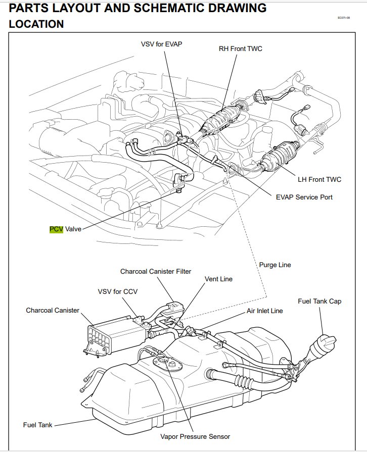

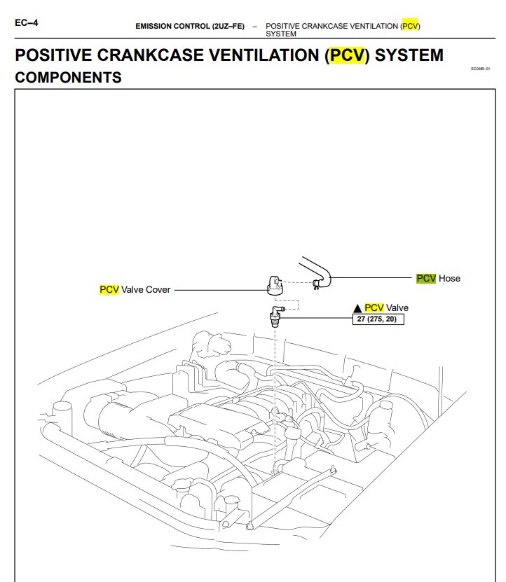

    What is this PCV valve you guys speak of and when and why should these be getting replaced?

    I'll try that this morning and take it for a spin to get it settled.

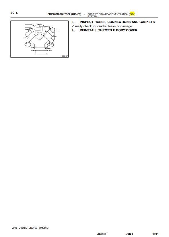

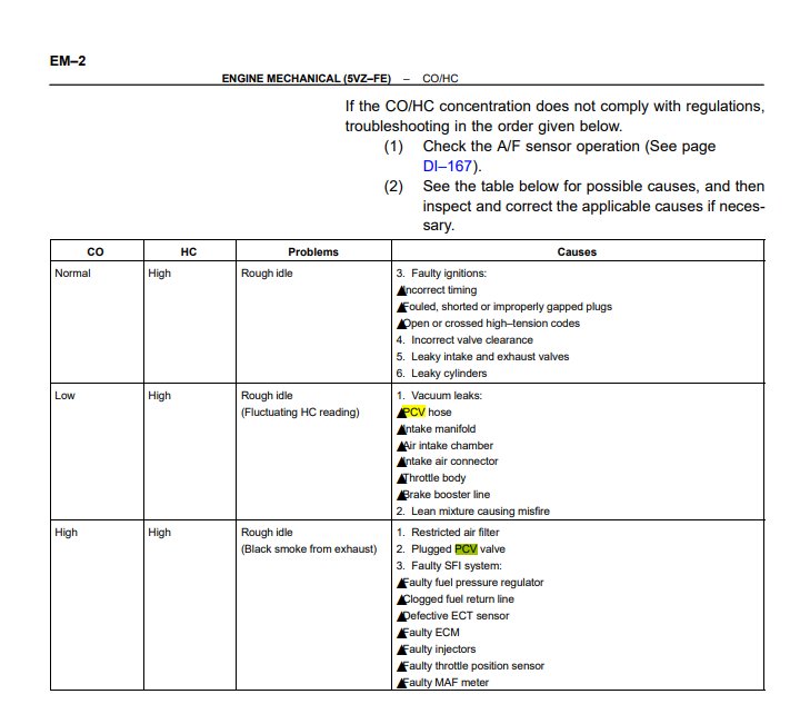

    upload_2025-1-28_10-9-8.pngupload_2025-1-28_10-9-24.pngupload_2025-1-28_10-9-55.pngupload_2025-1-28_10-10-10.pngupload_2025-1-28_10-10-32.png
