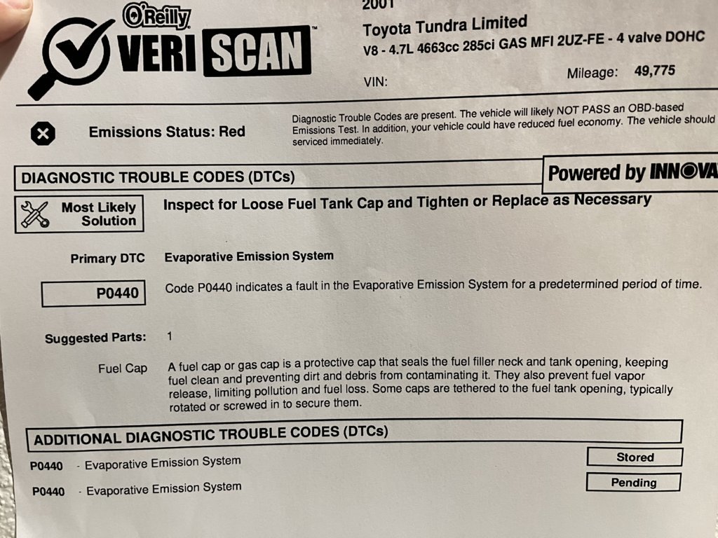

    Today on the way home from work my check engine light came on! Stopped at an O’Reilly’s and it came up as a P0440. Gas cap was actually loose (not “clicked”) so I’m hoping it’s that.
    Edit: it went off about fifty miles after tightening down my gas cap. Whew.
