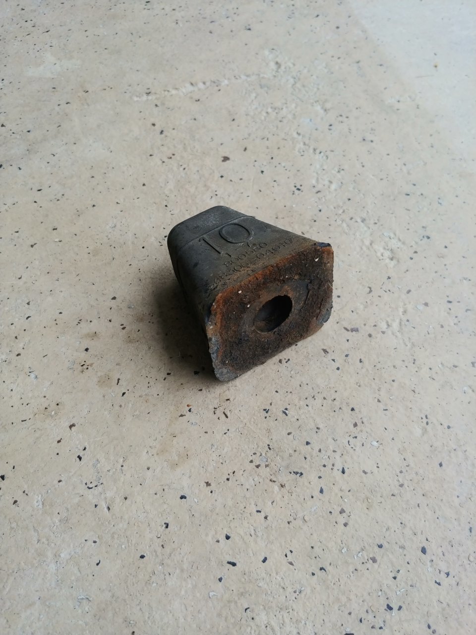

    The rear shocks are done. I only gained 1/4" in ride height which is surprising.
    This long flex head wrench I bought made this job a breeze.
    The only casualtie was my bump stop. Apparently it was hanging on by a thread. Guess I'll be buying those wheelers after all.

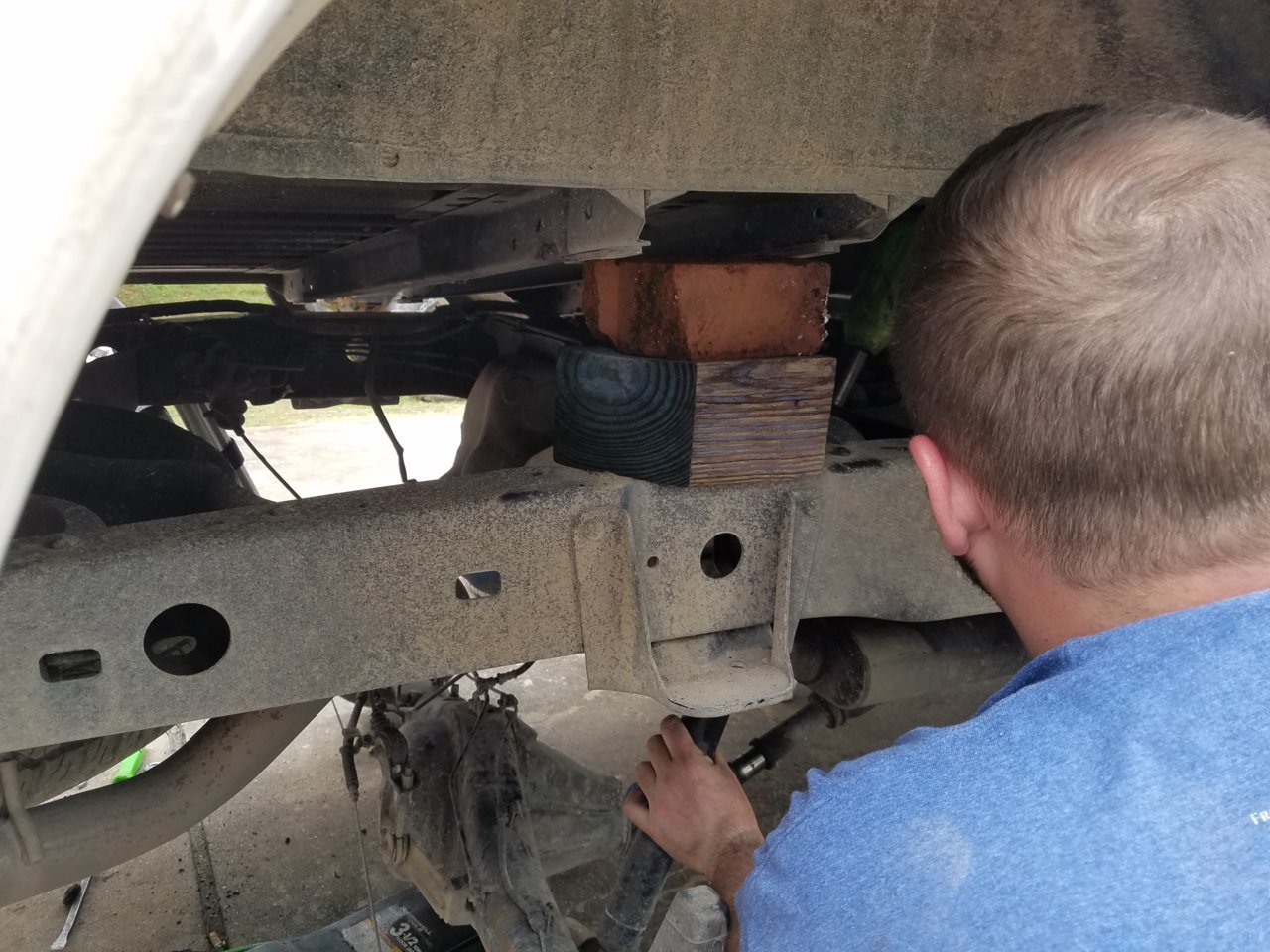

    Had to lift the bed to do mine

    Same reason you ran into. Couldnt get the shocks tight. Had to cut out the old shocks with a sawzall. B
    Unbolt the passenger side of the bed and raise it with 2 bricks to torque the shock down.
    If you do go with an AAL get a progressive one. If you go leaf pack, keep is posted. I'm not aware of any available for our trucks. Plus I heard pairing shocks to custom packs can be a pain.

    Try epoxy on that bump stop.

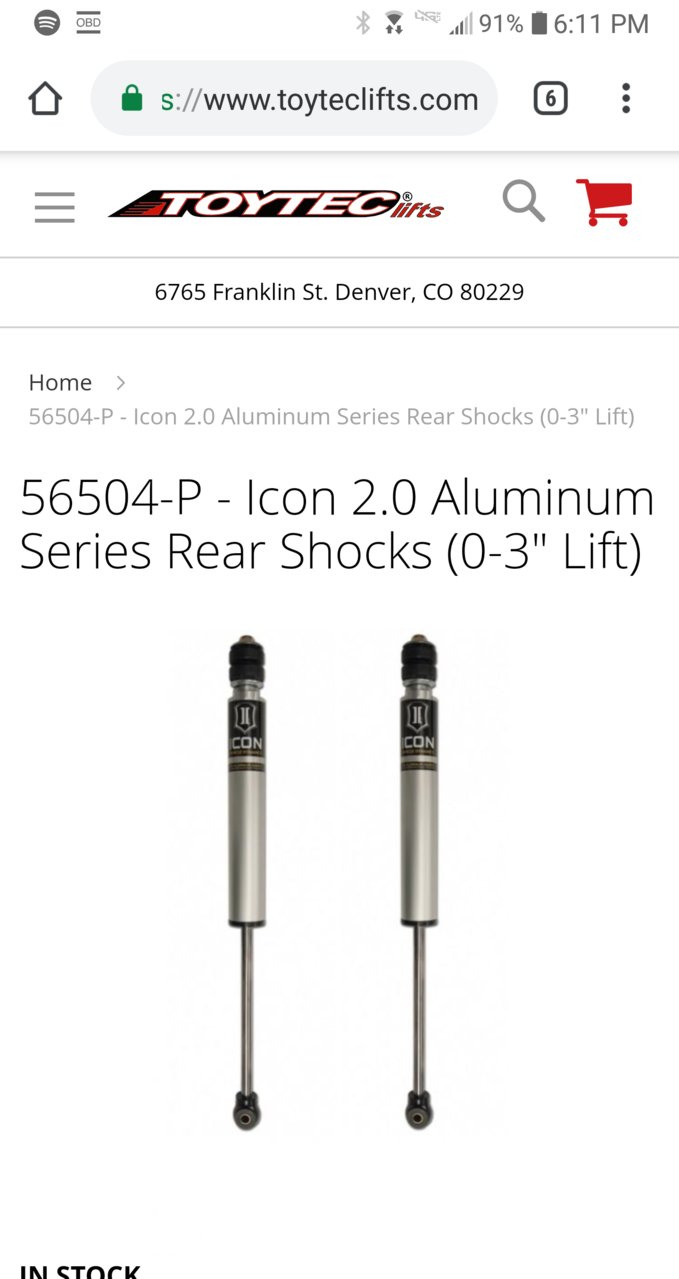

    Well now that I'm checking again it says to expect 0-3" of lift with these rear shocks. Doesn't make much sense.

    You sure it says it'll add 0-3 and not good for 0-3? The second means they have enough travel for lifts up to 3"

    This. It will work for no lift or up to 3" lift but by blocks only. Those are not recommended for add a leaf or full leaf packs.

    The shocks are useable with a 0" - 3" lift. You won't get a lift from them, except I have noted that with high pressure gas shocks, you may get 1/4" or so over your old , sacked out shocks. Not sure it really lasts though.
