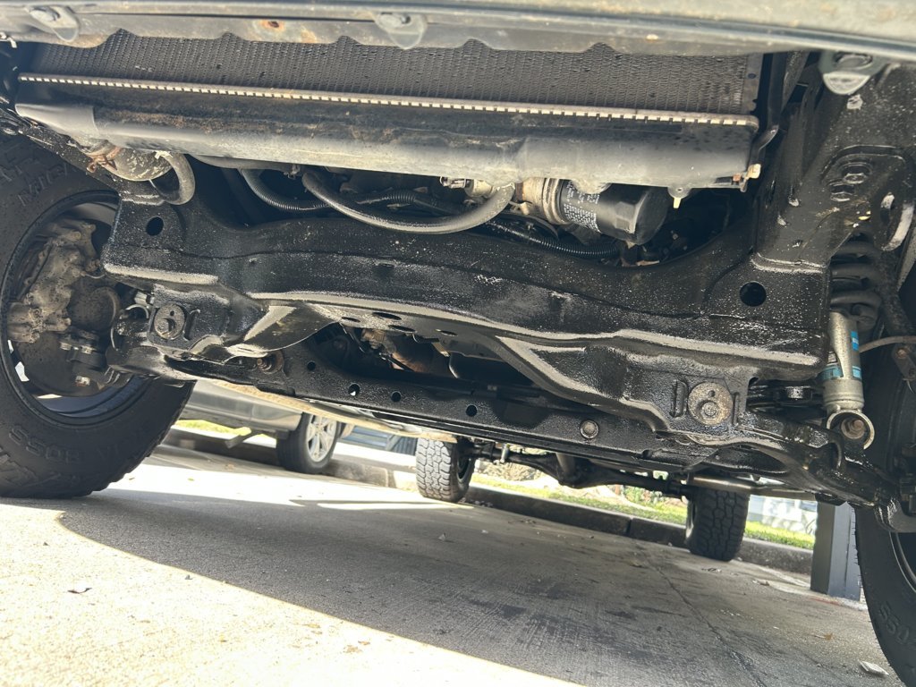

    Gave mine a nice wash yesterday followed up by 3 cans of fluid film to freshen her up. No rust on my watch.

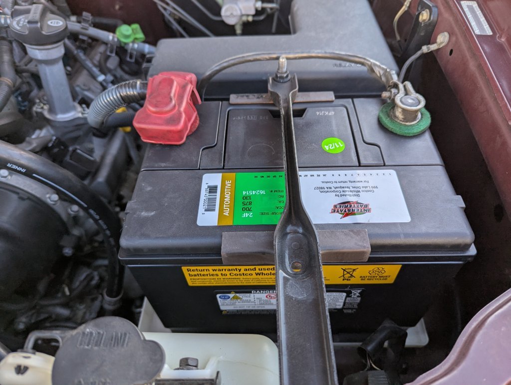

    Replaced the battery. Not sure how old it was but it was slow cranking on these colder days. Also just ordered new spark plugs and and a PCV valve from Toyota, not sure when they were last replaced last.PXL_20250117_185942875.jpg

    Me too. Foam cannon and rinse, then PB Blaster the rear axle and brake bits

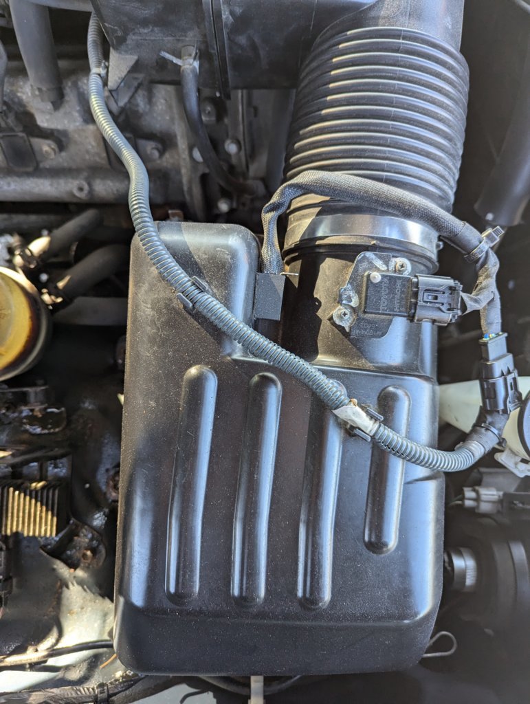

    I wonder if the “magic” behind that kit is just a small inline resistor? At least that what it is for The KTM twin cylinder motorcycles. I remove the SAS (secondary air system) from my ktm 990 Adventure and simply soldered in a 10¢ 2.2k ohm resistor, rather than buying a more expensive premade kit. Then again i wasn’t really doing it to save money, i just wanted less “bulk” hanging off the main wire harness, so the resistor was installed inside the main harness’s loom.

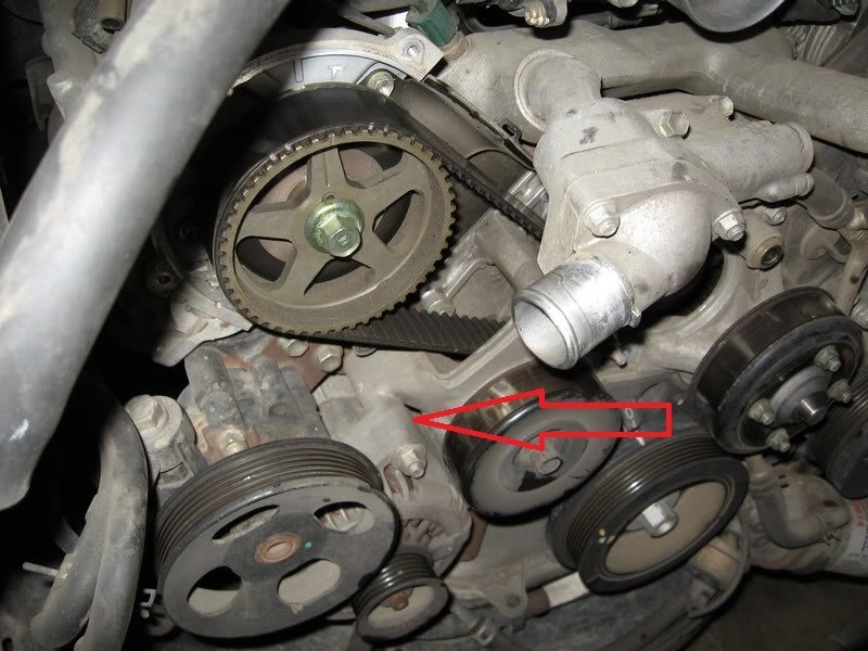

    So, I was driving earlier today and started hearing a screeching of some kind, sounding like belt or bearing. Initially, it would come and go, kinda, but didn’t sound horrible and my power steering was still working, so I figured it was safe to drive the 3 miles home to check it out. Parked and let it cool for a 1/2 hour or so, but when I restarted the truck, it screamed like a banshee. Took a look and saw the belt wasn’t running, so quickly shut her down. Before I get into pulling the belt and checking pulleys/bearings, anyone wanna tell me somethin I don’t know or take guesses what the problem is? Evidently, one of the accessory’s has seized up itself, or has a seized bearing. Not sure which

    Something is stuck bad on your accessories, it shouldn’t be hard to figure it out. It’s probably your idler or tension pulley

    That would be best case scenario. I’m gonna push on the tensioner pulley and turn the crank and see what doesn’t move, I guess.

    To pull the belt, you’ve gotta put a 14 mm socket in the tensioner. Yes it’s a 14. AND it was the tensioner pulley bearing that seized. Looks like I can just pop the bearing out of the pulley. I’ll have to inspect my belt as well, but I think I caught it in time.

    The tensioner is kind of a pain to replace. To remove it, you have to unbolt and slide out the alternator and power steering pump. Plus the timing belt covers.
    Just pointing that out in case you've got any other parts due in that area.
