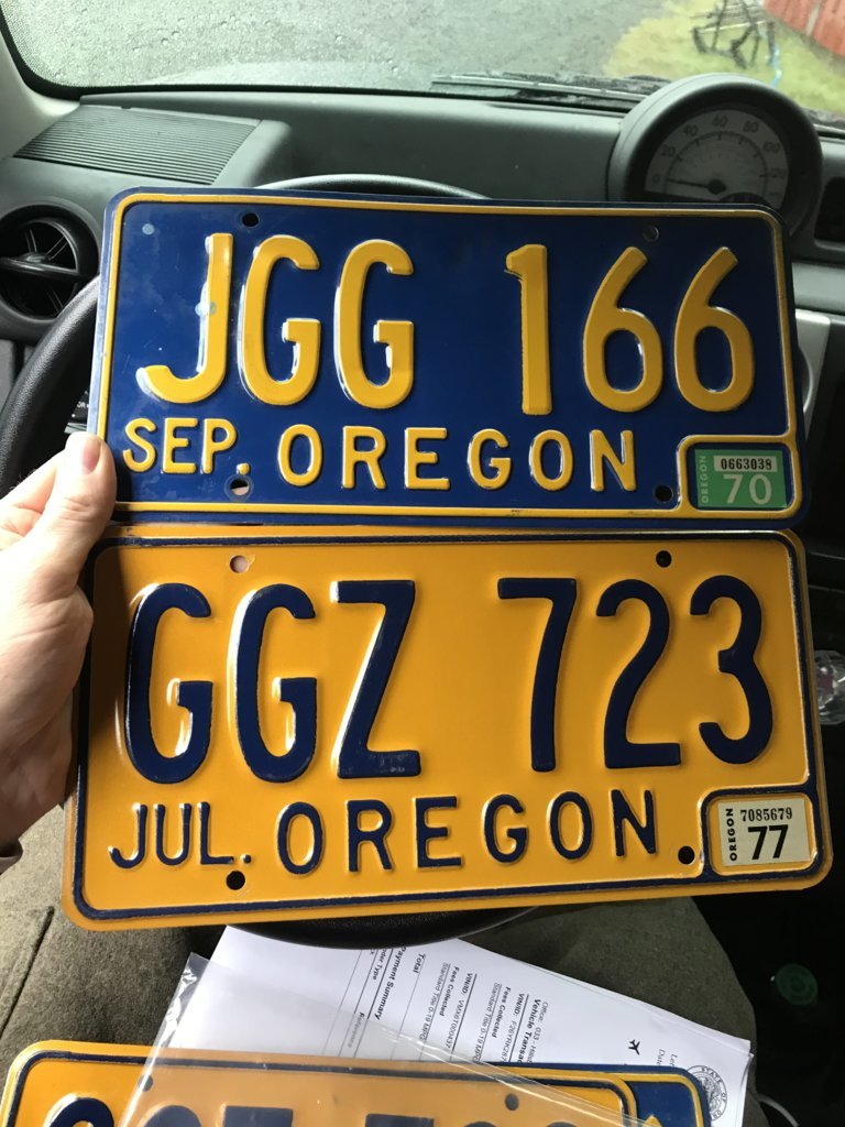

    Oregon has a 25 year rule for Special Interest plates (there is a way to also get a brand new vehicle registered as a special interest vehicle as well, but that takes a lot of doing, and i’m not going to talk about it). Most all my vehicles are registered as special interest, but then again i have a large quiver of vintage vespa and lambretta motor scooters, so those easily qualify. I also have a couple trucks and jeeps from the 70’s and early 80’s that have special interest plates as well. The cool thing about oregon is that you can re-register a period correct license plate to the vehicle you want to register as a special interest. I’ve spent a couple thousand bucks on various used oregon license plates to match the year of vehicle that i own.
    My tundra might be a bit too mundane looking to sneak in as a special interest vehicle? I do have a 2005 ktm 525 EXC that i bought brand new off the lot 20 years ago. I’ll have to wait another 5 years to get a SI plate for it.
    A couple examples of my plates. And i do get to keep the 71 and 77 stickers on the plates too!

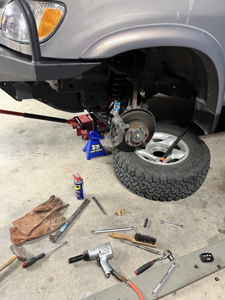

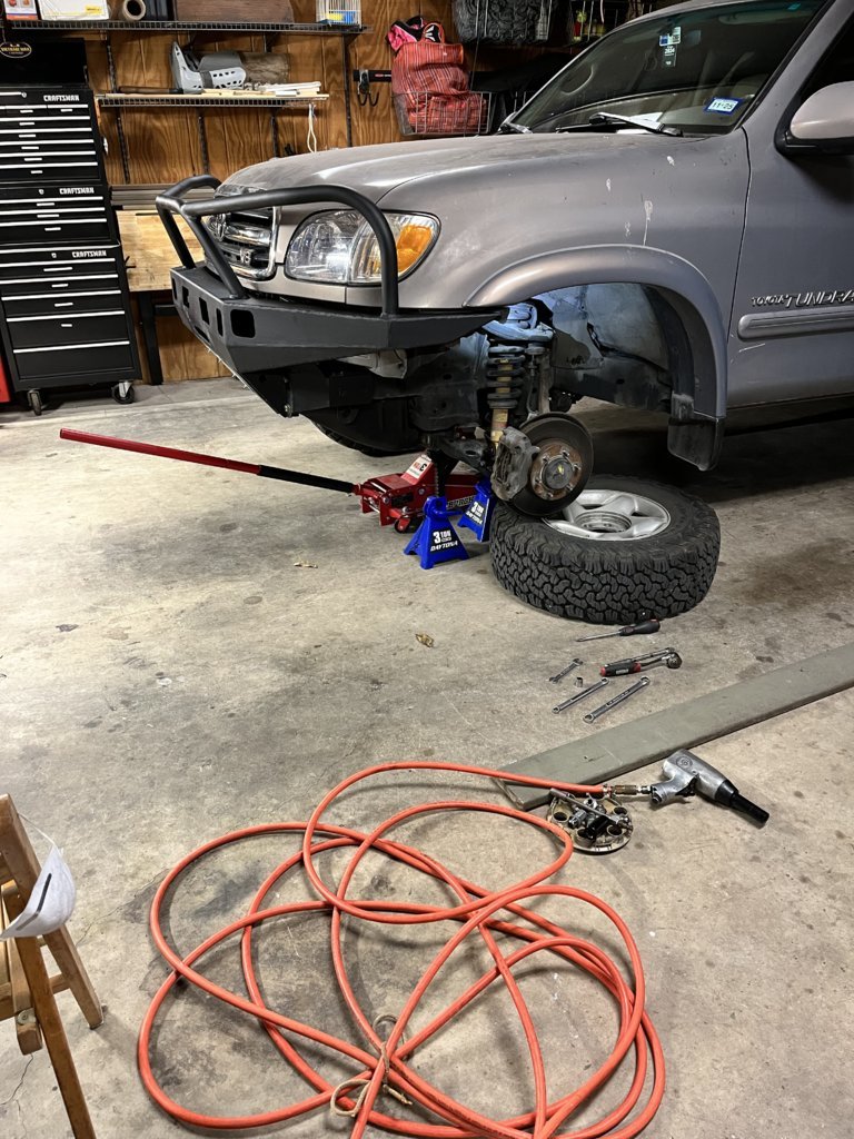

    Changed out the driver side front strut. Thanks to @2006 Tundra AC for selling me his Billstein something or others with some heavier-duty spring. I can’t remember what kind they are but it took some prying to get it to compress a little and go in! Was definitely a couple of inches taller than my stock Billstein struts. I’ll upload some pics when I finish tomorrow. I used a round punch inserted from the front, then a second from the rear while prying up on the bottom of the strut with a crowbar. Once the rear was in, I could pull out the front one and lever it some more to get the bolt in. Was a bear but got her done.

    Tip for future: Take your foot and apply weight on the LCA. Don't use punches or bolts to align the lower mount, you'll scar shit. A properly positioned foot pushing down on the LCA, if swaybar is disco'd, will get you a solid inch or more of adjustment space. Makes it a no-brainer to get the shock mount bolt installed, properly with the bolt head facing the cab so it doesn't shred your CV boot in precarious situations, and you're golden.
    We need pics now, of stance. I feel shorted here.

    anyone posted exactly what needs to be disassembled to swap out a strut? I know swaybar, and possibly lbj but I just got my new assemblies and want to do them as easily and fast as possible. Is it easier to have both front wheels off the ground?

    I thought you couldn’t get the bolt in from that direction without disconnecting the lbj bolts, the cv gets in the way

    Everyone has their own way. I did one side at a time, lifting one side at a time, in my tiny ass garage.
    Regardless how you do it, start by disconnecting the swaybar with the truck on the ground. Swaybar is a limiting factor in vertical movement.
    The other lmiteing factor to UCA/LCA travel is the spindle/knuckle. Obviously, that's held in by the UBJ/LBJ. I'm more inclined to pop off the UBJ than the LBJ, unless you intend to replace the LBJs while you're in there.
    UBJ is easy enough to pop free, pop the cotter, spin off the castle nut, flip over and reinstall the castle nut until it's 2-3mm (~1/16") off the arm and give it a couple of stout BFH whacks, it should drop down. Installing upside down will prevent damage to the castle side of the nut. Leaving the gap will allow the UBJ and the nut will catch the joint from dropping out. From there, understand two things: One, there's a lot of weight on the knuckle (caliper, rotor, the knuckle itself, etc.) and two, The CV axle can get pulled out if the knuckle etc. swings out too far. I kept the OEM bottle jack under my LCA until I wapped a bungee around the top of my knuckle and hooked it to the framerail. If you're worried about the CV axle, you can also pop off its nut and tap it loose, then bungee it.
    If you go with popping the 4 bolts out of the LBJ, which is fair enough and sane, you're going to want to have a 2x4 or something to support the knuckle at the lug studs with a jack, to push the knuckle assembly upward while you work on the lower half. This actually may be the easier way, since it ultimately isolates the LBJ and LCA (with TRE attached) from the upper half; at that point, the TRE will become your limiting-travel point. You could disconnect it if you want maximum movement.
    Standard disclaimer, I don't fully agree with his methodology or practices, but this video does a pretty good job of showing a typical driveway installation of the product at a level I wouldn't be surprised to see a shop use. I definitely don't agree with how he does it all, but some things, like the UCA pivot bolt on the passenger side being impossible to torque as-is ... "it is what it is". Where he shows prying with a prybar, this is where I'd be putting all my weight into the LCA.

    You absolutely can.
    It's super easy if the CV nut is out, then you can just pitch the knuckle outward, tap the CV out, and lift it out of the way.
    If the CV nut is intact, if the wheels are full-lock to the right on passender side, or full-lock left on driver side, the CV is fully free and clear from the nut. At half-lock, I found it was "clear enough" for me.
    I actually ended up tearing back down again (I posted pics on here) because I'm OCD/anal retentive. I know others who do far more wheeling than me installed it backwards though. No issues (yet). But ... it looks pretty clear to me, with the right travel and wheel position, the shank could catch your boot.

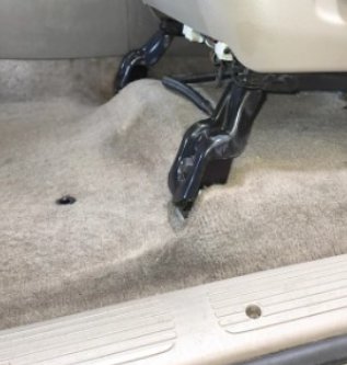

    l) Installed a Desert Does It Seat Jacker on the Left Side. This gives more legroom and a more comfortable seating position. Makes a huge difference in leg position. Helps reduce/eliminate my back pain on a long drive.

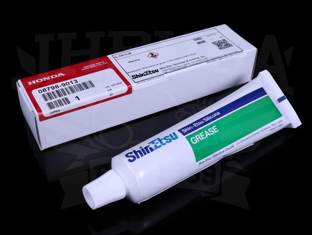

    2) Treated the door gaskets, window seals, windshield wipers, windshield seal with ShinEtsu Grease from Japan.
    This is a thick paste-like material. Rub it on like using a lotion for dry skin. It rejuvenates dry rubber. It contains active ingredients that make the rubber plump up. The truck has less wind noise entering the cabin.
    I do a lot of deep water crossings. This is a must to keep water from entering the cab.

    I'm curious if the uncomfy seat thing is just a manual/non-power seat thing. My power seat seems like it's able to adjust out to where it gives more lift than what I see the non-power seats get. Lower the ass-end of the seat, raise the front, then slide it back, and I'm golden.
    On that product, I ended up buying some Gummi Pflege Stift which seems to be similar and does same thing?

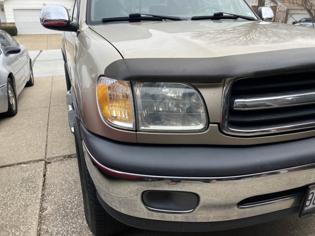

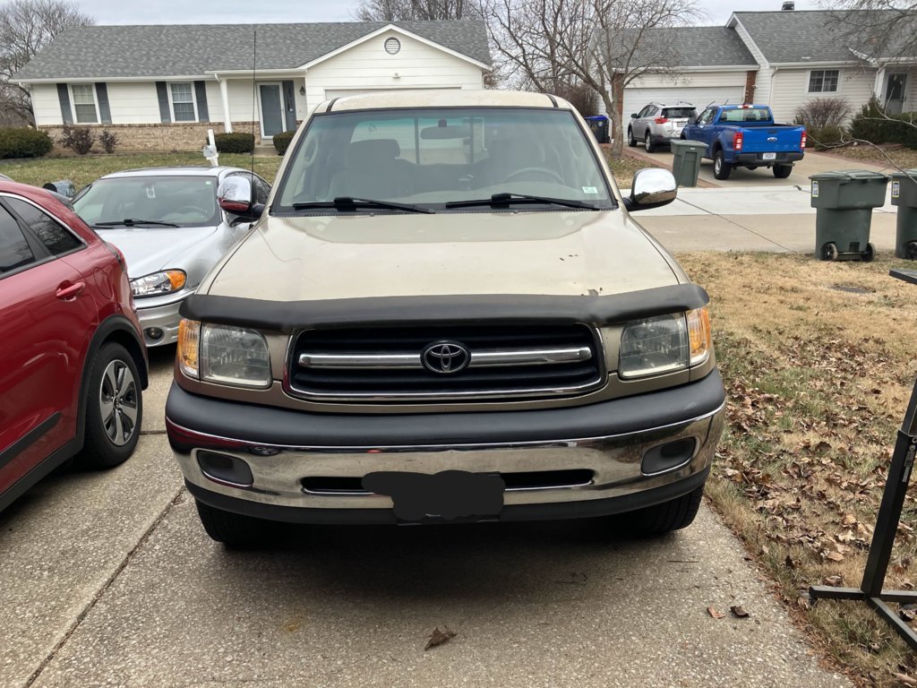

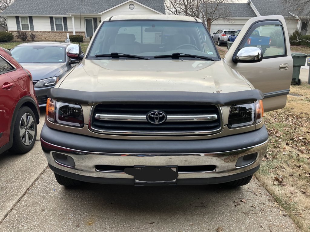

    Tried the LED projector, high beams were weak, and the lens kept fading, so I decided to "upgrade" (saw these on the FB group). Next is foglights.Old full.jpg Old zoom.jpg New zoom.jpg New full.jpg

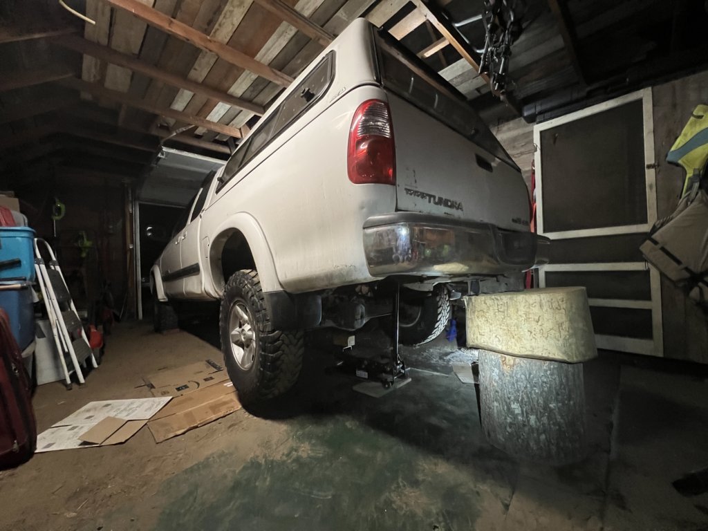

    It sure gives you a lot of room to work when you lift from the hitch and let the suspension sag. How’s my two stacked stumps measure up on your list of sketchiest jacking jobs? Haha

    Way sketchier than @Sirfive 's. Top 5 most sketchy I think. LOL

    I couldn’t find a pic, but I had seen one guy with his truck on cribbage and sitting upright underneath working on it

    It’s looks awful, but it was surprisingly stable and about as safe as I could make it with my space and equipment constraints. Fronts chalked and in 4x4, hitch centered on stumps and I tried rocking it front to back and side to side before going under, it wouldn’t budge. I was swapping the leaf springs so the rear axle stands I used wouldn’t have stopped the truck from falling/would tip over. I had to use the lift jack to raise/lower the axle into position and couldn’t keep it on the frame. I wish I had jack stands tall/strong enough for the frame but with an uneven dirt surface I wouldn’t have trusted them anyway. I guess all I’m saying is that I don’t have a death wish and think safety is good, it’s just funny how my safest option ended up looking.
