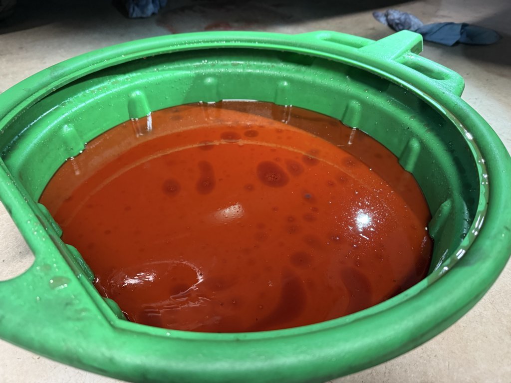

    @FirstGenVol and I got down and dirty with my radiator today. 203k on the clock, maybe 80k/6yr since it was done last. It was leaking at a decent rate and seemed to get down to a level even just sitting, but definitely leaked while running.
    Not sure if I was on the verge of pink milkshake….or what the reason for this discoloration would be.
    Also had a weird experience with the coolant draining slowly. Then suddenly what seemed like a blockage cleared and it poured out without issue. Cap was open whole time. Not sure reason for it.
    After we topped it off monitored temps. Hit just 186.5 or so maybe three times the whole 16 mile drive back or so. No leaks, no drop in coolant on the reservoir. Thinking we nailed it, just questioning if I was headed to pink milkshake territory.
    Might do an ATF drain and fill next just to be sure. Last one was about 53k miles ago (150k).

    Pink milkshake isn't from old coolant but a leak between the cooling and oil system. Did you get a look at what those discolored blobs were? Also are you saying your cooling system was leaking (losing coolant) and if so did you find a fix the source of the leak? Looks like maybe you replaced the rad that was leaking and avoided the shake?

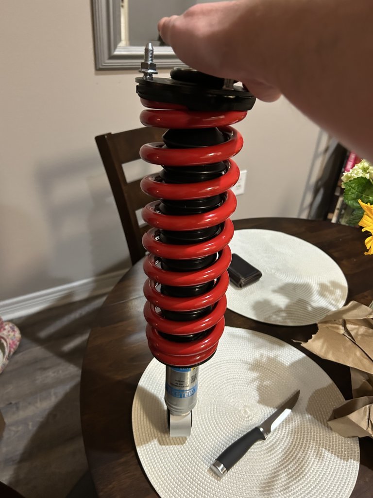

    Got my suspension in today. Dobinson coils, 5100s bottom notch

    Is it possible the floaters you're seeing are residual shit that was stuck in the nooks and crannies of that catch pan? It seems small/insignificant.

    Replaced the radiator and thermostat today. Radiator itself was leaking. Hoses were newish, so kept those for now.
    Not sure what the discolored blobs were. Thinking maybe I was headed to pink milkshake territory, given the boobs and leak. Planning ATF drain and fill to be safe.

    Maybe, I didn’t inspect the catch pan or not sure if it’s crap that fell off the body as coolant drained from a hose or thermostat area. Though knowing @FirstGenVol that catch pan was clean enough to hold the salsa for our quesadillas.

    The pan should have been clean but I know a little ATF dripped in it when we removed the trans cooler line. The coolant color just looked off. I noticed if first and didn't say anything. Then John pointed it out. It honestly looked... Kinda milky? The last few times I drained my coolant both on the truck and the Rav, I don't remember it being that color. :notsure:
    His transmission hasn't blown up so I'm assuming he's good.

    Definitely looks cloudier than I'd like.
    Did you guys only open the petcock on the radiator, or did you open the block valves also?
    After seeing others complain about slow/no draining from the drain blocks due to blockage, and hearing about the no-flow/plonk/good-flow incident that happened, it had me thinking.
    How much coolant came out?

    I will double check tomorrow but something like 1.5 out and I wanna say closer to 2 in? It was leaking and low from the drive to his place.
    Only petcock was opened.

    Wonder if @shifty` is right and the blobs were leftover oil in the catch pan? If really wanting to clear the transmission consider an ATF flush.

    So did you flush the coolant. If not there is a bit left in the block that would mix back in.

    I'm pretty sure our trucks hold closer to 3gal of coolant, there's another ½-¾ gallon
    (EDIT: or more) in the block...

    I’m kinda scared to mess with the block cocks when I drain mine, but I will do a distilled flush that would be hand model certified

    DC is 11.3 imperial quarts is 3.4 gallons. You only drained roughly half, it sounds like.

    We did not drain the block this time. Just the petcock. The last time we opened his block drains we had issues with one side continuing to leak for a while. We'll be draining the system again when we do his timing belt job. Can't wait to mangle more shit on his Ridgeline.
