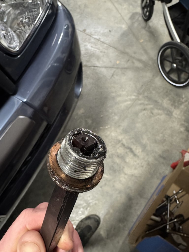

    So is one the fill plug then?
  11. Dec 16, 2024 at 3:16 AM
    w666
    w666 D. None of the above
    Dec 17, 2019
    #40020
    2,015
    Maryland
    04 Access Cab SR5 V8 4WD
    Yes, fill and drain. Use search...there's dozens of posts about it here
    des2mtn and shifty` like this.
  12. Dec 16, 2024 at 3:42 AM
    455h0le_dachshund
    455h0le_dachshund NO MASTERS, NO CHAINS
    Nov 21, 2023
    #107257
    10,292
    Coastal TX
    Penelope & Elvira
    My confusion lies in why the fill was needed. Iirc the fill plug is already hexagonal, it's the drain that's a stupid Allen key. Also those appear to be for the 8" front diff. Will those fit our 7.5" front diffs?
    Reason I ask is because I have a second gen tacoma hexagonal magnetic drain plug in my possession (8" front diff) and I never actually tried it out because I was told it wouldn't fit.
  13. Dec 16, 2024 at 4:20 AM
    w666
    Dec 17, 2019
    #40020
    2,015
    Maryland
    From the factory both the fill and drain plugs are 10mm allen. If you already have hexagonal for the fill then it's already been changed

  25. Dec 16, 2024 at 7:08 PM
    Kimosabe
    Kimosabe Slacker
    Jul 28, 2020
    #50004
    1,542
    Sun Valley, Idaho
    23 Tundra Crew Max Limited TRD 4WD
    W.I.P
    To follow up on my previous post; most of you know how satisfying this feeling is. Needle bearing swapped to bushing, oil seal replaced, new front diff fluid, and so far no leaks.
  26. Dec 16, 2024 at 7:21 PM
    shifty`
    shifty` Do some sister twisters 'til the cows come home
    Jun 20, 2020
    #48239
    35,817
    ATL
    '06 AC Limited V8/4WD
    Congrats!
    Kimosabe[QUOTED] likes this.
  27. Dec 16, 2024 at 7:22 PM
    Sirfive
    Sirfive Socially feral
    Jan 24, 2021
    #58078
    6,537
    SATX
    Roxanne
    Bassani cat-back
    Those square extractors are the only ones i've ever used.
  28. Dec 16, 2024 at 8:25 PM
    Kimosabe
    Kimosabe Slacker
    Jul 28, 2020
    #50004
    1,542
    Sun Valley, Idaho
    W.I.P
    That’s my first time using one. I still think I’m going to buy the Irwin extractor set for future issues, but that sucker worked well.
  29. Dec 17, 2024 at 3:12 AM
    BroHon
    BroHon Mew Nember
    Sep 19, 2023
    #104169
    3,721
    2000 SR5 AC V8 4x4
    :cheers: That's awesome.
    Bushing: Did you try my cut off axle tip for the install portion? Just curious if it worked as well for you as it did for me.
    That bronze bushing killed 95% of a 25-40mph vibration I had.:thumbsup:
    FrenchToasty likes this.
  30. Dec 17, 2024 at 9:18 AM
    Kimosabe
    Kimosabe Slacker
    Jul 28, 2020
    #50004
    1,542
    Sun Valley, Idaho
    W.I.P
    I did use it. I used both honestly. Thanks for adding that to the kit.
    I made things a little harder by not removing the skid plates before removing the bushing. So the axle stub worked well being a little shorter and allowing me to get a longer swing with the hammer.
    FrenchToasty and BroHon[QUOTED] like this.
