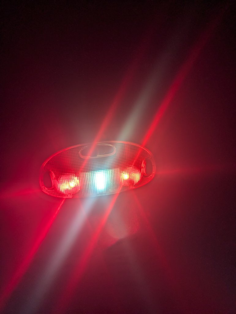

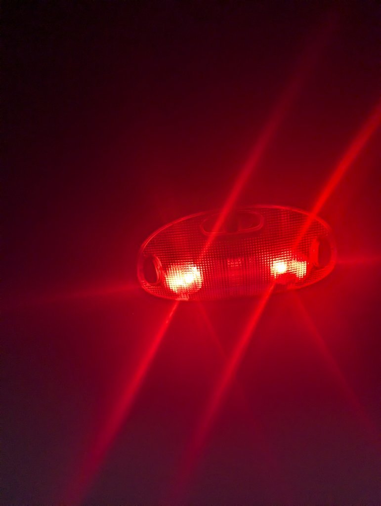

    I watched a video about Meso customs making an overhead dome light with an integrated board with both white and red lights for the Tacoma to keep your night vision. Thinking about a simple "poor man's " solution for the Tundra, the DC has T10 bulbs on either side and then a main bulb in the center. This center bulb is turned on when the doors are opened and the side bulbs are only on when pressed. I got a 2 bulb-pack red T10 LEDs by Lasfit from Amazon for $10. The hardest part was getting those OE glass bulbs out. I wrapped the bulb with blue painter's tape and then pulled out with a small hose pliers.
    PXL_20241215_194733940.jpg PXL_20241215_194809162.jpg PXL_20241215_194842887.jpg PXL_20241215_200124326.jpg PXL_20241215_200132138.jpg

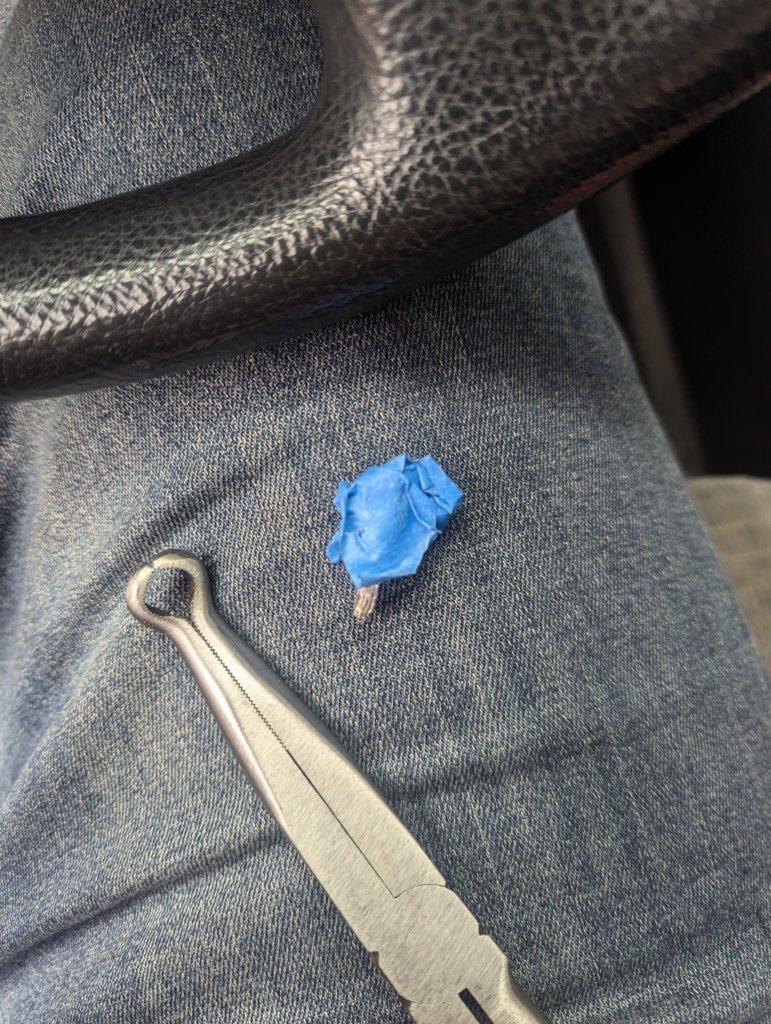

    I managed to replace my needling bearing with the ECGS bushing. Huge thanks to @FrenchToasty for the loaner tool. Made the job easy.
    Only problem is when I went to drain/fill the front diff. Fill plug came out pretty easily. Drain plug did not! I decided to commit to the job and after stripping the drain plug I started drilling. And I am left with a drain plug with a drill hole in it while I try and get a screw extractor kit big enough to get it out. Hoping I can get one in town, but I preemptively ordered one just in case.

    Don't use an extractor. They're meant for broken screws not seized. You break off an extractor then you're really in a world of hurt
    Hit it with some heat and then a chisel/hammer or an air chisel

    The best way would be to weld on a nut, then hit it with an impact. Then go buy the Lexus upgrade plugs - lexuspartsoutlet.com

    Gah. This times 1,000. Made that mistake on an exhaust manifold for a '92 Civic HB. Managed todrill on two sides of the extractor, and fish it out. Took almost an hour. Then enlarged the hole. Used larger extractor. That MF'er broke too. I said "FUCK IT!" and gave up. Decided not to bolt in the nice, polished SS aftermarket exhaust manifold I paid $275 for. I was in my 20s at the time. Man that sucked. I bet the new owner was cussing me when he bought the car, but he told me he'd be replacing the engine anyway, so I didn't think it was important.
    @Kimosabe if you don't have a welder, you may consider slotting it to the point you can get an allenhead in there and turn it.

    I tried heat and penetrating oil and a hammer. A couple rounds of each. No luck and so then I drilled into it in hopes the heat and thinning it out would help. Then used a larger Allen head socket. Still no luck. Sadly I don’t have a welder so I’m gonna try one of these which should do it.
