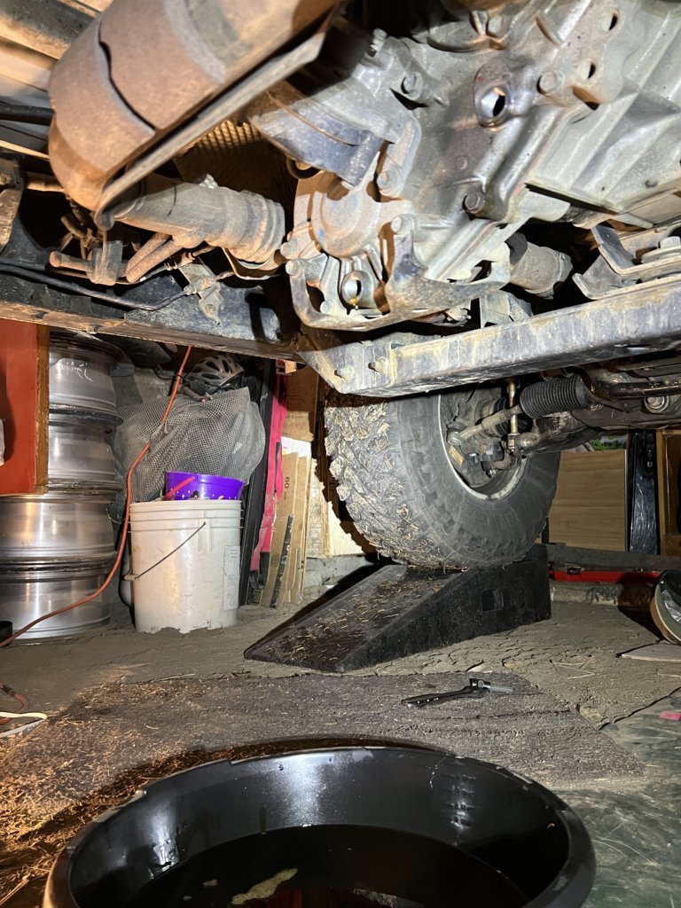

    Today I drained my transfer case fluid. I have not refilled it yet because I found two identical plugs, isn’t the lower one supposed to have a magnet? Didn’t want to waste more time under here searching the Internet so I thought I’d just ask

    The transfer case is not equipped with a magnetic drain plug. Thus, the drain and fill plugs along with the crush washers are the same part #s for both.
    The front and rear diffs have magnetic drain plugs.

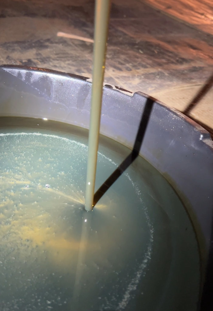

    The 10mm Allen I bought was too long to open the front diff so I didn’t get to that today. Transfer case fluid looked great, found old markings dating the last change at 22k ago so probably unnecessary but I already had the oil. I don’t have any frame of reference for what the rear fluid usually looks like, but it sure seemed sparkly to me. Had a decent little puck of metal dust on the magnet with a few small larger bits. The bolts were rounded so I know it’s been changed at least once before, should I be worried?

    Color-wise it looks almost identical to my front diff fluid, which I believe (in all likeliness) had never been changed in the truck's lifetime, which was only around 72k miles then IIRC.
    https://www.tundras.com/threads/wha...-gen-tundra-today.2558/page-1549#post-3084622
    I show all 3 in that reply. Magnet smears are in the reply after that, both of mine had a good bit of sludge with mild glitter. My TC looked almost as if it had brand new fluid in it. I assume it's typical for unchanged front diff fluid, or maybe the PO never really engaged 4WD much? Front diff fluid had to've gotten that way ... somehow. I have yet to find someone with a 4WD, low-mile, front diff fluid never changed in order to compare.

    Next time it'll look better. Differentials seem pretty strong, you've really got to abuse them, or abuse them in very specific ways, to cause real issues. That is a lot of metal shavings, but I've always heard that generally if there's no "chunks", you're in good shape.
    T-case looking brand new seems common. I changed mine, and it hadn't been done for something like 70 or more thousands miles. Looked brand new.

    The dirty rear diff fluid is sort of unusual IF it’s the 2nd time changing. Looks a lot like my first and I bought mine new. 75k miles and 3 years later it looked like that with some magnetic metal residue. However the fluid wasn’t shiny with specs of metal on it. Seems like you have more than I did.
    All subsequent changes have been relatively clean fluid for the rear diff at 150k and 225k miles. It makes me wonder if Toyota put some type of conditioners in the fluid for first time use to get that dirty.

    Rear diff fluid gets beat on the most. Always funky and dirty when I change mine, granted I only change it every 75k miles or so with full synth stuff (no LSD). I tow a lot though. And heavy.

    When ive done mine I have more sludge, less metal particles. I do mine every 15k. Is that metal in the pan from other services? Or all from your rear diff?

    I wouldn't be overly concerned; not unusual. I'd just run it for several miles, then change it again to optimize cleanliness.
