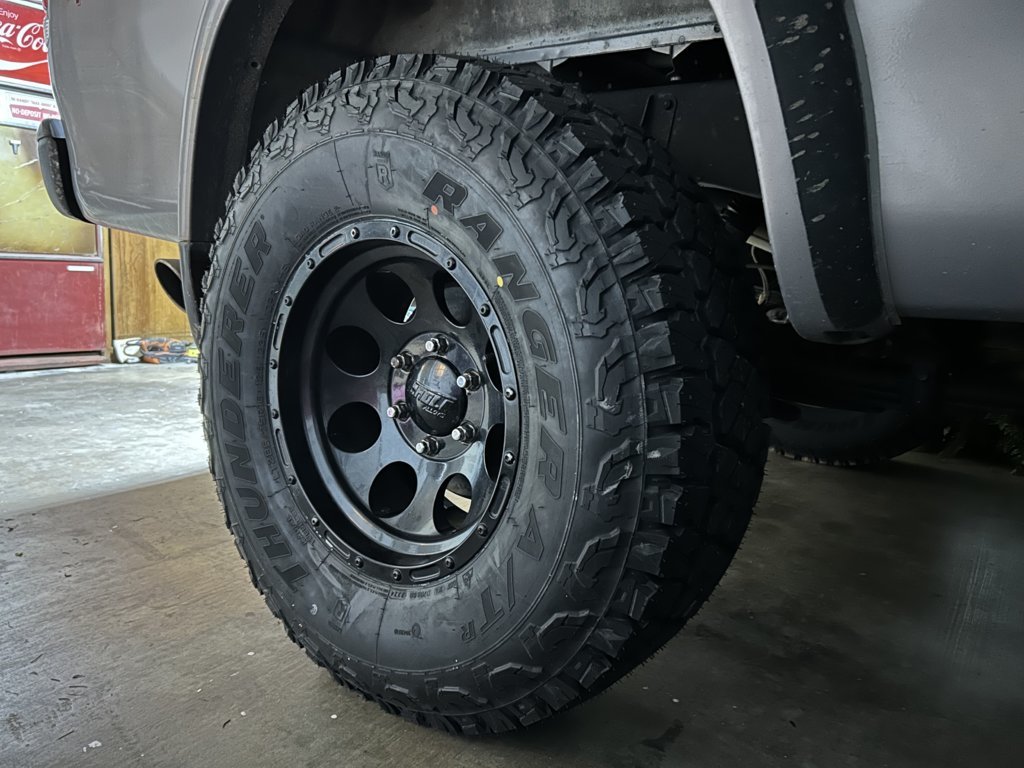

    I'm gonna cut to length plus the small lip. Then bend 4 small tabs around the lip of the cap so it seats in the wheel. Then use a hammer to flatten the lip into the groove in the back of the rim.

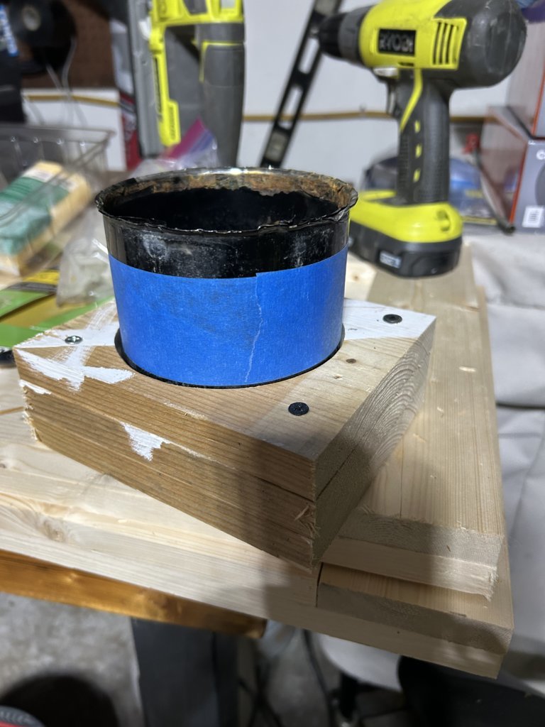

    Think I'll make a jig out of wood that the cap can rest in with a stop for the top of the cap and a groove for the blade to cut so they have some uniformity.

    A touch shorter than I planned on, but close to the flush look. My lugs stick out more than the other wheels with flush center caps, have to look into options there.

    That turned out great, I like that nearly flush look :thumbsup:

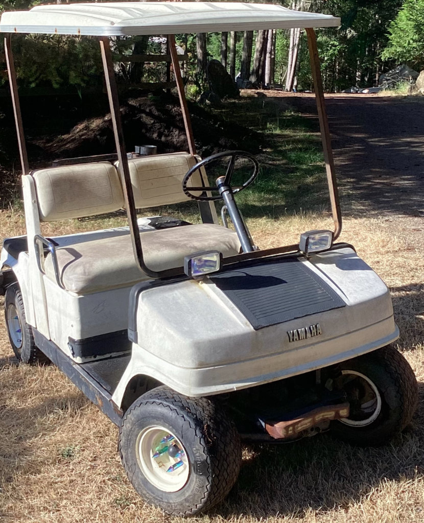

    Like these bad boys (sorry, no close up)?

    Boom. I already own that golf cart too. Yamaha G2 (Edit: you are correct, this is a G9)

    Nice. That was Phyllis, a G9. It was a beater that I treated as such, but it was a fun cart. I sold it and got a CC Precedent mainly because I wanted an electric cart.

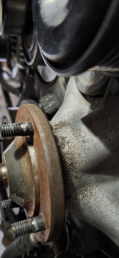

    Noticed a slight change in sound coming from the engine compartment while at idle. Popped the hood when I got home and discovered the fan had a slight wobble. Upon further inspection, I found very fine metallic dust on the fan pulley bracket:

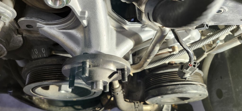

    Bought a new OEM one and replaced it. That's an expensive little part.

    For sure. I caught it at the warning stage. I'm sure it would have been howling in due time. I'm a bit of an oddball in that I don't listen to music, etc., when I'm in the truck, so I'm pretty well attuned to any changes in sounds it may make.

    What's your mileage? I know that when things finally give can vary widely truck to truck, but when I had a mechanic do my timing belt/water pump job, he found that fan pulley was a bit loose. Not terrible, but one of those "I'm holding it in my hand right now, do you want me to go ahead and replace it?" kind of deals. That was at ~230,000 miles.

    My bearing bracket had a wobble. At higher rmp the (old) fan would flex and strike the coolant inlet. It also made a hell of a WHUUURRR at about 3-4k rpm.
    I let it go too long, stomped the gas one day, and the fan exploded and took out my radiator with it.
    I actually thought it was just the fan, until I got everything apart and spun the fan bracket all by itself.
