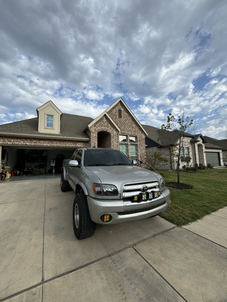

    Hey @khooiii,
    The lighting set up is looking dialed. Have you been able to take it out to any local trails to test out the lighting package?

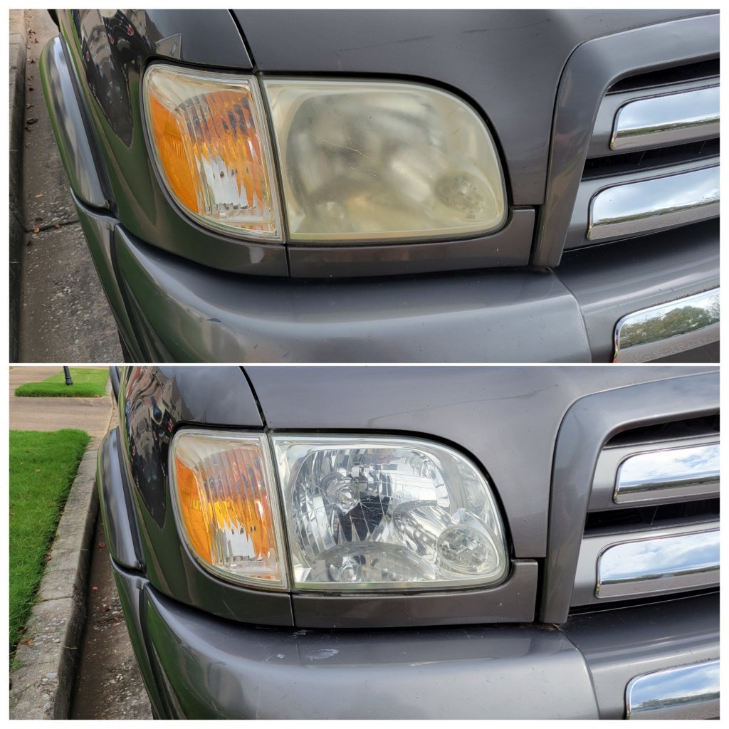

    I had a nightmare experience with a neighbor’s car I was refinishing this week. I’d already sanded out (600/1200/2000/3000) polished, and sealed their headlights once in 2022. They were starting to haze, their car sits in the sun all day long. So I decided this time I was going to use clear instead of a sealer.
    I have a few packs of the 3M wipe-on clear, so I decide to start with those.
    I cleaned really well, then used Duplicolor Paint Prep spray on them. BIG FUCKING MISTAKE. That shit melts polycarbonate lenses, apparently, similar to what DEET spray does.
    So I resand, 1200/2000/3000 again to get down to good plastic. Clean with IPA. Let it sit up for a bit. Use the 3M wipes. Never had this happen with them before, but I get streaks. Wtf. Do the 2nd coat. Still streaks. Aaarggg.
    Wait ‘til the next day for the clear to harden. Resand again, same 3 grits. IPA to prep, let the lenses totally dry out. Then pull out the remainder of my can of AutomotiveTouchup.com clear, which had enough in it to do both lenses 4-5 coats,10min interval per directions. Lay three mist coats. All seems ok. Plan to lay two medium coats. Lay the first, about 10 mins in I see one small spot cracking. FUCK. Wait still, it doesn’t get worse, so I lay the last medium coat. More cracking. Maybe it’s not plastic compatible? Wtf? Want to correct on the fly, not sure how but have acetone and lacquer thinner. For shits n giggles I tried one on each, little bit better, but hazed the paint elsewhere. Shit.
    Next day it’s hardened off, try to wet sand buff it out, but it’s useless. No dice, cracks obvious. So I did all the same shit from my last paragraph but went 600/1200/2000/3000. Let the lenses dry overnight this time, after cleaning with IPA. Take a brand new can of Duplicolor clear Lacquer that is definitely plastic compatible. Lay down one mist coat. Start to lay down the second within interval time. On the third, after 5 minutes THE SHIT IS CRACKING AGAIN. I was PISSED.
    I had to give the car back the next day so I said screwit and stopped.
    Next day I wake up at 6:30AM and start sanding, 600/1200/2000/3000…… AGAIN. Dammit.
    When I got to the end of sanding I polished with Novus 2 & 3, then finished with their sealer, twice, and gave the damn car back.
    I still have no gd clue why in the hell the clear kept cracking every time I laid down multiple coats on these lenses. They were 15yo factory originals. I told them they should buy new housings (again, I told them last time I polished but they were paying, and I need money, so…)
    Hopefully turns into another $100 for labor on a housing swap but we’ll see.

    No trails yet, but I’ve blinded a couple people for fun haha.

    Dang! Even the Meguiars "Heavy Duty" kit just comes with 1000/3000 plus the PlastX polish. You earned every dime of that labor charge. I'm guessing your 4-step process yields incredible results, but the Meguiars kit has always been satisfactory for me. I love Novus polish! I discovered it when cleaning up one of the old MacBooks with the white plastic case.

    They look nice, Like :thumbsup:

    I'm a prep junkie when it comes to refinishing. I can't help it. But, yeah, probably about 4 hours into those things. If time was money, I definitely lost money on the job, but I couldn't send that off with all the clear craquelure, knowing their kid may be driving the car at night.
    Novus is great! I use it to refinish acrylics, found it when I was pretty deep into restoring vintage turntables, used it lots to restore lids. Stuff is awesome! Weld-on 3 or 4 for any cracks, then buff and polish any haze and residuals (and scratches) out w/Novus, 3-step kit.
    The 3M headlight kits also come with just a 1000 and 3000 hook and loop disc, and their clearcoat wipes. I've used those wipes with pretty good results in the past, not perfect, not glossy like it came from the factory and I've never seen it haze, nor have I seen clears crackup like this, although I found a bunch of pics of similar online, clearly other people have had this problem.
    Honestly, knowing time is money, I don't know if I'll ever polish another set of headlights as long as I live. With how inexpensive it is to get new decent, CAPA-certified housings, it's almost stupid to bother, unless you have a super rare car, or you need to tear off the entire front end to swap out the housings.
