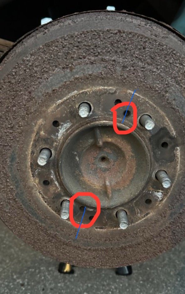

    Yup, I posted about that one in here somewhere. Hell if I remember where, but I found that same damn issue at one point, I distinctly have a foggy memory of it, and that's usually always right at least 40% of the time.
    Holup, I think I posted about that too, but if not, I've got the bolts readily handy downstairs. It's a common thread pitch. I had about half a dozen in my random bolts tray from project cars over the years.
    That said, feed both in till they bottom out. One full turn per bolt, alternating, until it finally breaks free.

    Anyway, went into my bolt tray and the 4 bolts sitting on top of the pile from when I relubed my rears recently are 3/8-16 coarse, which just so happen to also thread nicely into 10mm x 1.5 so I'm assuming either will work fine. I would also assume the latter is proper, metric, and the 3/8-16 isn't actually intended, just happens to work.

    Thanks, Shifty. Apparently it’s not in the FSM. Strange.
    I’ll pickup a couple of those and some M8x1.25 since I see that listed by others on TS.

    TS definitely says M8 x 1.25 It's possible I never put the bolts I used back into my bolt bin. I definitely had a couple of M 8 x 1.25 next to it, but there were more M10 x 1.5 in there so I assumed that's what it is.
    You only need two, so ...

    I think my problem may be the edge of the shoes catching the rust lip at the back of the drum. In which case, I’ll need to back the shoes off a bit.

    I should’ve mentioned this in my earlier post:
    I cracked one of my drums alone the blue line when trying to remove it. I think the same thing happened as you mentioned- the shoes were caught on the edge of the drums. Whacking them with a hammer helped.

    I may not have to take them off to see which direction to tighten. IIRC, trying to loosen causes issues with the tab you need to push back and doesn’t happen smoothly while tightening has no resistance. The FSM is a little confusing with the drawings.
    I figure I’ll just tighten enough to feel the shoes drag against the drums when rotating with the wheel off.

    Have you got them off yet? FR is on the right path. The loosening sequence does seem strange, but once your getting them set, you want the wheel on to feel the grabbing force of the brake drag, and then go 2 more clicks

    Cool, thanks. I was concerned about going over and having to loosen which I recall being a PIA getting that tab pushed back.

    Seems like you've got it but just for reassurance's sake, the holes on my '06 are for sure M8 thread, and you are spot on that there is a lip on the edge of the drums that will require the shoes to be backed off a bit to allow the drums to come clear.
