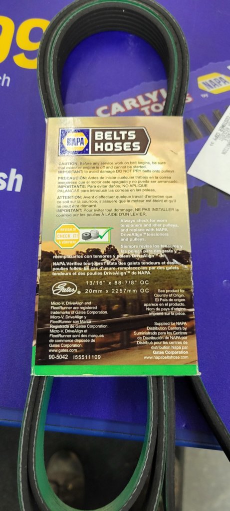

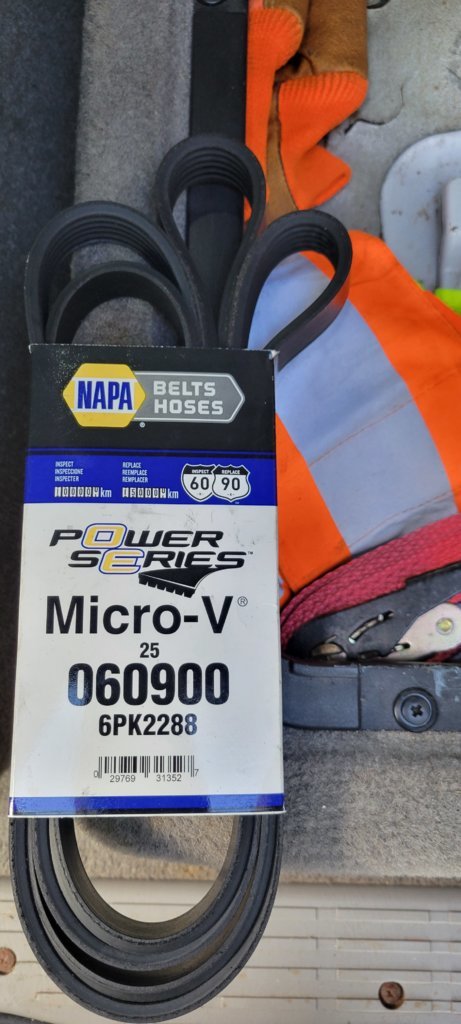

    New serpentine belt today to end the insane squealing.
    Trusted the NAPA site to recommend the correct one, mistake.
    Wanted the nice green Gates, but oh no, that's way too short. 88 7/8"
    So I decided to go with the NAPA brand for almost $20 less and get it done Today. 90 1/2"
    Picture is the squealy belt getting tucked away as a spare.
    Glad to have silence once again!
    What size belt is standard? I looked online and I saw several 90.2" references.
    Tensioner bolt head was 13mm, that seemed odd as well.
    EDIT: This was my screw up. When shopping it didn't have a designation for with or without A/C, it was down in the fine print on the belts details. Which of course I didn't read. I was in a hurry to get it done today:bananadead:

    you have A/C? Rockauto says the gates is 90.7", continentals are 90.5-90.7, the dayco was 90.75. The AC Delco gold Gates is 2319 mm.
    w/o A/C is about 2ish" shorter.

    Yes, the A/C pump is still present, the rest of the engine bay accoutrements have been gutted out.
    I see now that the 88 7/8 is W/O air :facepalm: that's where MY Eff up was (fine print down in the page). This was the one they could get Today.
    So the new one I have now (90.5) is just 3/4" shorter. We measured the old belt and they matched it.

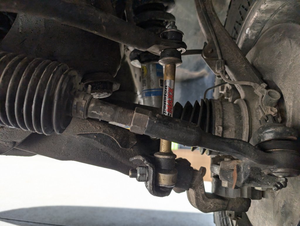

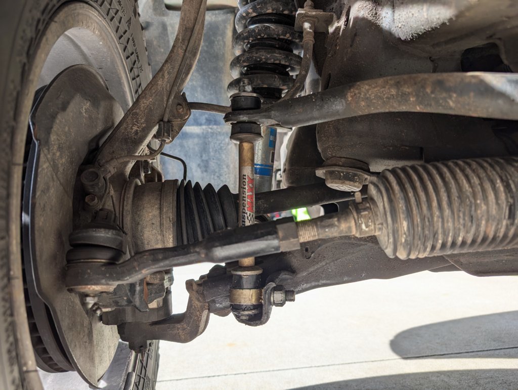

    I picked up the replacement steering rack boot today. Backstory: driver's side boot needs replaced, and according to the epc-data.com site and associated parts breakdown, it is part number 45535 - funny thing though, when you click on the link it takes you to 45536-0C010, and likewise when you click on the passenger boot labeled 45536, it takes you to 45535-0C010. Ha, I found a problem with the linking, good thing I caught that! Ordered 45535-0C010. Surprise! The links must have been right and the image is wrong, because 45535-0C010 is 100% too small for the driver's side and thus I got the wrong boot, but the right clamp. Ugh! The part I received is even labeled in my order confirmation "steering rack boot #1" but apparently #1 is not the driver's side.
    After I removed it though I found a second hole, so at this point I have to assume the other side has a hole of its own or will soon, so I'm ordering the opposite boot/clamp to complete the set and will just replace both sides, no harm done. Just another 1-2 day delay now.

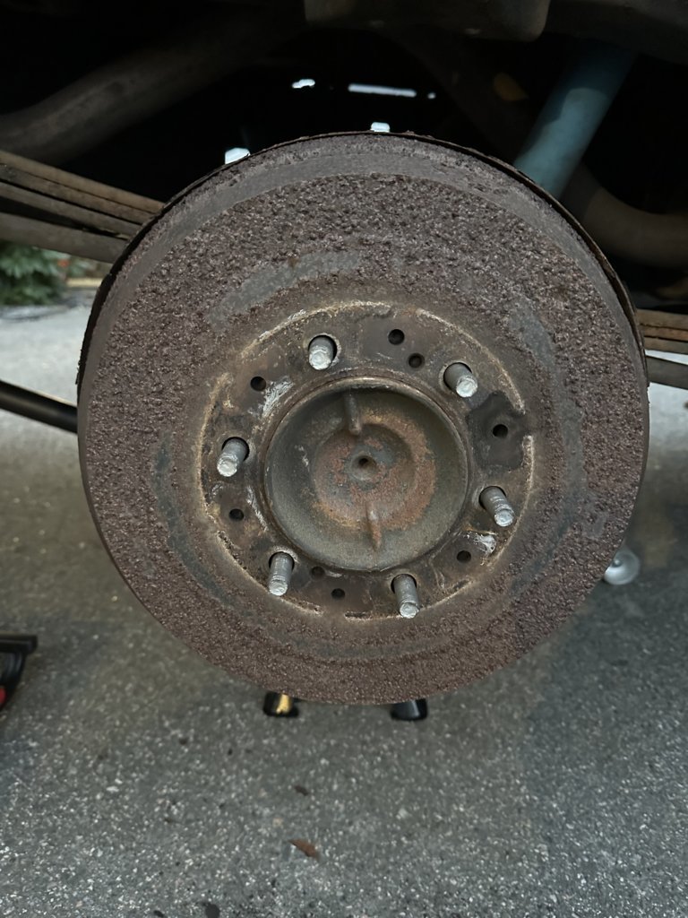

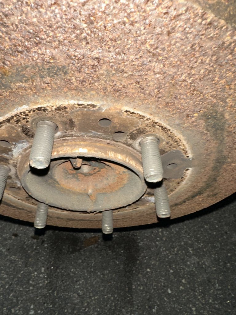

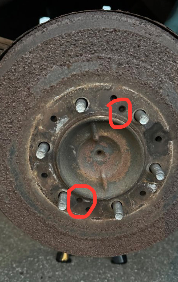

    Tried to take my drums off with no luck. Seems like there’s a lip I don’t recall? Anyone know if there are holes to push the drum out? The ones on my drum don’t look symmetrical.

    I these two holes are threaded. Stick two bolts in there and press it off while hitting the drum with a hammer.
    Can’t remember the thread size of said bolts but they had 12mm heads…
    EDIT: I used old water pump bolts. Lemme see if I can find what size they are.

    Hopefully the thread size and pitch are in the FSM. Thanks.

    Yeah I never remember what size but I keep a couple of the right size screws in my tool bag.
