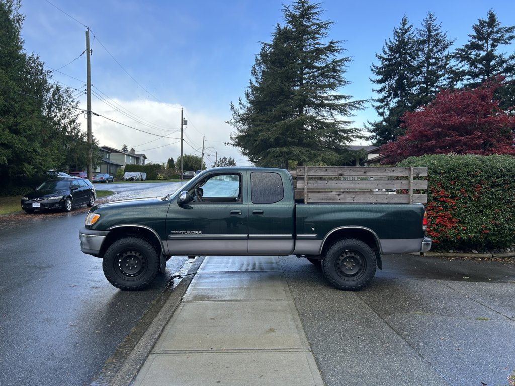

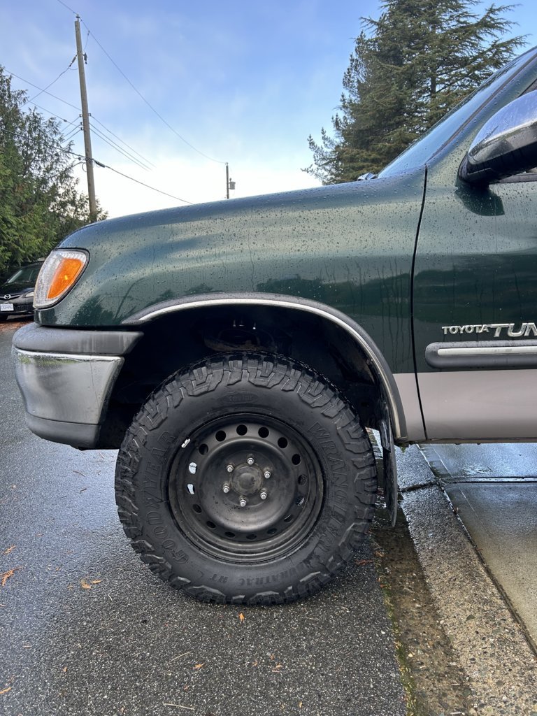

    I went with refurbished steel spare tires rims on my Tacoma and really liked how they looked. They aged quickly...but still looked great. I like my starfish rims on the Tundra, but if I ever replace them I'll consider going with the black steel spare rims again. These photos prove they look great on the Tundra too.

    I agree, I could have taken the time to sandblast and paint them properly but time was limited. I’ve always enjoyed the look of steelies myself.

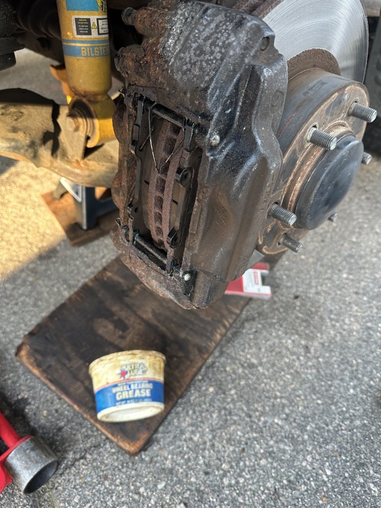

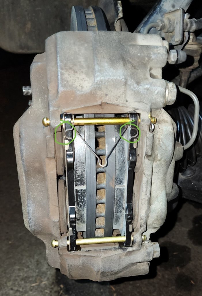

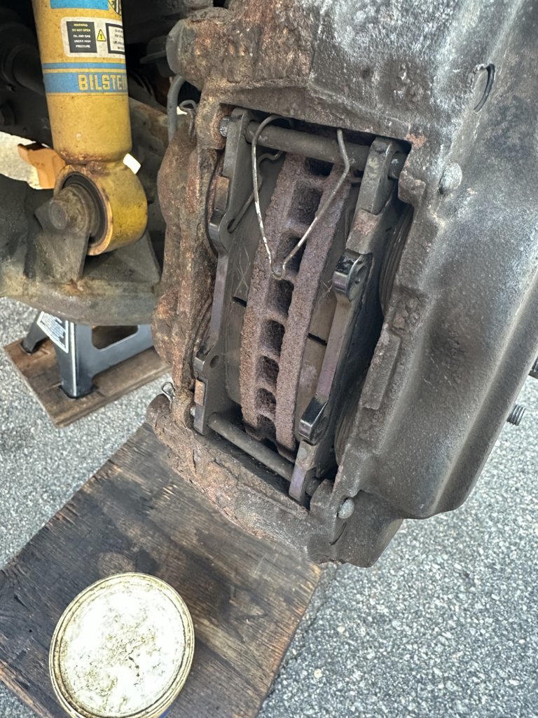

    The pad pin holes don't look that wild to me. Look at the gaps in my post of the new OEM pads with new pins. They need to have some room so the pads slide and don't bind. Have seen where they get stuck on top or bottom or one side or the other and pads wear unevenly. And if adding grease definitely high temp caliper brake grease. Did you grease the backs of the pads/shims per FSM grease points?

  6. Oct 27, 2024 at 4:06 PM
    KNABORES
    KNABORES Sarcasm incoming
    Jan 1, 2020
    #40572
    14,272
    Arkansas
    That spring on the brake pads is backwards I believe
  7. Oct 27, 2024 at 4:17 PM
    ToyotaDude
    ToyotaDude Member
    Jul 8, 2023
    #99955
    888
    2003 Tundra AC V8 4x4
    Agreed. Here is a photo of caliper loaded with new OEM pads and the spring tabs holding the pads firmly with the spring pushing the leading side of the pads outwards during forward travel.

  8. Oct 27, 2024 at 5:00 PM
    Jack McCarthy
    Nov 2, 2020
    #54409
    10,466
    Bill
    North of Boston
    02 Tundra AC SR5 V8 4x4
    Yep, shims have always been regreased per FSM however, this is the third time reusing shims so definitely a little rust.
  9. Oct 27, 2024 at 5:05 PM
    Jack McCarthy
    Nov 2, 2020
    #54409
    10,466
    Bill
    North of Boston
    I could try swapping the spring around however I don’t think it’ll matter that much.
  10. Oct 27, 2024 at 5:22 PM
    CC80guy
    CC80guy New Member
    May 21, 2024
    #117218
    231
    Larry
    Lehighton, PA
    2001 Tundra SR5 Access Cab TRD 4.7
    Yep, the spring is upside down.

  11. Oct 27, 2024 at 5:24 PM
    Jack McCarthy
    Nov 2, 2020
    #54409
    10,466
    Bill
    North of Boston
    Backwards but not upside down.
  12. Oct 27, 2024 at 5:28 PM
    Jack McCarthy
    Nov 2, 2020
    #54409
    10,466
    Bill
    North of Boston
    No, they are not. They’ve always been on top since I’ve had the truck new.
  13. Oct 27, 2024 at 5:31 PM
    Sirfive
    Sirfive Master Procrastinator
    Jan 24, 2021
    #58078
    5,146
    SATX
    ‘02 Limited AC TRD
    Bassani cat-back
    Dual spring club!
    the kinks sit on top of the pad.
    deleted my comment, cause knabores, cc80, and toyota dude had it covered.

    This spring is upside down (and mis-shaped to boot).
  17. Oct 27, 2024 at 7:26 PM

  19. Oct 27, 2024 at 7:49 PM
    Jack McCarthy
    Nov 2, 2020
    #54409
    10,466
    Bill
    North of Boston
    You mean backwards, right? Upside down makes no sense (unless you think it should be installed on the bottom caliper pin then you would be wrong for my year vehicle).
  20. Oct 27, 2024 at 8:15 PM
    Sirfive
    Jan 24, 2021
    #58078
    5,146
    SATX
    ‘02 Limited AC TRD
    Bassani cat-back
    They're inside out.
    Tlar25 and FishNinja like this.
  21. Oct 27, 2024 at 8:16 PM
    FishNinja
    FishNinja HIDE YOUR DAUGHTERS
    Jan 3, 2024
    #109562
    2,184
    Lee
    TEXAN....big surprise
    06DC2wd
    They're reversed
    Tlar25 likes this.

  25. Oct 28, 2024 at 5:36 AM
    KNABORES
    Jan 1, 2020
    #40572
    14,272
    Arkansas
    I run the clips on both upper and lower pins and can’t think of a single reason why running just one makes more sense than running 2, other than the “it came that way”
