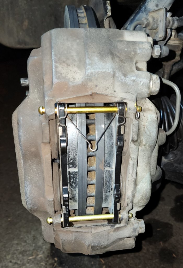

    Well found out today with my tie rods that they don’t need to be replaced just yet. The wheel wasn’t locked when the neighbor who was helping me moved the wheel back and forth. :facepalm:
    However, I did track down the ratting noise when moving the wheel back and forth in the 9 and 3 o’clock position. It appears the brake pads are moving ever so slightly up and down against the pins when moving the rotor forward and reverse as well as in and out.
    Question is where to go from here? Take it in for the inspection test and if it fails, buy new OEM brake pads and shims? Got plenty of meat and stopping power already. Don’t really want him taking the wheel off and further inspecting.
    This is not good. Failure means a $460 rental for the next two weeks to deal with work issues before I revisit this again. :annoyed:

  15. Oct 27, 2024 at 11:11 AM
    Sirfive
    Sirfive Master Procrastinator
    Jan 24, 2021
    #58078
    4,835
    SATX
    ‘02 Limited AC TRD
    Bassani cat-back
    are the pads holes wollered out, or are the pins rusted into needles?
    FrenchToasty likes this.
  16. Oct 27, 2024 at 11:15 AM
    Jack McCarthy
    Nov 2, 2020
    #54409
    10,262
    Bill
    North of Boston
    02 Tundra AC SR5 V8 4x4
    Pad holes are ever so slightly greater than the caliper pin width. They aren’t the specific OEM part for the Tundra just the generic Toyota OEM ceramics they make to fit multiple vehicles for a cheaper price. Weird this is my 2nd set and it never happened on the first set.
    Toyota basically gives you two choices to pick from for the replacements when looking it up on their part sites.

  18. Oct 27, 2024 at 12:05 PM
    ToyotaDude
    ToyotaDude Member
    Jul 8, 2023
    #99955
    857
    2003 Tundra AC V8 4x4
    Sorry don't follow. How is the rotor moving if the wheel is bolted onto the hub keeping the rotor static and the caliper is attached to the knuckle...without significant bearing play...or am I missing something? Pads will move a little because they must not bind. But it seems if everything is tight then moving the wheel should not cause significant ... or any ... pad movement? When I'm spinning a wheel to listen for front bearing noise I remove the pads and use a stethescope on the knuckle bearing housing. Think you can also grab the spindle maybe the strut and feel for vibration as a first rough check.
  19. Oct 27, 2024 at 12:27 PM
    Jack McCarthy
    Nov 2, 2020
    #54409
    10,262
    Bill
    North of Boston
    I agree the rotor won’t move when the wheel is bolted on except rotating the wheel however just the tiniest bit of play with the brake pad holes being slightly larger than the caliper pin will cause it to shake up and down from jolting the wheel back and forth. Enough to make a noise. Hold the pad down against the pin with a screwdriver, noise goes away when moving the rotor.
  20. Oct 27, 2024 at 12:33 PM
    ToyotaDude
    ToyotaDude Member
    Jul 8, 2023
    #99955
    857
    Got it. Have not had pads be that loose. On my truck usually caliper keeps some friction on rotor since letting the pedal off doesnt creat a gap but good spring clips can push it back. But still don't recall them flopping around. Do you have spring clips installed?

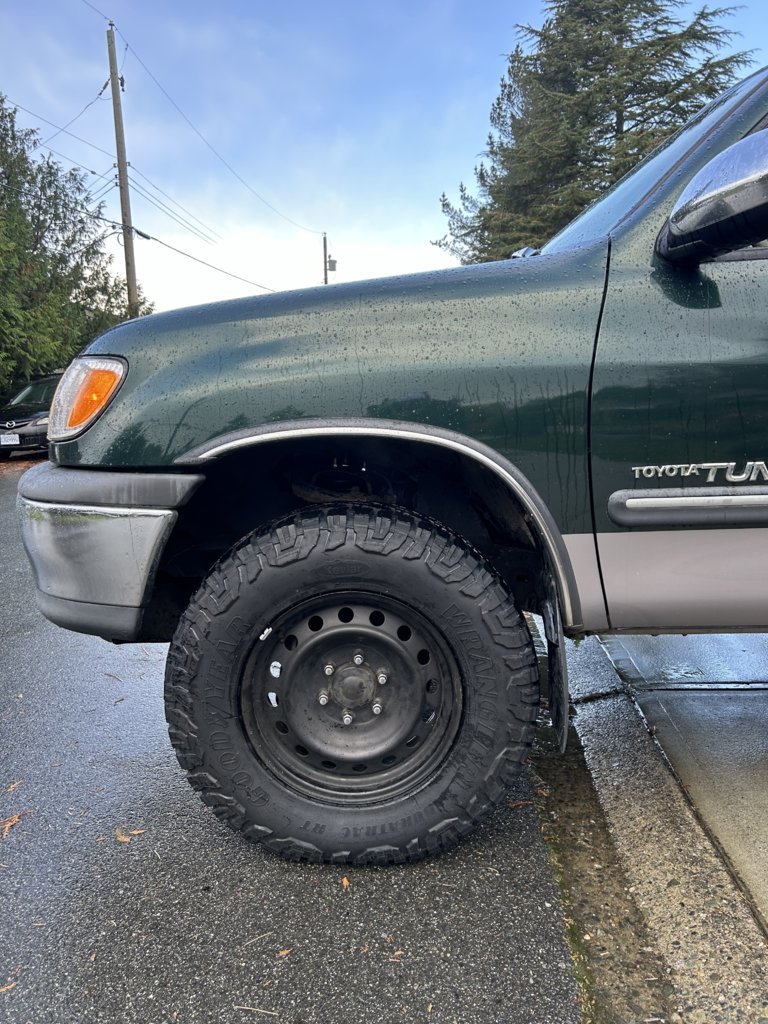

    Bit of a before & after. New Duratrac RTs look mean, went with a 255/75/17 on steelies. No rubbing to note at low speeds.

    Spring clips installed. I think I’m going to try some thick ball bearing grease against the pins to see if it dampens the noise. Might help.
  23. Oct 27, 2024 at 12:48 PM
    ToyotaDude
    ToyotaDude Member
    Jul 8, 2023
    #99955
    857
    Ball bearing = high temp brake grease right? Dont think any is called for in FSM where the caliper pin goes through the brake pad eyelet but know some do decide to grease pins especially at caliper through point to prevent rusty seizing. Have found it can help with pads sliding too at the pad through point but also it can get dirty and gum up and then work against intended purpose so needs serviced occasionally throughout pad life.
  24. Oct 27, 2024 at 12:52 PM
    bfunke
    bfunke Tundra Curmudgeon
    Oct 13, 2019
    #37321
    2,402
    South Carolina
    2018 SR-5 CM 5.7, 2000 SR-5 AC 4.7L
    Use disc brake caliper grease on the pins. A tube is pricey but you can get a packet at the FLAPS.
    FishNinja likes this.

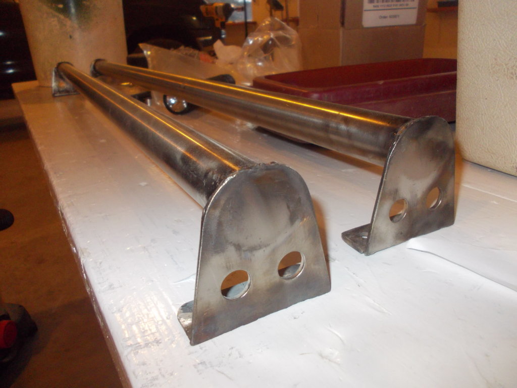

  25. Oct 27, 2024 at 1:02 PM
    FishNinja
    FishNinja HIDE YOUR DAUGHTERS
    Jan 3, 2024
    #109562
    2,181
    Lee
    TEXAN....big surprise
    06DC2wd
    the bottom brace is bolted in. So I just removed it.

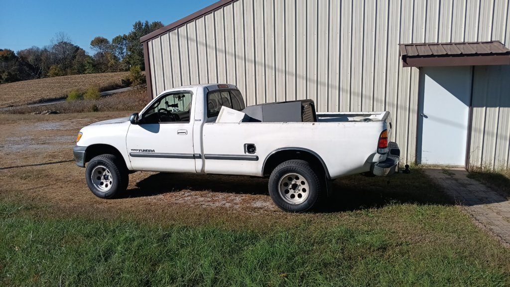

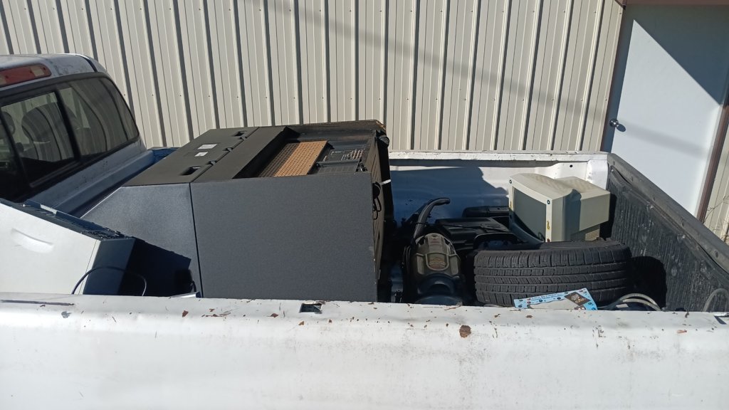

    Crackie out here doing crack head shit. Load of old electronics to strip down for copper/steel.
    Courtesy of Mamaw clean out. Helps her, and helps us. We all benefit except for my hands.

  28. Oct 27, 2024 at 1:23 PM
    Jack McCarthy
    Nov 2, 2020
    #54409
    10,262
    Bill
    North of Boston
    I used some wheel bearing grease and it definitely cut the noise in half. Is the caliper grease any thicker?
    Those pad pins holes are definitely loosey goosey (compared to the caliper pin holes)
    after:
  29. Oct 27, 2024 at 1:58 PM
    bfunke
    Oct 13, 2019
    #37321
    2,402
    South Carolina
    Caliper grease won’t melt at high temps like ordinary bearing grease will.
    Jack McCarthy and FishNinja like this.
  30. Oct 27, 2024 at 2:07 PM
    FishNinja
    Jan 3, 2024
    #109562
    2,181
    Lee
    06DC2wd
    higher melting point. You know, so grease doesn't go where it shouldn't
