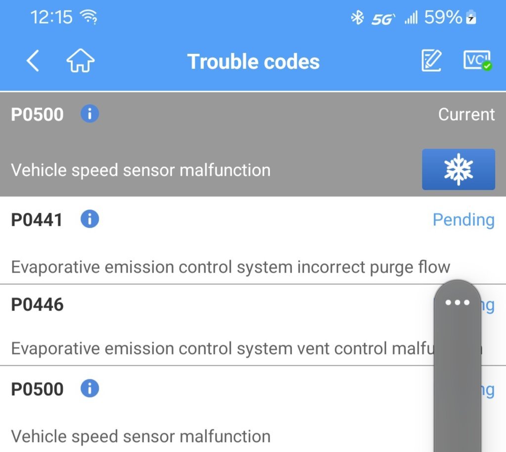

  17. Oct 21, 2024 at 12:55 PM
    Tundra2
    Tundra2 Zoinked
    Feb 10, 2019
    #25875
    12,457
    Noah
    Western Kentucky
    I knew about the speed sensor since crackies speedo is totally borked. However, the other codes are surprising!
    Before I dive into the rabbit holes, yall got any ideas? Any experience?
  18. Oct 21, 2024 at 1:02 PM
    FrenchToasty
    Sep 15, 2019
    #36156
    18,618
    Mo
    The SoAz….. big surprise
    Bone stock
    Gas cap?
    Tundra2[QUOTED] likes this.
  19. Oct 21, 2024 at 1:59 PM
    NickB_01TRD
    Jun 16, 2021
    #64346
    2,760
    Nick
    KY
    01 Tundra V8 4X4 AC SR5 TRD
    That thing has got to be shifting horribly. My camry threw a fit without the speed sensor working.
    FrenchToasty likes this.
  20. Oct 21, 2024 at 5:43 PM
    FiatRunner
    FiatRunner 2003 rich
    Nov 25, 2022
    #87321
    1,181
    Jack
    Chicago Suburbs/Milwaukee
    I dealt with a 446 and 441 for years. It turned out to be one of the vent solenoids near the fuel tank. My advice: don't throw parts at it. Except for maybe a gas cap. I spent probably $400 on various evap system components, turns out that it was a $30 vent solenoid.
    Do you have a fuel smell? With a full tank, I could smell gas, but couldn't tell from where.
    G_unit3000 and Tundra2[QUOTED] like this.
  21. Oct 21, 2024 at 7:10 PM
    shifty`
    shifty` Dead heads and frog legs. Mmm... cake mix!
    Jun 20, 2020
    #48239
    30,703
    ATL
    '06 AC Limited V8/4WD
    Yep, smoke test that mofo.
    G_unit3000, bmf4069, Tundra2 and 2 others like this.
  22. Oct 21, 2024 at 9:57 PM
    Tundra2
    Tundra2 Zoinked
    Feb 10, 2019
    #25875
    12,457
    Noah
    Western Kentucky
    Naw, He's still driving great! He idles around 1,000 rip-ums, but I think that's more due to the venting codes than anything else. Drove him tonight.
    FiatRunner likes this.
  23. Oct 21, 2024 at 9:57 PM
    Tundra2
    Tundra2 Zoinked
    Feb 10, 2019
    #25875
    12,457
    Noah
    Western Kentucky
    No fuel smell that I've noticed. I'll have bruce take a look at him, and do the below if possible.
    :thumbsup:
  24. Oct 21, 2024 at 10:01 PM
    FiatRunner
    Nov 25, 2022
    #87321
    1,181
    Jack
    Not sure how valuable this information is but I figured I'd share- I never had any idling issues, even with P0441 and 446 present. It always ran totally normally.
    G_unit3000 likes this.
