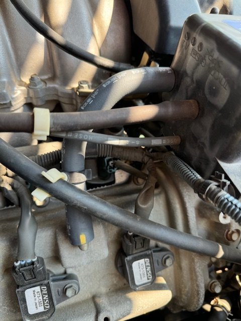

    There it is. Between 2,4 with the yellow line.

    Thanks for that! Is there anything else there besides the hose that may need to be replaced? Just has one pcv valve right?

    Correct on one PCV valve.
    Is there anything else to replace? Dunno, inspect the lines that go into the back of the square bulge on the intake tube, look at both ends, squeeze the ends, do you see any cracks? If yes, you may need to replace some add'l hoses.
    Here in the near future, I'm probably going to take a tally on all the ID/OD for the vacuum hoses in my engine bay and replace them all, or at least trim the leading 1/8" off all of them and reinstall. Running up on 20 years of use here soon, it's probably time to overhaul.

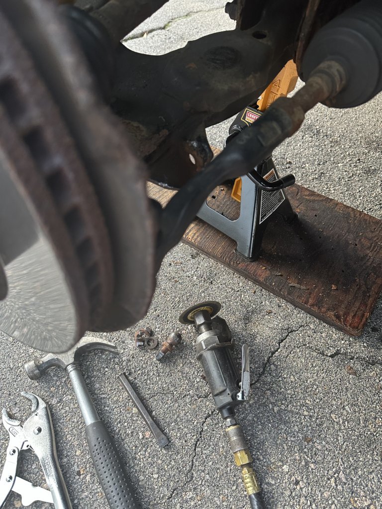

    Whizzer 1, broken end of link 0.
