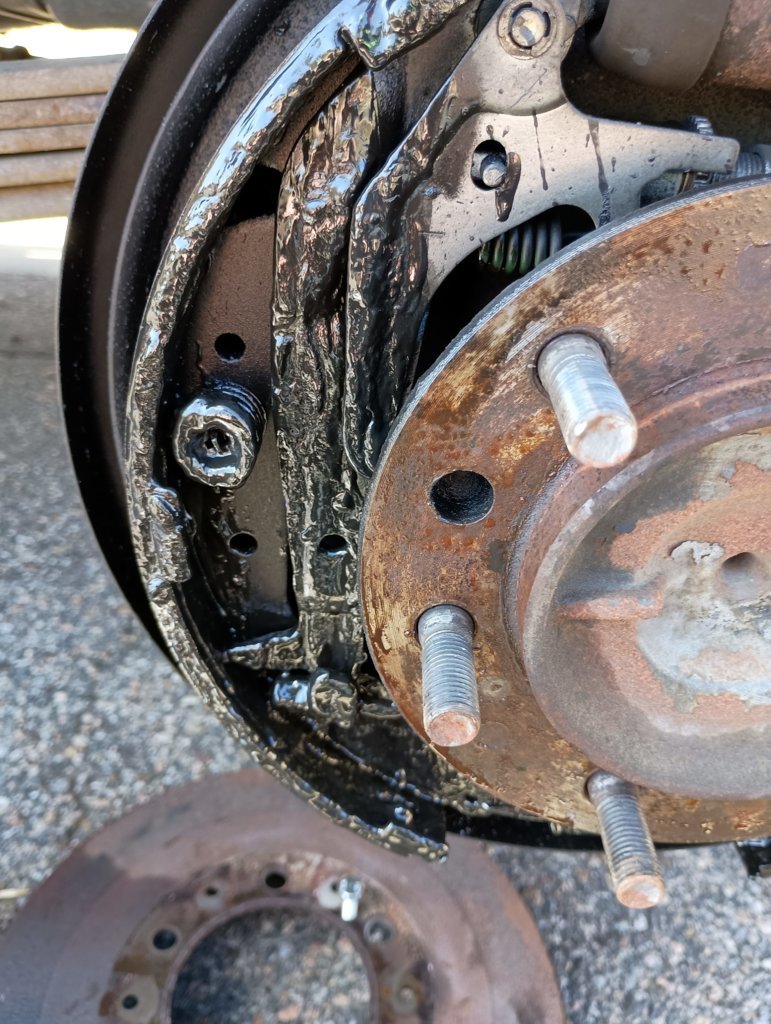

    Both rear brakes look like they were fully dipped in grease. Would this be caused by a bad outer seal?
    I'm going to have a shop replace the bearings and outer seals. I'll replace the inner seals, drums and rear brake shoes. The diff breather is good. Anything else I should check or do?

    a bad diff. vent, which then caused the seals to go.

    As long as it moves and isn't stuck is it good, or do I need to take it off and blow through it?

    I think you need to take it off and test it.
