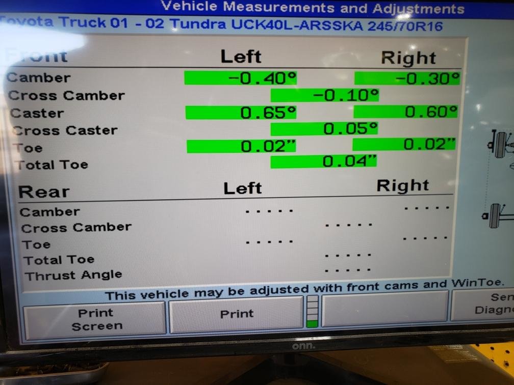

    Dropped the truck off for an alignment. This guy is one of the best in Amarillo. Hopefully it'll fix my wandering and tire cupping.
    Quick question, will tires that have started cupping wear back to normal? Or is that it, they're that way till you buy new ones?

  2. Oct 3, 2024 at 6:53 AM

    I've had luck swapping cupped fronts to the rear to true them up.

    I swapped them before T2S this year, but noticed the fronts starting a bit. Hopefully I caught it in time. That's the thing that sucks about not driving the truck every day. It'll take a year to see any change.

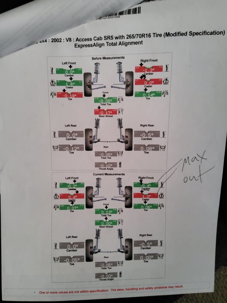

    Picked up the truck from alignment. This is as good as it gets I guess.
    Before
    After
    So I guess I'm getting some new UCAs. At the same time, dude said my inner tie rod on the passenger side is going bad. Not enough to warrant replacement right away, but enough to give a little wiggle in the wheel. The truck did feel better at 65 so far.
    New plan of action:
    New JBA/Eibach/SPC uppers
    New OEM inner and outer tie rods
    That's about it. Ugh. I had a feeling it wouldn't fix anything. Maybe there's something else wrong that I missed? He said everything else was fine.

    Lift on the early trucks gets minimal caster. But where are the adjusters set underneath?
    Yeah, it's ok. Your tire costs will get you in the end.

    Freedoms. I was hoping they shifted the ball joints to get a bit more caster, but I'm starting to think they're stock, but tubular.
