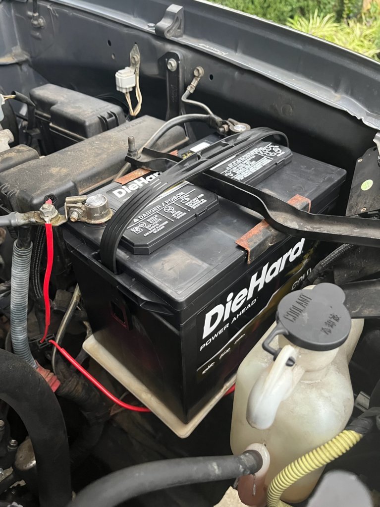

  3. Sep 26, 2024 at 3:19 AM

    Well, I think my starter is going—217XXX miles. The truck struggled to start yesterday morning and then got progressively worse during the day; I just dropped it off at the shop because I didn't want to get stranded and need a tow. I'm not sure what else it could be; it's just having a hard time turning over. The battery was replaced last year.

    Could still be the battery. It’s incredibly rare for the starters in these to actually go bad, as in the windings failing. The contacts eventually wear down, but that results in an occasional “click” instead of starting when turning the key that eventually happens more often as it wears. But it starts normally otherwise. Mine is occasionally clicking again 170k miles after changing the contacts out. Still original starter with 273k miles on the truck. Still starts strong.

    2nd. I'd be looking at corrosion and contacts. Like @shifty` says, "It's never the starter or fuel filter. Except for when it is then it IS the starter or fuel filter".

    Hey!! Good news. Battery. Shit battery from 2 years ago but working fine now.

    My Tundra lives another day :)

    Now pull out that battery hold down, wire brush, Naval Jelly it, and hit it with some rattle can :rofl:
