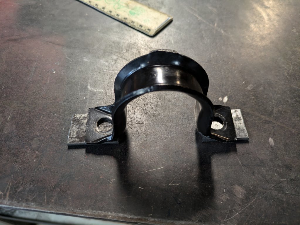

    I missed this part of your reply!
    The rear sway came off a 2002 GMC Yukon I believe, however i found several similar rear sways on the Chevy Tahoe of different years. Probably the same generation.
    The only mods I did to make it bolt up was lengthening my OEM front sway bar links. But really any proper length link could work. Youll need at least the lower link bolt to be a right angle on the end link to fit the rear sway eyelet.
    Also the brackets on the axle arent wide enough for the U bolts to fit the axle. I welded up a bracket under the bracket to "widen" the bracket front to back.
    The U Bolts came from Addco, just ordered them online for a first Gen Tundra.
  5. Sep 23, 2024 at 9:04 AM
    oscardog86
    oscardog86 New Member
    Mar 25, 2019
    #28131
    1,003
    Southern California
    2001 Toyota Tundra 4x4 V6 5VZ-FE MT
    Heres a pic of the bracket, before being welded and a 7/16" hole drilled into it for the ubolt.
    PXL_20240916_012754496.jpg PXL_20240918_001758849.jpg PXL_20240918_015849294.jpg
    Oh and the part number from Addco for the U bolts is: 35-405-0M (3/8 x 3 x 3 7/8 U Bolt)
    Ill take some pics after work of it all painted and bolted up.
    Keep in mind, I found from digging online that the OEM Chevy sway bars are possibly hollow, and the one I found was aftermarket from Dorman which was apparently preferred for being solid. So I got lucky at the junkyard finding that one!
