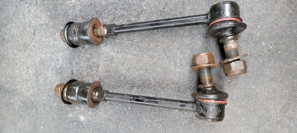

    Has Anyone ever determined accurately what's making the noise? Like is it on the end of one of the links, or in the straps to the frame... or general body flex somewhere?
    Rotating the tires today, so perfect timing to experiment with the disconnect. thx for the input.

    My links were still good (i think) when i deleted them, so i can't say for sure on a tundra. I will say this, the swaybar would clunk and pop a lot on my mother's 2008 Odyssey. Turned out the ball joint inside the end link was severely worn out. It wasn't noticeable until i disconnected the end link from the low arm though. The reason being was that there was too much tension holding them in place when all the swaybar components were still assembled. Once the tension was removed, then it was quite obvious that the ball and socket on the end links were completely worn out.

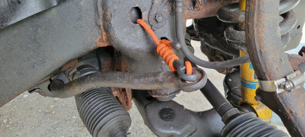

    Mine came out with little resistance (covered in oil... who does that :rofl:), and all the joints were tight. These were some of the first things I replaced in 21, I think one was broken at that time. Probably the cheapest $10 ones you could get.20240922_101744.jpg

    Follow up...
    Same clunk when I turned right out of my driveway this morning.
    As for the feel w/o them, it's not horrible but quite noticeable. Will be putting them back on. My clunkquest continues.

    I just remembered the overload leaf situation. Probably simulates a rear sway bar.
    Are the front shocks new?
    Most the time I've seen people only recommend deleting the front sway bar if you have decently upgraded/stiff front suspension.
  23. Sep 23, 2024 at 3:35 AM
    BroHon
    Sep 19, 2023
    #104169
    2,592
    Bro
    Location: Bitch Mitten
    2000 SR5 AC 4x4 4.7
    Spot on, I've put 1200lb in the back and it just looked at me like... is that all you got? Sagged about an inch, maybe 1.5?
    New 4600s up front, on one stock spring(pass) and one TRD spring(driver)/ New LCAs / new OEM LBJs
