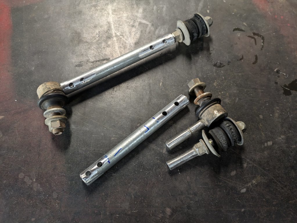

    2001 Toyota Tundra 4x4 V6 5VZ-FE MT

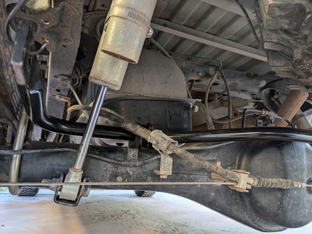

    So my Addco sway bar didnt fit after adding the U Bolt flip kit, so i grabbed a First Gen Sequoia sway bar from the junkyard. That came way to close to the driver side shock and didnt really fit on the axle very well.
    On a search to find a rear sway bar that fits, that doesnt cost what the Hellwig costs, I may have found one at the pick a part. A Chevy or GMC Yukon/Tahoe sway bar seems to fit pretty well.
    The one i grabbed off this particular vehicle looked new, turns out its a Dorman aftermarket sway bar. Looking at reviews its solid and not hollow like the OEM chevy/GMC sway bars.
    Heres a couple pics. Looks like it should work right? I just gotta get some endlinks that I might fabricate from my front sway bar links. I removed the front a couple years ago now.

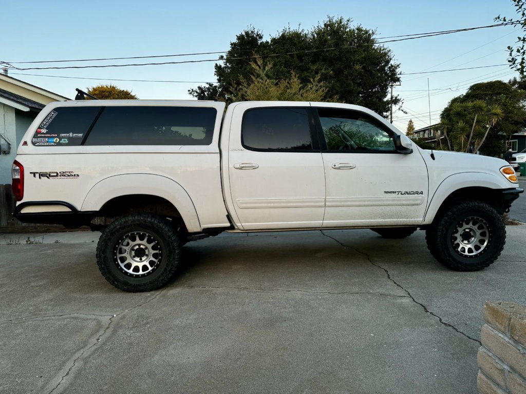

  8. Sep 17, 2024 at 9:29 AM
    805Tundra
    805Tundra New Member
    Dec 8, 2021
    #71586
    456
    Ben
    Central Coast
    2004 White 4x4 Double Cab
    Toytec Aluma 2.0, Camburg UCA, 5160s and more.
    Man I definitely feel like they are stiffer than stock but are so smooth. Great on the whoops but not nearly as jarring on small bumps compared to when I had kings (on my Tacoma). Curios to see what you think about the 6112s because I have read that they were stiff.
    inspired me for a side shot of the truck lol

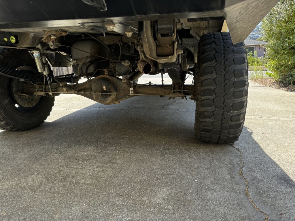

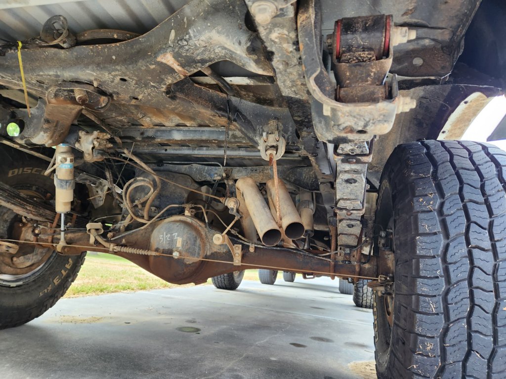

    Curious, where's your exhaust dumping. Your tires also look smaller than I remember, did you change your rubber up? Not that size matters, but ... :rofl:

  10. Sep 17, 2024 at 3:48 PM
    805Tundra
    Dec 8, 2021
    #71586
    456
    Ben
    Central Coast
    Exhaust:
    Same size tires, 285/70/17. I have been debating of whether or not to jump up to 285/75…but I think you just confirmed I need to lol

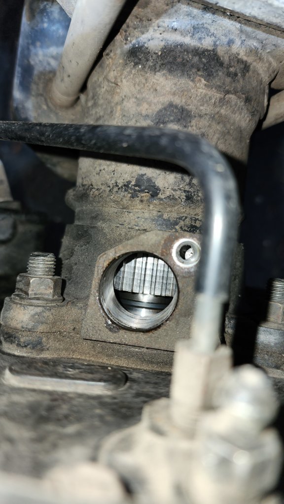

  12. Sep 17, 2024 at 8:27 PM
    ToyotaDude
    ToyotaDude Member
    Jul 8, 2023
    #99955
    888
    2003 Tundra AC V8 4x4
    Rotated the tires checked the brakes and confirmed the axle seal integrity about 2600 miles after rear bearing swap.

    I cut my exhaust in almost the exact same spot. Definitely hides it and gets it out of the way from hanging so low

    A turn down might help keep from recycling exhaust gas into the cab

    That could help, I did cut mine at more of an angle though not just straight across.

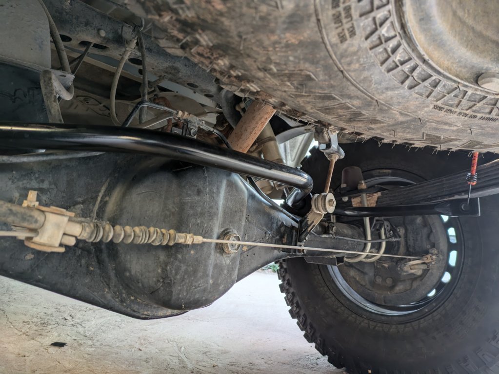

    Made some end links for my sway bar from my old front ones. Coming along, should hopefully fit it up when the U bolts come in the mail tomorrow.
    Meanwhile @assassin10000 sent me a great list he compiled of end links he found that are around the length needed. Thanks man! I may have to use one of those if these end up not working out in the long run.
    Ill probably get some new bushings eventually if these end up working. Also gonna weld the ends of the tubing today for extra strength
    But heres what I came up with:

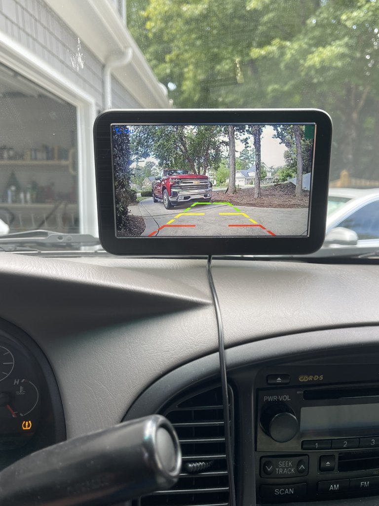

    IMG_3897.jpg IMG_3898.jpg Rain finally stopped after a few days of constant rain. Took the opportunity to do a wash and detail wax on the Tundra and installed a wireless backup camera. Initial reaction to the backup camera is very positive. While I love my cap - can be a little awkward to backup in busy parking lots. The backup camera should be a big help.

    Which backup camera and screen is that?
  28. Sep 18, 2024 at 1:04 PM
    cjmustang69
    cjmustang69 New Member
    Feb 29, 2024
    #112838
    13
    2005 Grey Tundra Limited 2WD
    It is a unit I bought off Amazon - DoHonest is the brand. Screen is 7”.
