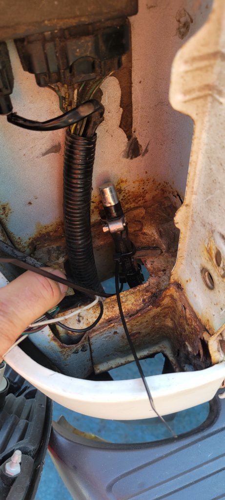

    The forward portion of both inner fender liners was hanging loose. Used a zip tie to pull them back against the brackets behind them. Rubbing resolved.

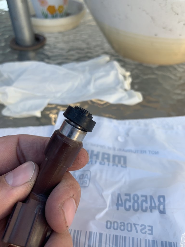

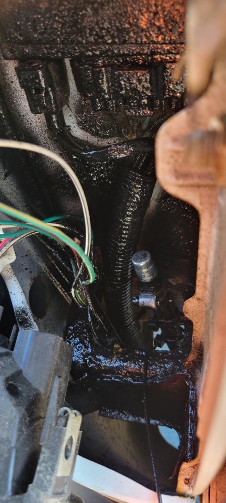

    Got dirty deeds 12 hole injectors and tried to install them. was easy enough to get to the fuel rails and I cleaned the seats but once I went to turn on the truck they were spraying all over. Any idea what I did wrong? I'm going to tear everything down and redo it again tomorrow during daylight.

    Did you soak them in gas before you installed? Supposedly the seals on the tips need some lube, the gas helps them slide in nice and easy

    I did not soak them in gas because they seemed to slide around pretty good as they came. I just got them yesterday and DD states that they are pre prepared but soaking them is on the list for the reinstall tomorrow. Some of them aren't spitting like this but about 4/8 are.

    Any chance the old ones left an o-ring behind ?
    make sure all the old o-rings are accounted for

    Oh thats a good idea! im glad i kept the old ones lol. so i am going to soak them in gas or coat in oil according to some youtubes and seat the grommets before installing the fuel rail back and check those o-rings.

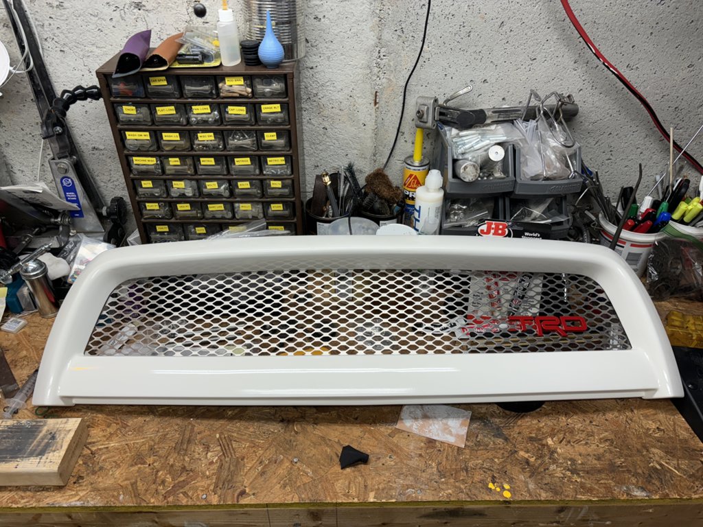

    So did I miss you show us what it looks like on your truck? Grill I mean. However tires and wheels too, why not?

    These o-rings like to stay behind

    I've used tune up grease on the seals when I've replaced a fuel injector. Always use some sort of lube on rubber seals before installation...always. Oh, and antiseize on bolts, especially bolts underneath the vehicle.

    There are those fat o-rings and the smaller ones that go into the fuel rail. I confirmed with old injectors all of their parts are still with them!
    Took out the whole fuel rail, cleaned the shit out of the o-ring seats, lubed and reseated making sure to do it as well as possible, reinstalled everything very carefully and the same problem is still happening. I also inspected the o-rings to see if I damaged anything on the first go round and everything looks good, no cracks / damage to the integrity of the rubber.

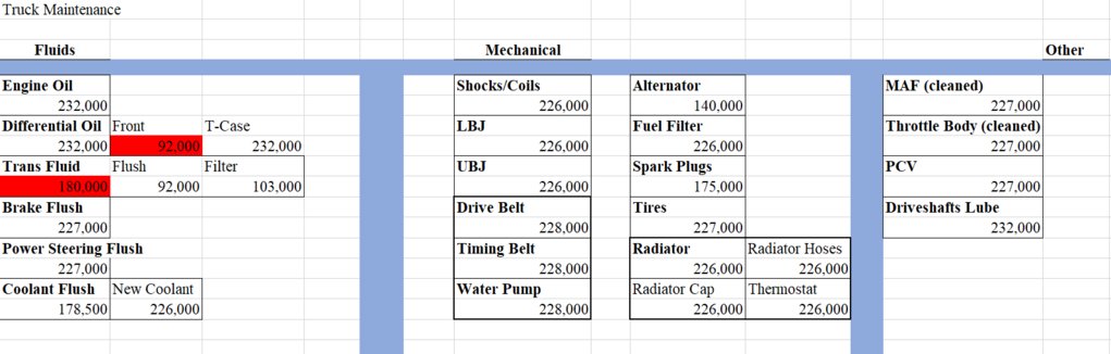

    Replaced rear diff and t-case fluid, engine oil change. Made sure rear diff breather was clear. Got stymied by the front diff drain plug, but in a rare show of restraint, I stopped what I was doing before completely destroying the hex plug. Before I get out cold chisels and hammers, I should make sure I have a replacement on hand...I ordered the Lexus part to avoid this the next time. The fill plug cracked open no problem, but not the drain.
    Sometimes hard to trust Carfax. It reports what the auto shop reports, and a couple times now I've found they haven't reported everything, or used terms that were unclear. Carfax says the last time my front diff and t-case fluids were replaced was around 92,000 miles, but the fluid that came out of the t-case looked brand new. Still want to get to the front before long, just so I know for sure when everything was last replaced.
    Now I just need to do a few cycles of drain/fill on the transmission, and I'll be all caught up on most maintenance items. Need to inspect the brakes before long, but otherwise I think I'm up to date on more or less everything.

    Every time I’ve ever replaced my transfer case and front diff fluids, they’ve always looked brand new. Even at over 100k miles.

    Same here. I changed my Tcase and front diff fluid for the truck's first time at 200k. I almost didn't change them after seeing how clean they were.
