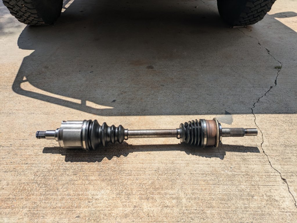

    Is that a Toyota axle? This is a toy (remanufactured) axle.

    Honestly it might not be, but its just a spare if I break one offroading. If that ever happens Id be buying a Toyota reman'd one to replace it once I got back home.
    Thanks for the heads up though!

    Just remember nut may not be the same.

    You mean that driveshaft nut? I believe it was 35mm OEM and this one was also 35mm so hopefully im good there! Thanks for that info though!

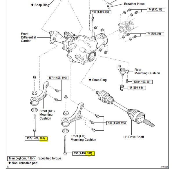

    Didnt someone here recently remove their diff drop kit? I will be doing that today or tomorrow when my OEM bolts show up from toyota.
    Do you recall the torque specs for those 2 bolts? Is it best to support the diff with a jack or stand and then do one side at a time? Thanks!

    I removed mine when I regeared. You could probably support the diff with a jack, remove both bolts and the spacers, then jack the diff up and put the new bolts in.

    When I got my Trakmotive axles they had a different size hex drive but the thread size and pitch was exactly the same as OEM, so I just put the OEM nuts back on it and its been fine. I didn't want to have to go buy another socket just for reinstall.

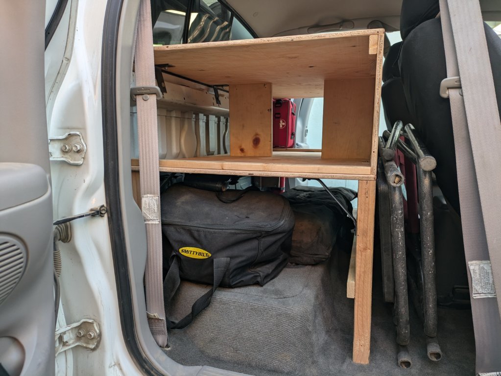

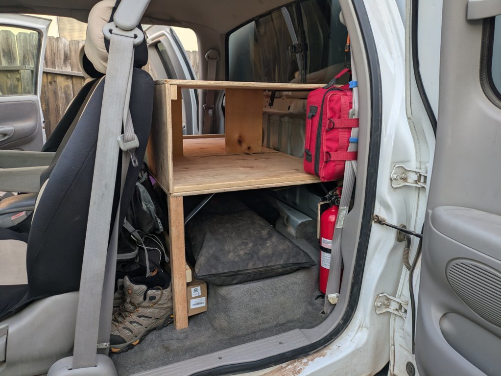

    Rear seat storage area is coming along. Got some bins coming in the mail to fit in the upper section for all my tools and recovery gear.
    Gonna try to get the diff drop delete done today.

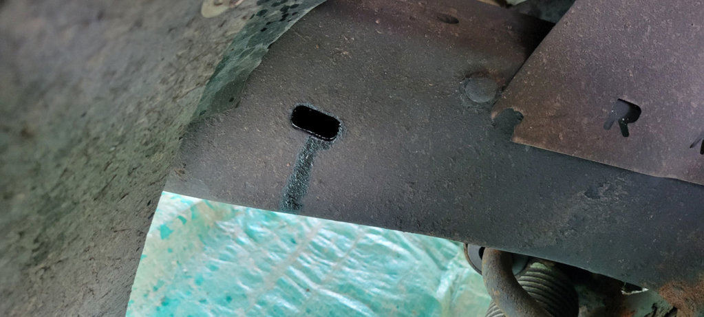

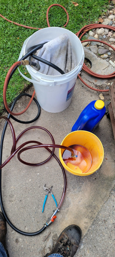

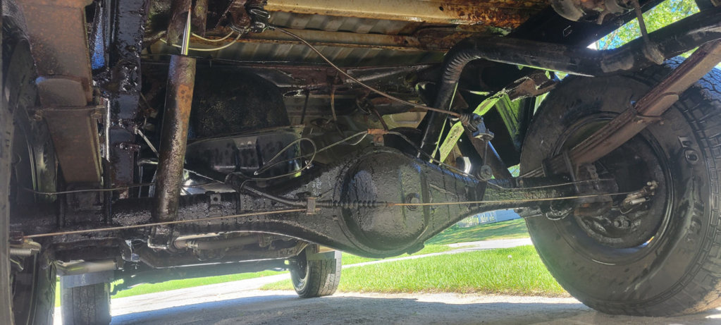

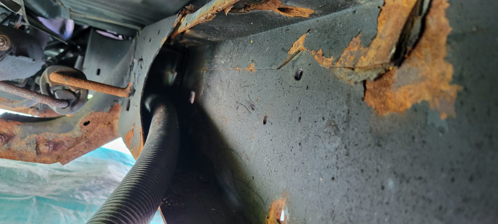

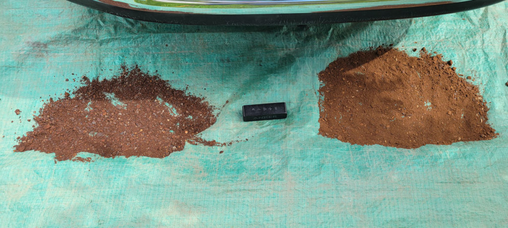

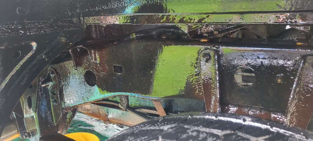

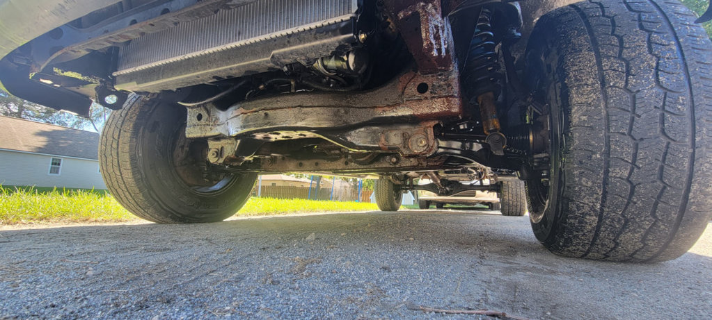

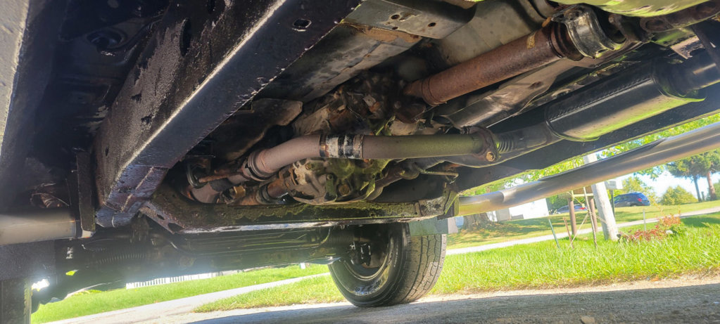

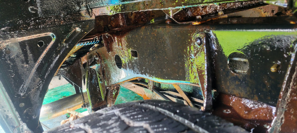

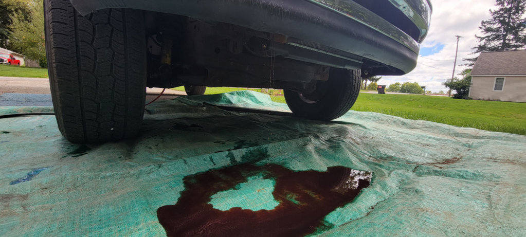

    A little frame love for my old girl today.
    Vacuumed out the front rails. Entire frame inside and out got sprayed. All of the cross members inside and out. Up in all the wheel wells/inside the panels got a good coating as well.
    First sprayer full was a lot of t-fluid, oh well, sent it. About 9-10qts, 50% of which I mopped up off the tarp with 3 old beach towels. The DIY garden sprayer w/air worked pretty well, 90psi max, don't ask how I know :facepalm:
    Messy job but the rust is paused for a year or two, and that's what I can do for her now. Smells like a Texas Oil rig :rofl:
    Looks like a lot, but it's not quite a quart jars worth from each side.
    Got in there deep all the way up to the front cross bar. Spray/Twist/jam in and out/repeat

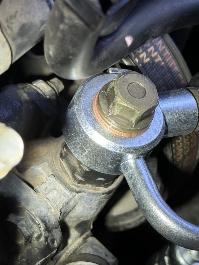

    Replace my Power steering hose. The rubber on the high pressure hose had deteriorated to the point it was leaking in the middle of the line. This little bastard fought me hard. Couldn’t get my bear paws around it to line it up so I ended up removing this air box and air intake to get enough room.

    Oil based undercoating is definitely the way to go. What's in your mix? I follow a guy on youtube who melts a wax toilet seal into chainsaw bar oil. Super thick stuff.
