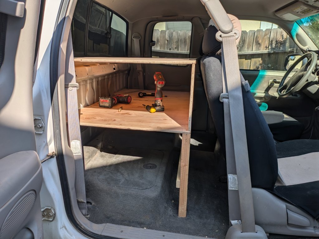

    Also, upgraded my rear behind the seat storage. Should be stronger and hold some more stuff than before.

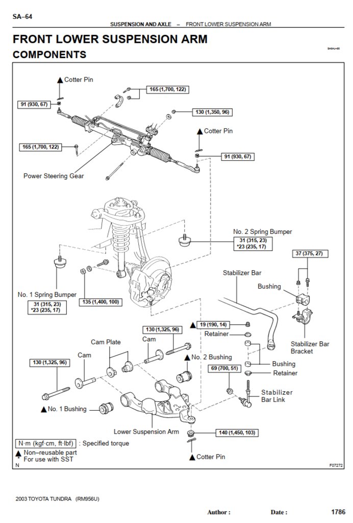

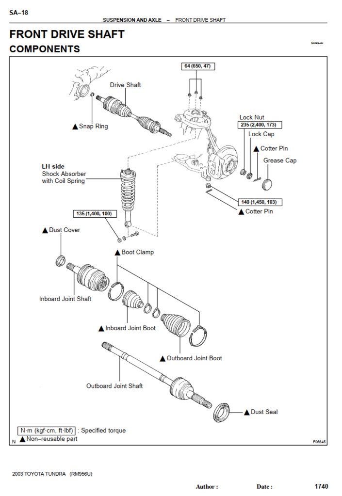

    Is that "hub nut" the torque for the cv axle nut? 83 ft/lbs? The video i watched said it was 103 ft/lbs.
    Also is that diff front mounting cushion x chassis frame the diff bolts im changing? 101 ft/lbs then?
    EDIT: Mustve misheard in the video, because according to you guys its 173 ft/lbs for that lock nut

    I believe drive shaft lock nut is the CV nut. I think the hub nuts are actually the lug nuts.

    Hub nut is the lugs, 83ftlbs
    Axle nut is “lock nut” on the diagram, 173ftlbs

    Hub nut is bang it on with the impact, IMO. Never had a problem. Smart move getting a junkyard axle because OEM used is so much better than my NAPA axles which I replace every 2 or 3 years. That cool zerk on the ball joint is aftermarket. If I saw one on any of mine I would yank it off and replace it with OEM LBJ.

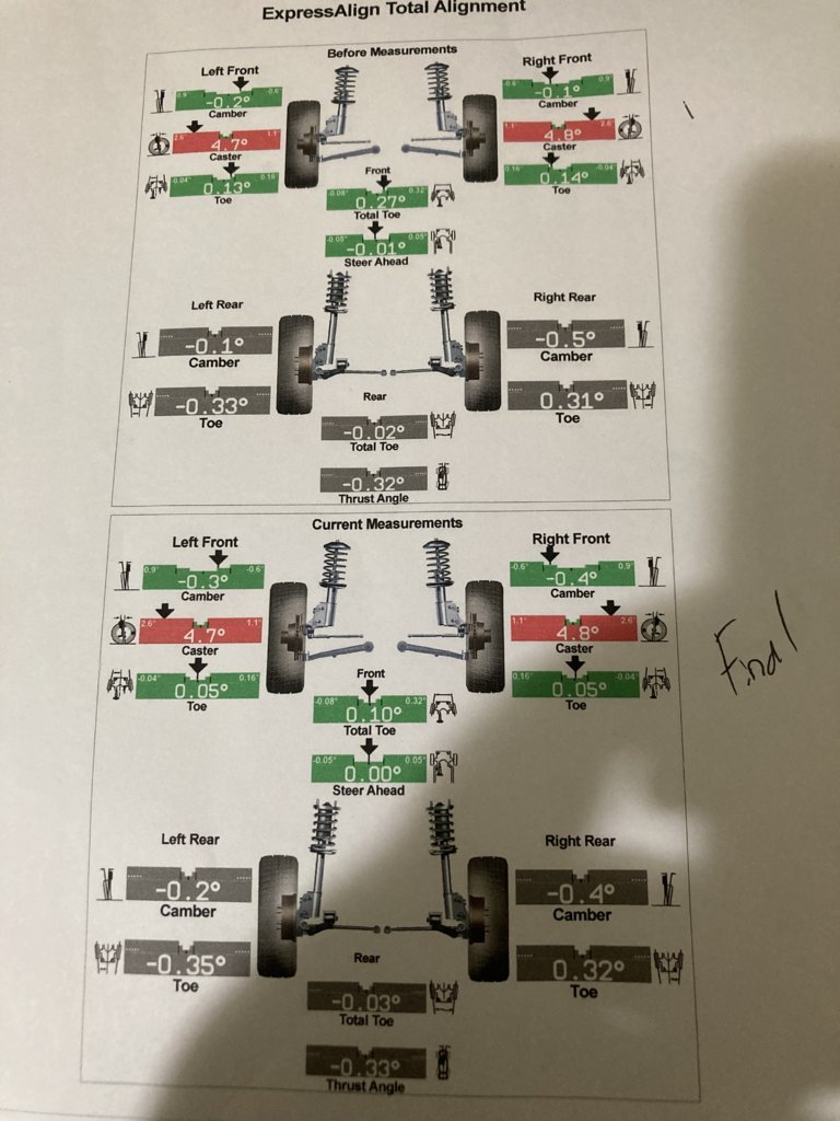

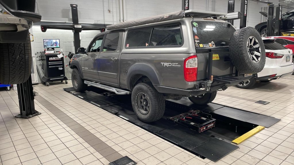

    Got the truck alignment done today; there still are good people in this world. I left a 40$ tip taped to the shifter, it didn’t get taken, and I got 60$ knocked off the bill for being in the local 4r group. @assassin10000 what say you?
    IMG_7041.jpg IMG_7042.jpgAnd it wasn’t that easy, I have another page of trials and tribulations.

    Holy crap. How’d you get caster that high? Is it the aftermarket upper control arms that provide it?
    For me, paying the guy an extra $40 would allow an extra 15 minutes mucking around with it only to say it’s impossible. :rofl:

    Someone on here had like 3.2 caster recently on OEM suspension. It made me want to go back to the "Toy / Lex Overlanding" shop that did my alignment and have some words with the shop manager who refused to take my caster deep into the 2s. :rofl:

    Yeah the solo arms move the lbj 1” forward. He was saying my rear passenger side frame might be bent a bit because he couldn’t get where he wanted with that back one. One of my front cams was def locked in when I tried to remove and I know that was an “excuse” last time but no big deal, I saw they weren’t BSing about that

    3.2 on stock at stock ride height, maybe. Definitely with SPC, JBA, TC, etc. upper arms.

    Does it drive weird with caster that high? I've heard too much caster can cause the truck to become unstable at high speed over big bumps and I've experienced this a few times I think. There is a huge pot hole on I-40 that I've hit twice, and for a brief moment it feels like I don't have control of the steering. Darkness is the one that mentioned this issue. My caster is closer to 3.0 though.
