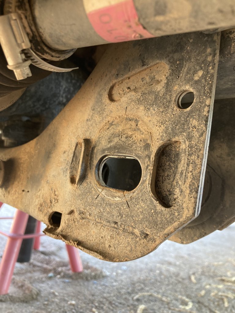

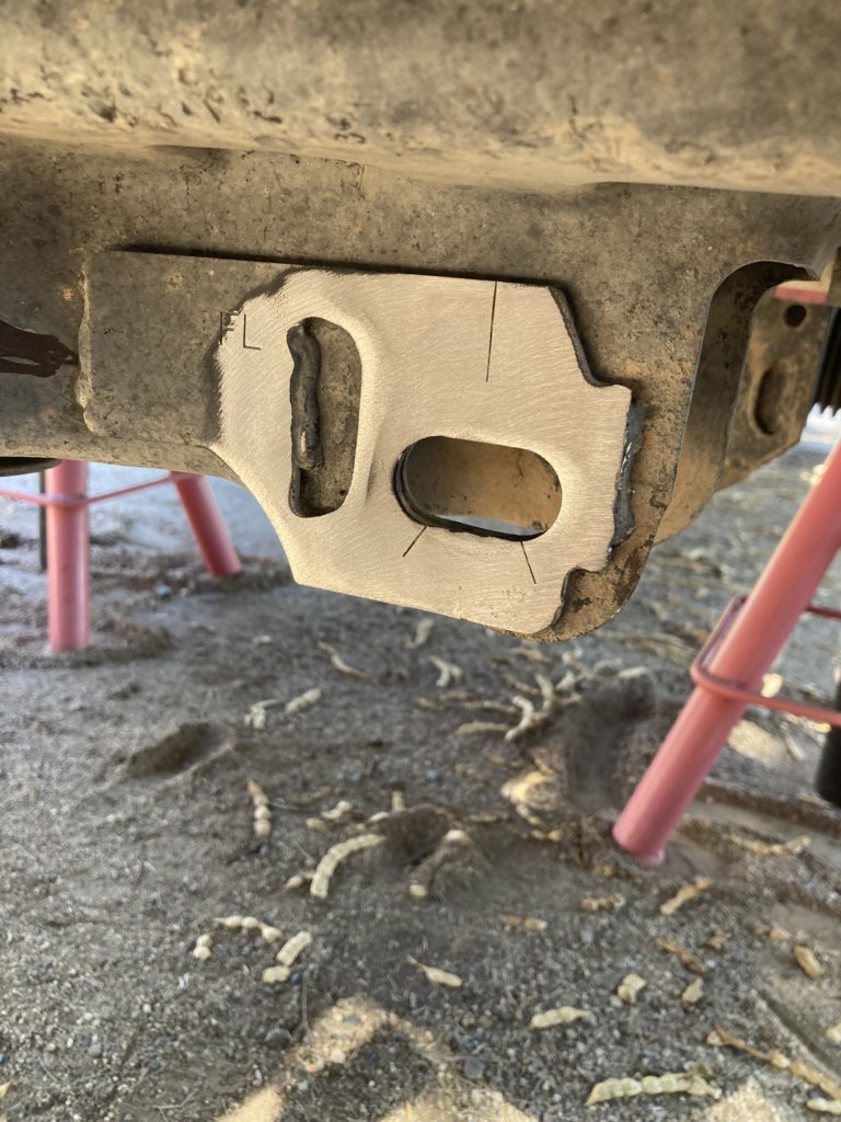

    Put away tools for the day. At first I was not impressed with the Diablo blades I had, burned thru 4 of them without even making it thru one cam bolt(front driver was seized)
    Went to the hardware store and got 50$ worth of other ones along with some temp nuts for my cam bolts. Maybe the carbide ones are better?
    Got the arms out and started flattening the cam tabs with a grinder. The instructions say to remove entire cam tab plate……… but on the rears it’s part of the frame, so I opted to just grind down the tabs; we will see if that bites me in the ass later. Everything is pretty much ready for welding except the back rears because the rack is blocking my grinder getting in there to take the tabs down.
    IMG_7016.jpgGetting help pulling the skid
    front of the rear cam tab plate, see how it blends in with the rest of the frame further down in one pieceIMG_7019.jpg blue tooth LCAIMG_7020.jpg IMG_7021.jpgone for the hand manIMG_7023.jpgback of rear, same sandwich design with the cam tabs that integrate further into the frame with no breaks.
    i should have arms mounted by tomorrow but no where near done

    I've seen the cam tabs both removed and ground flat. I like the idea of having the extra thiccness to clamp against.
    nice work!:thumbsup:

    Hahah I never used them before or bought them, so I guess I didn’t get the good Ones the first time, the one that did cut thru is still probably good for 6 more cam bolts!!!
    yeah I didn’t want to cut into the inter grated cross member trying to remove two stupid tabs, and I agree with the more material sentiment. And for the most part it just makes things easier on my end with labor.

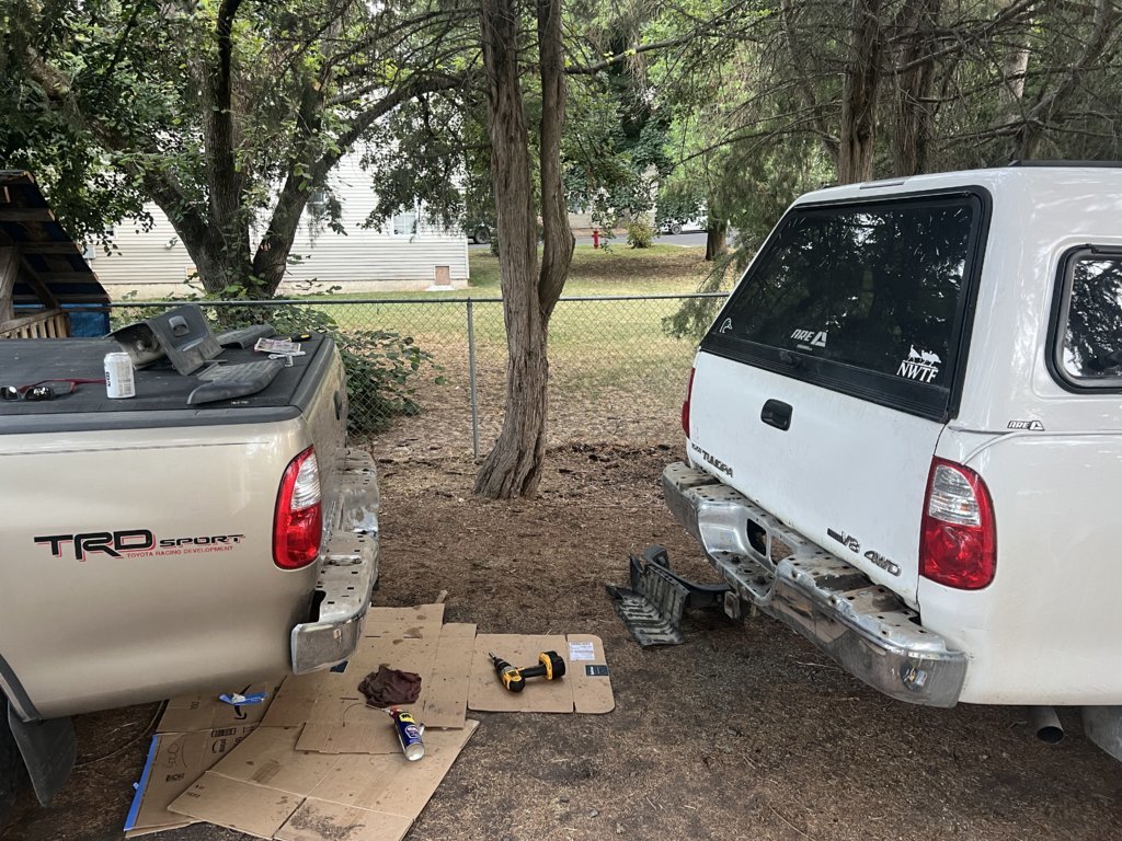

    IMG_3608.jpg Swapping the bumpers and plastics over because the bumper on the white truck has a slight bulge on top that the plastic won’t sit flat on. I’m really going to miss this gold one when I finally sell it. No rust anywhere. Bolts are still chrome 20 years later

    My plastic cover is raised up, too. It annoyed me more at first, but I've gotten used to it, more or less. Or other things are more concerning for now.

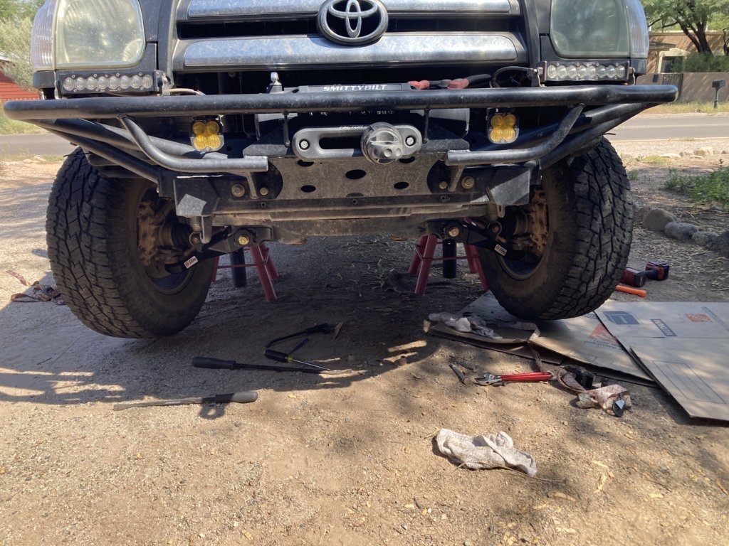

    IMG_7032.jpg IMG_7033.jpgKachow!!! Solo Arms are 90% done, got toe as close as I could with my peepers. Tomorrow I just gotta tighten up the cam bolts and I’m done!
