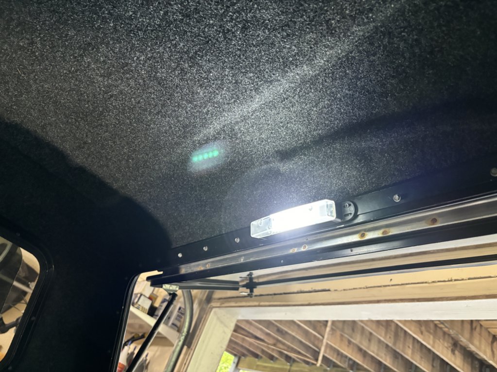

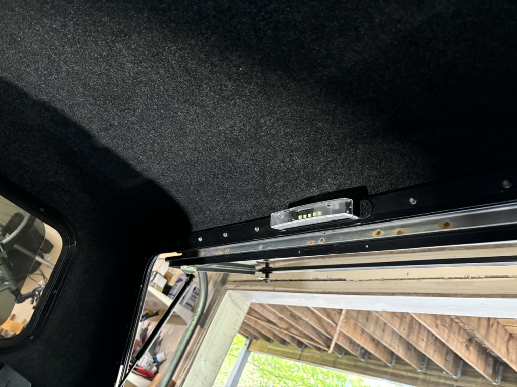

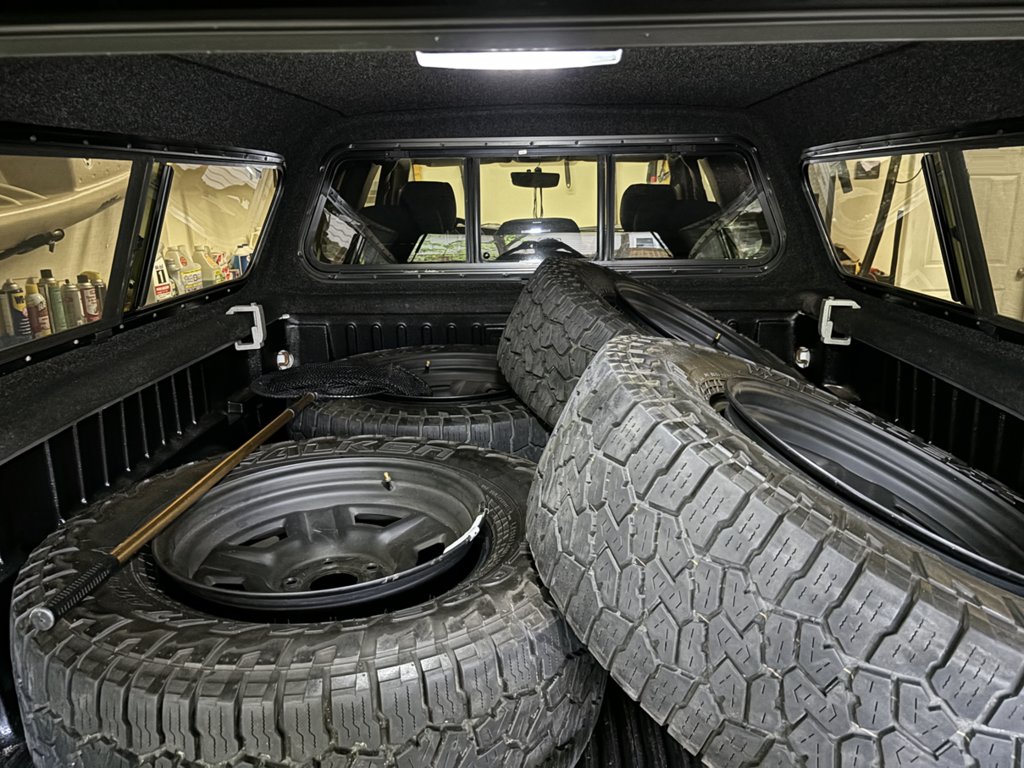

    Decided to go a different route for the shell light. These 5-chip LED lights are all over scAmazon and you can either get them in wired or battery. Battery takes (3) AAA batts.
    I mounted to the rear door frame where the original one was. I marked the width between the sheet metal screws on that frame and opened two holes in the base with a step bit so it'd sit flush, right over the top of those sheet metal screws. Then mounted with some stubby flathead screws I had.
    Overall, generally happy with the light output. My phone camera did long exposure so it looks twice as bright as it actually is, and it sucks using a rocker, but I can still find a way to rig this up to a piston-mounted switch using a piece of wire. Meanwhile, it's mounted with the 3-way rocker switch on top, so it's easy to access the battery door on the bottom for battery replacement.

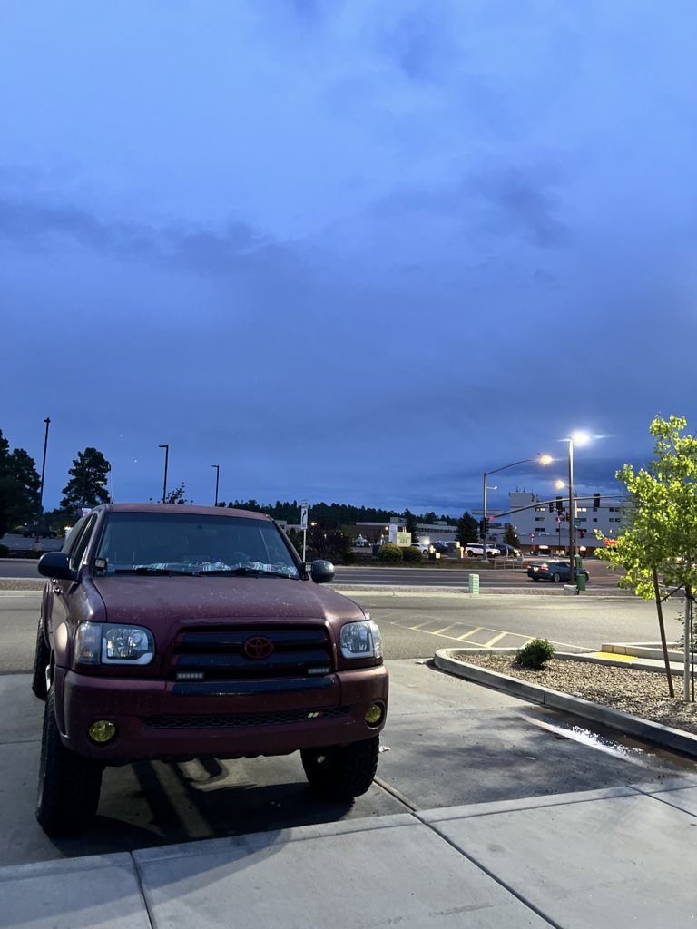

    Took the wife to our cabin for her birthday. Got to test out the Toyo AT3s off road and I’m pretty impressed. They’re quiet on the pavement and gripped really well off road. IMG_0206.jpg IMG_0196.jpg

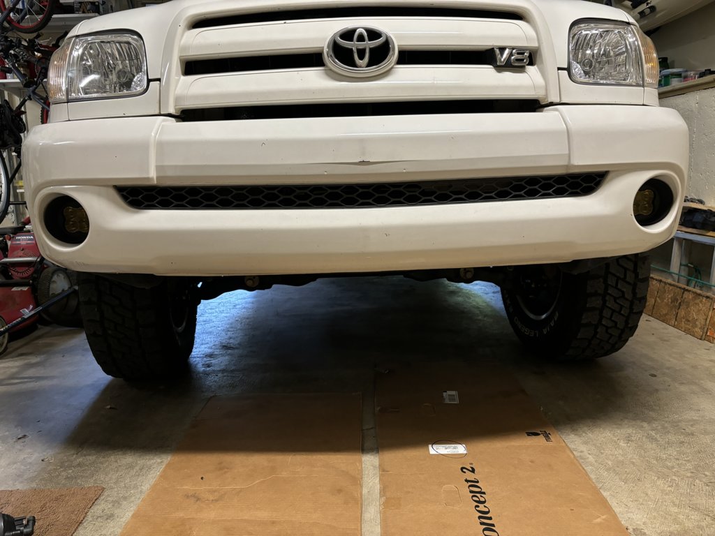

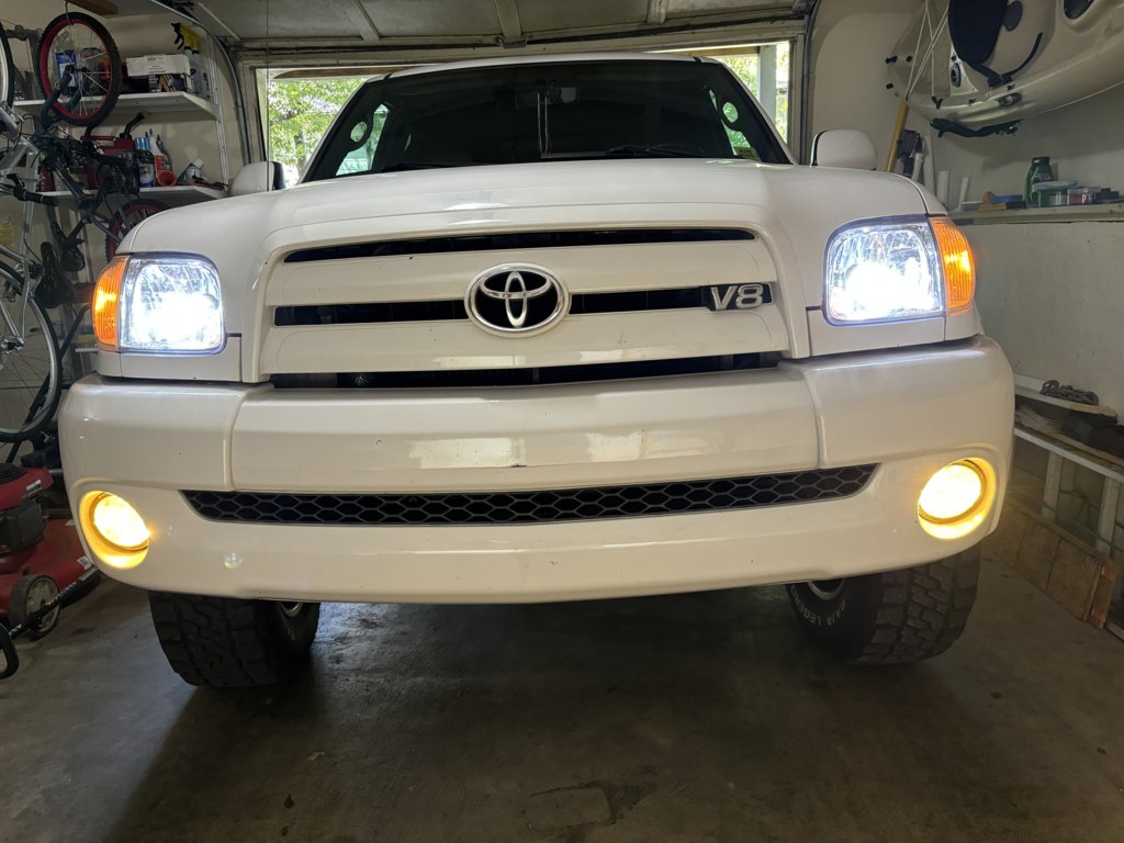

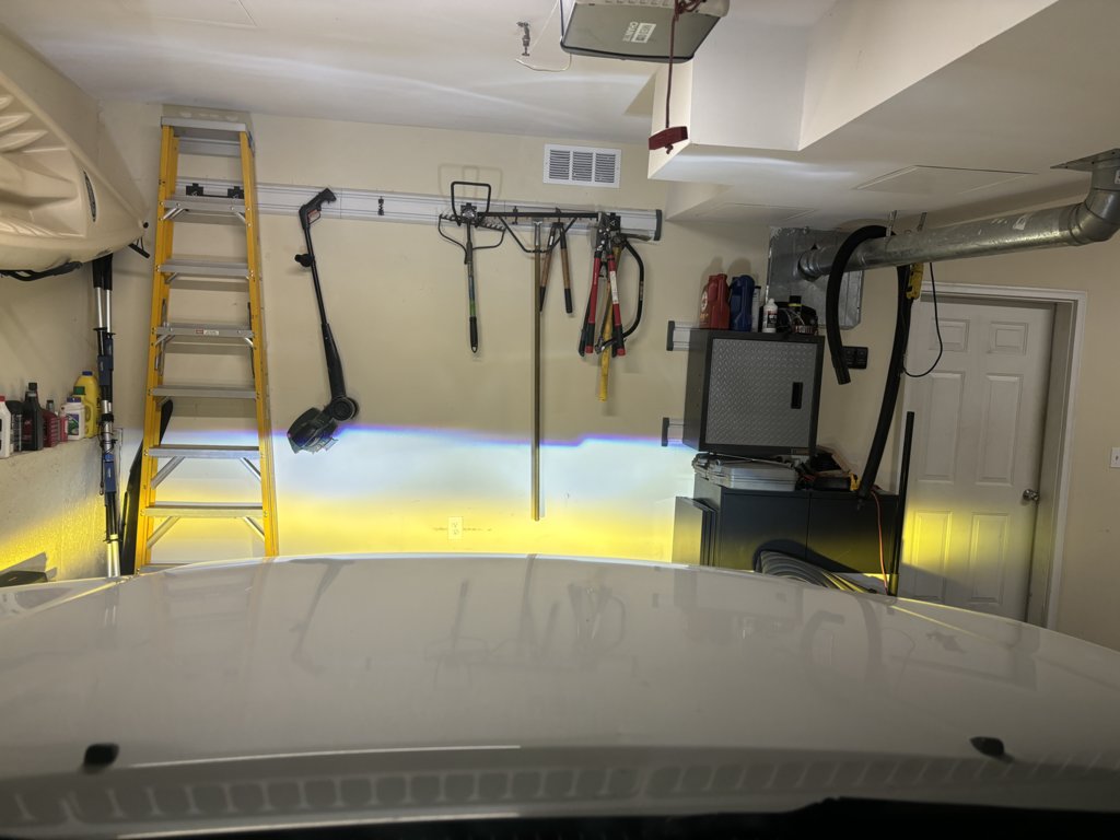

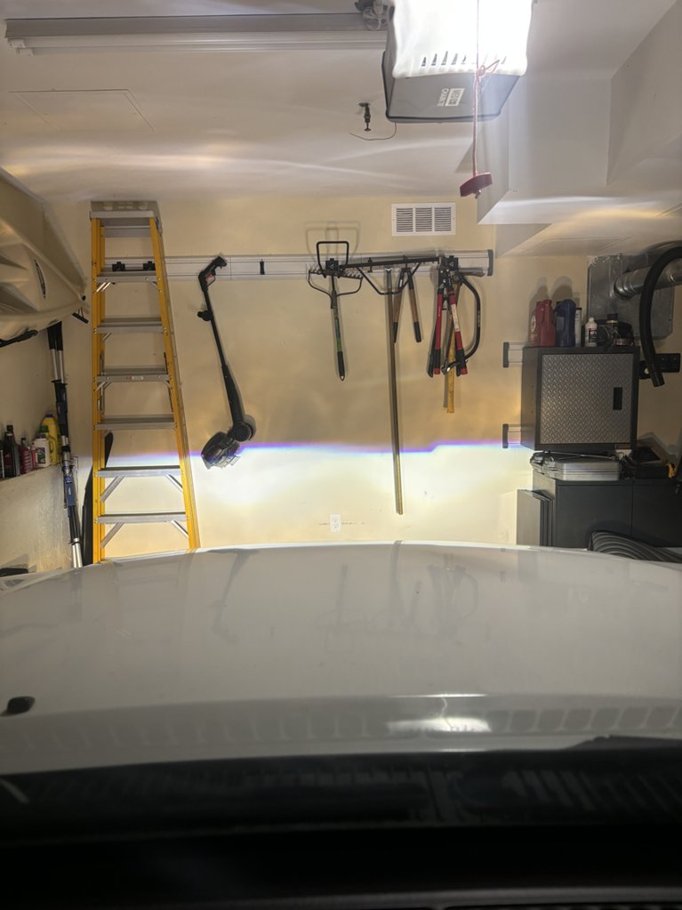

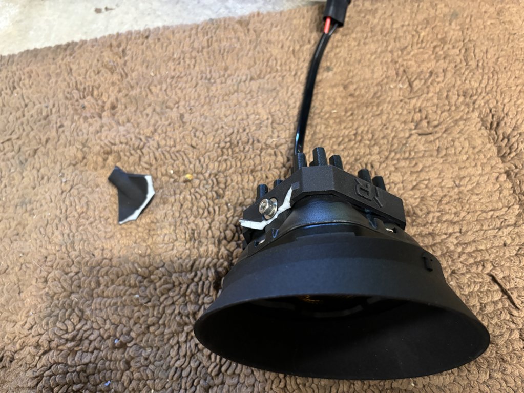

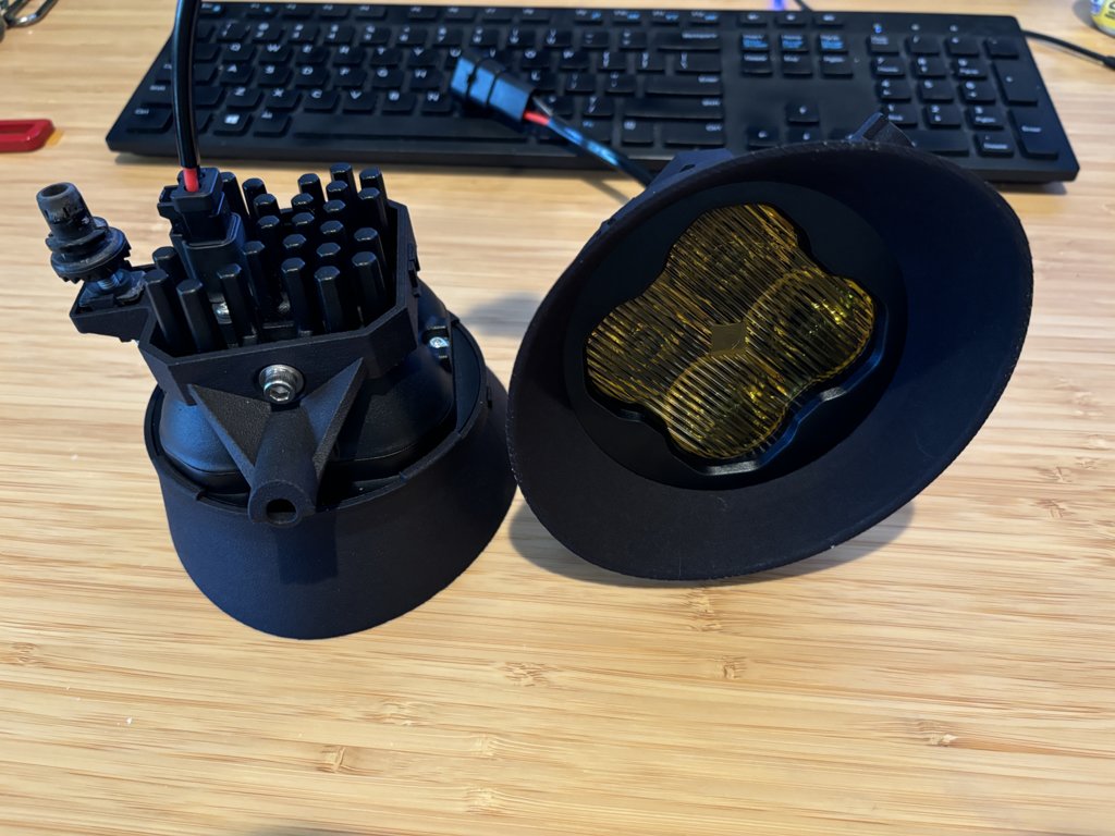

    And on other topics, I had an interesting experience with the Foxbeam SS3 kit. I got the driver's side in with no issues. They slide right in if you line up the adjuster screw first on insertion, then pop in the stationary arm closest to the radiator in, then once the adjuster screw housing fully in, insert the outer pivot point. Worked great for driver's side. Not sure if my product took a hit in shipping or what, but when I popped in the passenger side, the whole f'n arm snapped off! I emailed them to see how they want to handle. I was already 3/4 done, so I'm just rocking it and hoping it'll hold with the adjuster screw and stationary pivot arm installed. More pics below this fail pic...
    Anyway, light output is great. Super wide beam, would nicely cover a ditch. Fitment is a little loose around the bumper skin pocket, which is undoubtedly necessary to allow for fine-tuning of position. It was very easy to center them, and they generally look (IMHO) great.
    Output is markedly better with the DD SS3 pods than whatever these aftermarkets are that I bought. But y'all can decide on that.

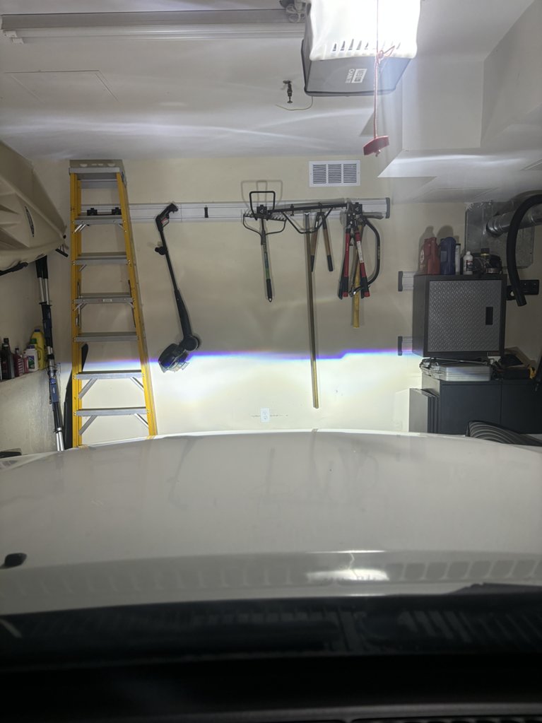

    Before, no fogs
    Before, with halogen fogs
    After, with Foxbeam + DD SS3 fogs, I had to shoot wide because the light went waaaay wider. I haven't adjusted fully yet because I can't, given the passenger side housing broke.

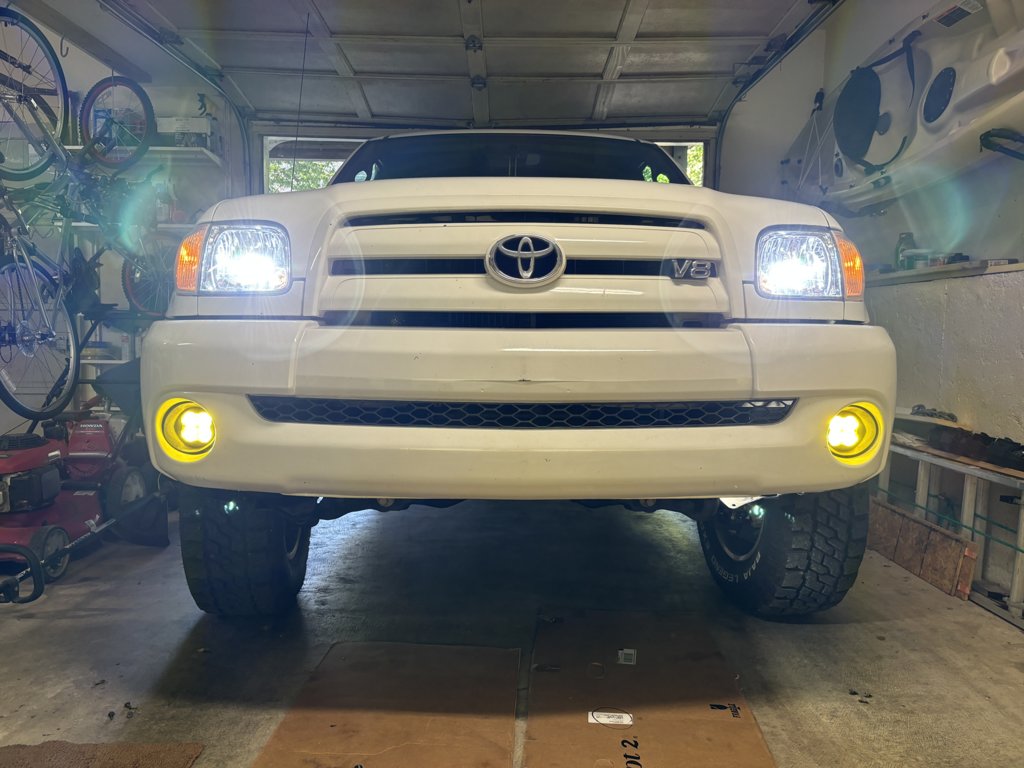

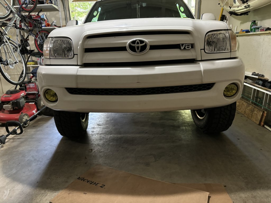

    And for some front shots, before/during after:

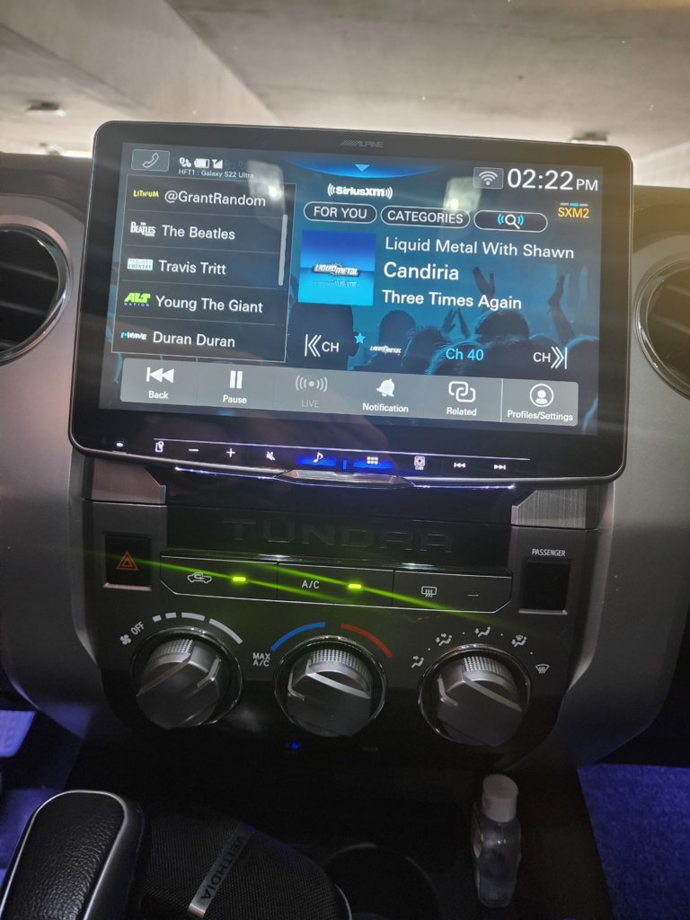

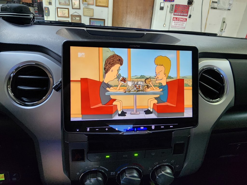

    Here is the 11" in my 2.5 Gen. I think it would probably block the vents in a 1st Gen.

    That would cover the vents, half the dash, and a small child's head.

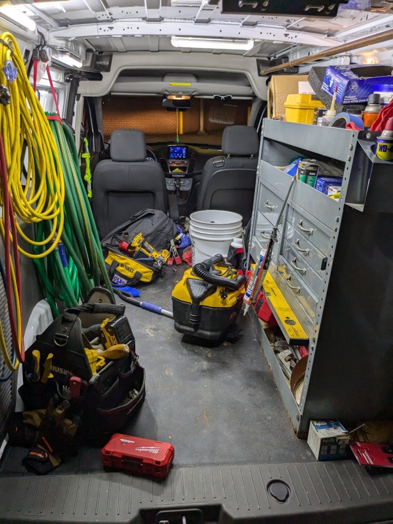

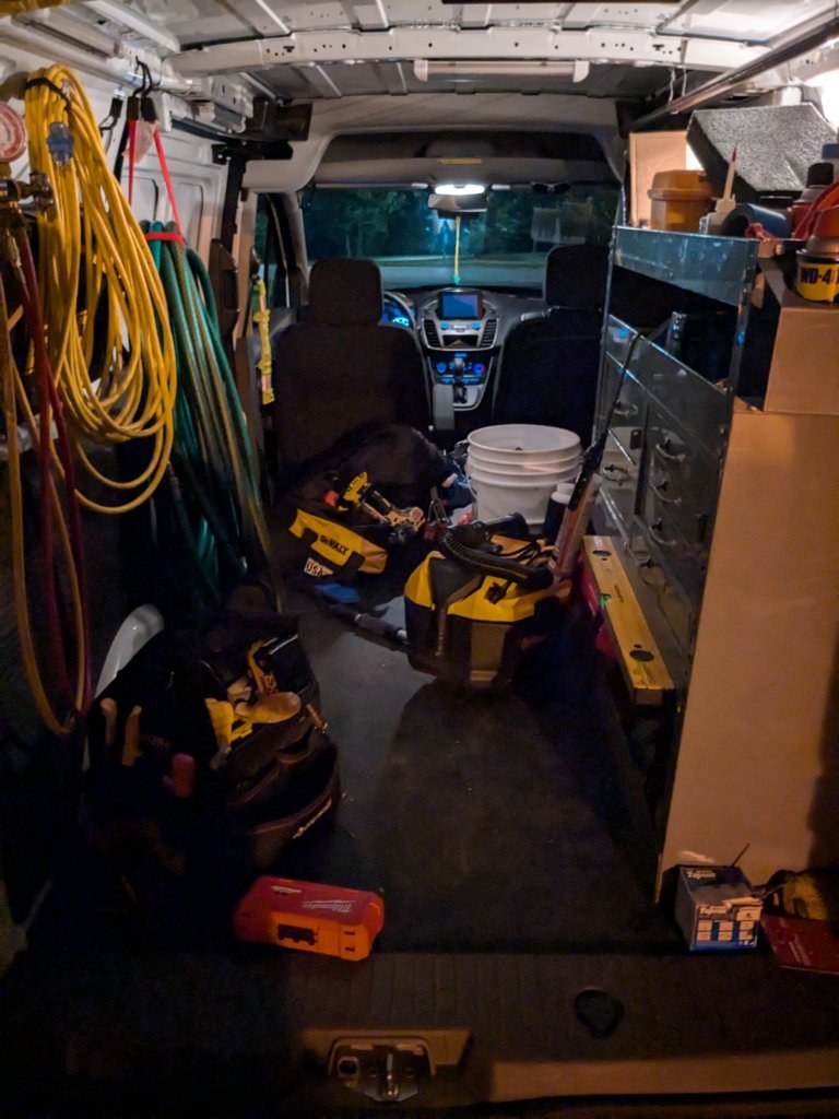

    If you decide you need more light I just installed these in the work van. Because Ford decided on incandescent cargo light was enough in the Transit Connect.
    https://www.amazon.com/RVZONE-Interior-108LEDs-Trailer-Motorhome/dp/B09QYBZRJQ
    Went from this
    To this
