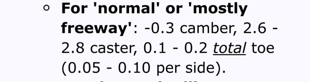

    I don't, but it varies from chassis to chassis and amount of lift.
    The closer you can get to those numbers the better. But if lift and components prevent you from getting all the way there, it is what it is.
    Looks good enough. I prefer a bit more negative camber if there are curvy roads or freeway on/off ramps that are curved.
    I was getting excessive outside edge tire wear at -0.3 camber but I also corner a bit harder than most so ymmv.

    I'd be cool with what you have numberwise.
    Top nut on the SPC UBJ takes 150 ftlb of torque per the instructions. I think the lower is 45, but is held in with cotter, so shouldn't be going anywhere.
    For the rest, the LBJ bolts you listed and everything else, see here: https://www.tundras.com/threads/wha...-gen-tundra-today.2558/page-2122#post-3682230
    There was a typo in the FSM. They say 48. I torqued to 59 when I did mine and used blue loctite. I've had no issues yet.

    I was looking at that lbj bolt comparison page and saw the 59# but that spiker says it can go up to 80#. I’m cool with 59, it’s not going anywhere
    shifty`[QUOTED] likes this.

    Extra degree of caster is no problem. When others have used the solo lower arms (1" further forward) they were happy set around 4.5° of caster.
    59 ft lbs is correct, as @shifty` said.

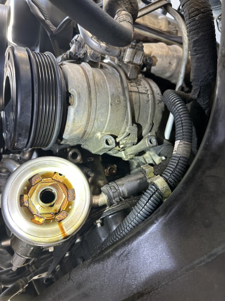

    This weekend I changed out the figure eight gasket on oil cooler plus pressure sensor and middle gasket for peace of mind both were pretty flat. I also added some tracks to my camper shell, pretty productive weekend. ​

    is this a common fail point ( im new to tundras)
